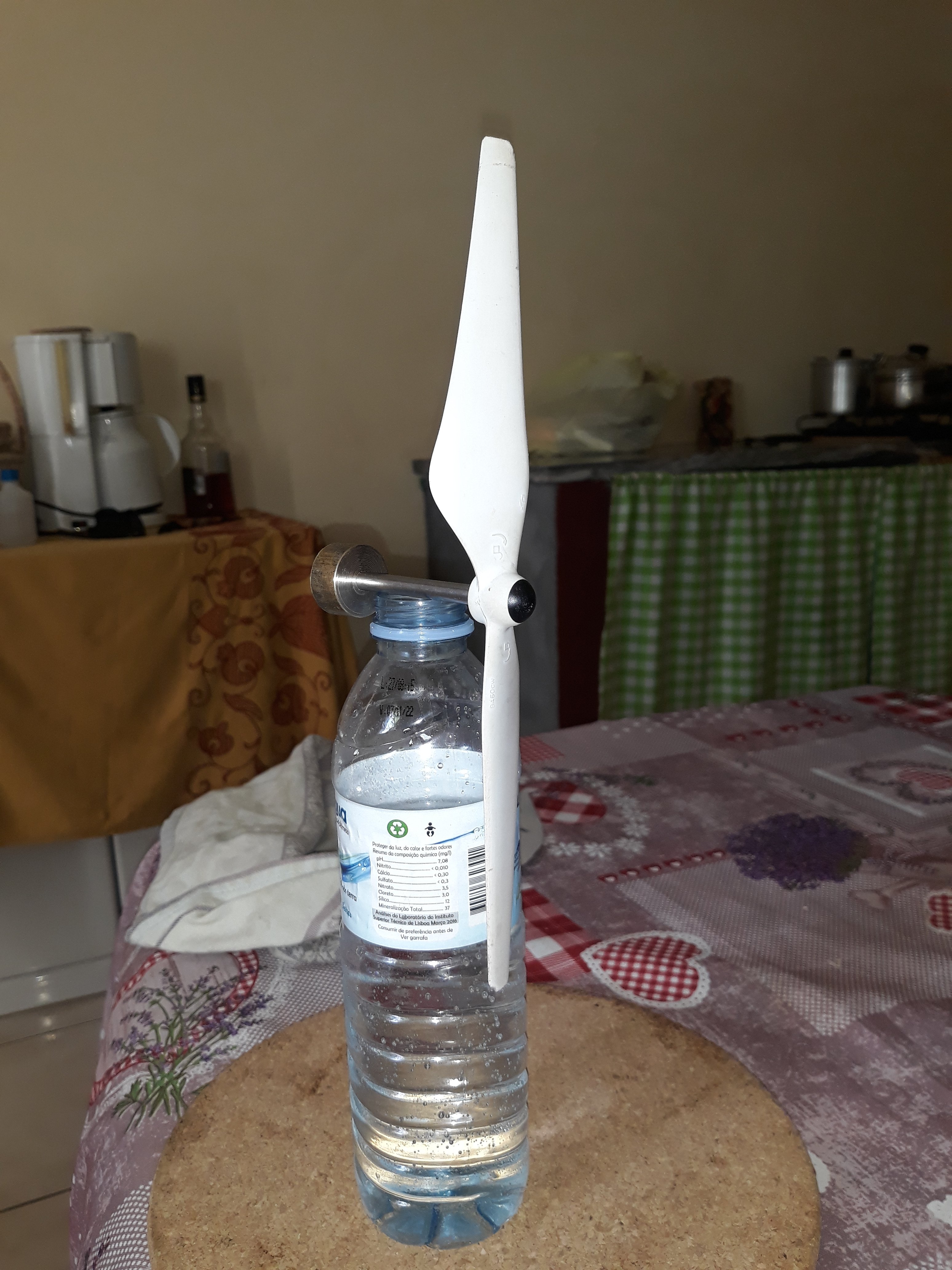

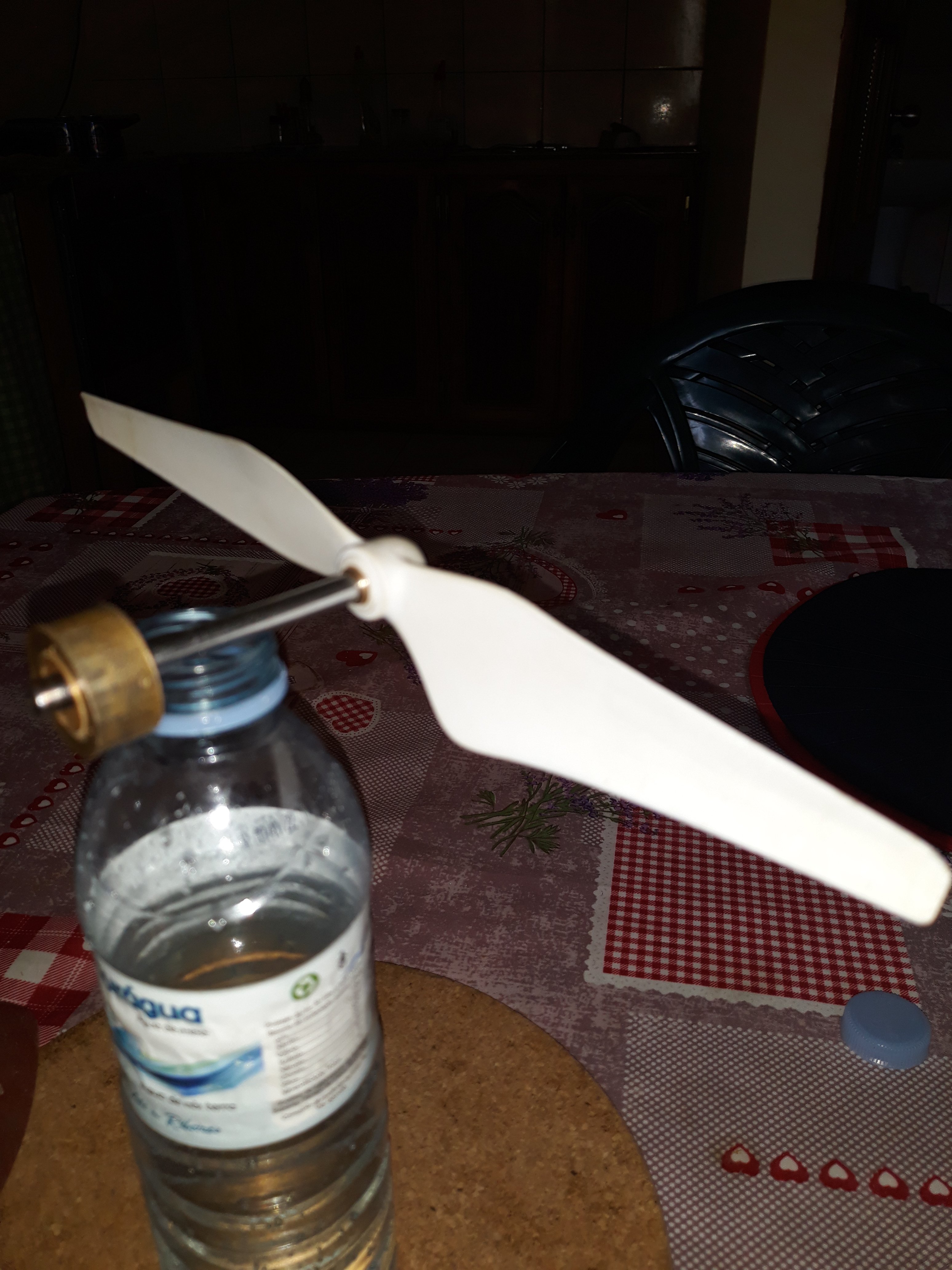

Now I found out a prop balancer, I want to check every prop before installation. Easy job and works great. Cost, low budget. I have a lathe its helps my left hand.
