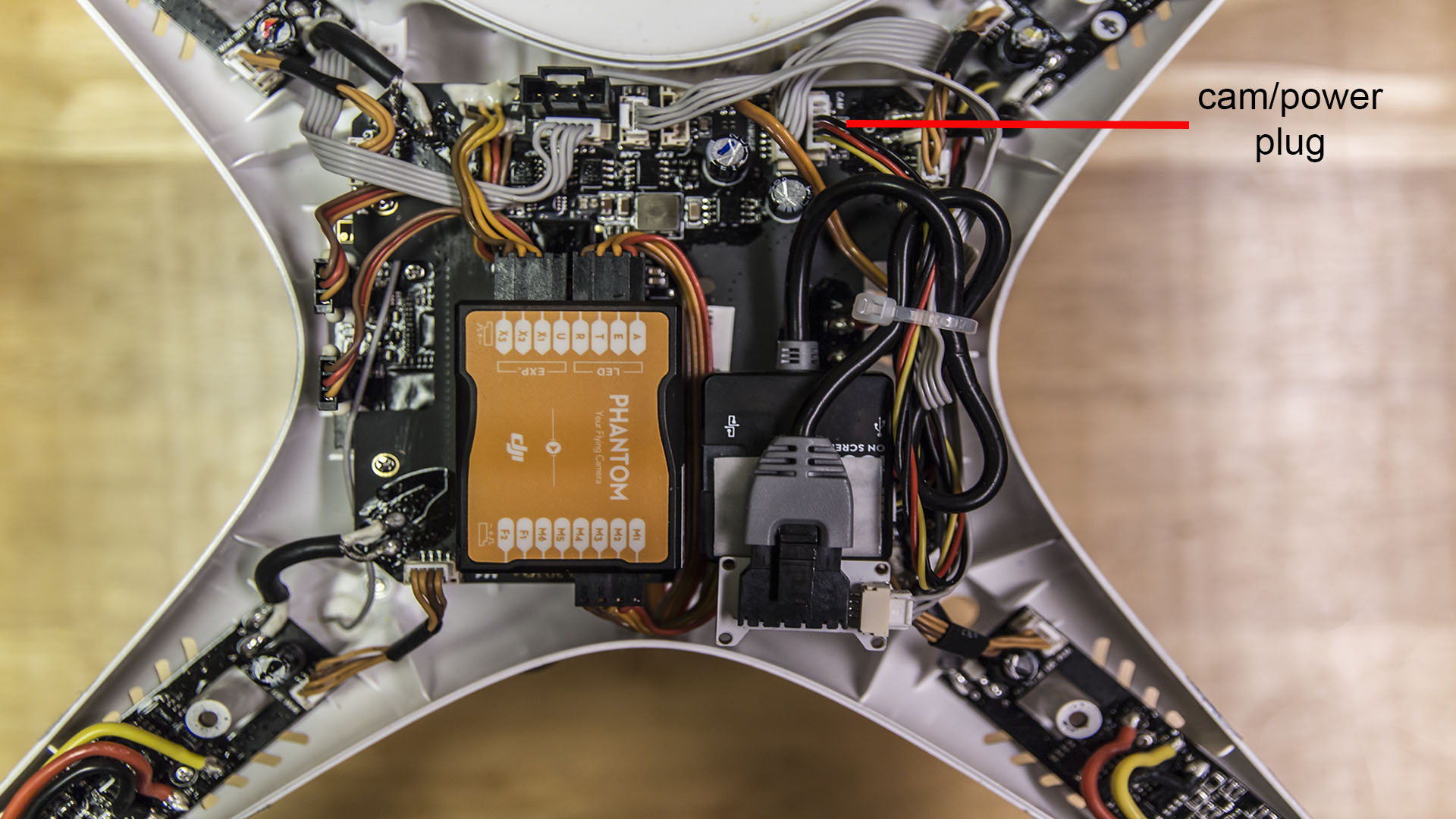

It's time to open the shell and look for a cold solder connection in the power supply. The battery will not shut itself off even when it lost power to the motors. There is a possibility that you may have an intermittent Naza module.

Yes it could be either one. If you'd take the time open up the shell an look for cold (loose) solder connection on the battery B+ wires. If you cannot find a cold connection then item would be the Naza module which has a orange label with Phantom printed on it as in this photo. The Naza module controls all the motors
