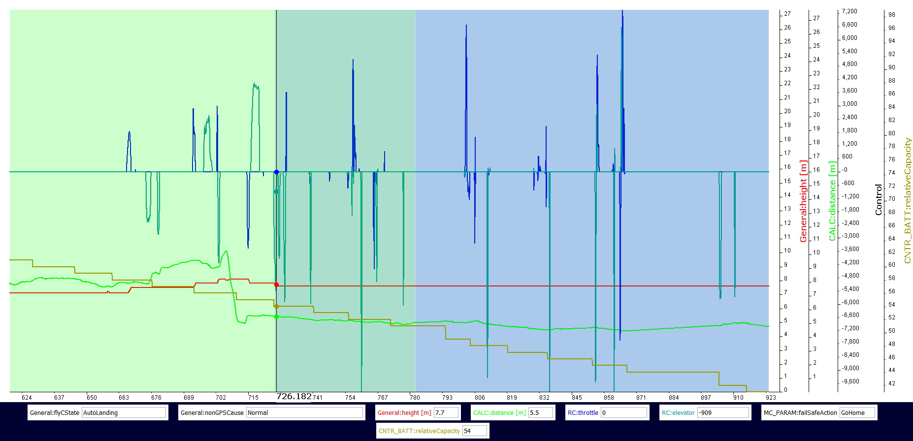

Would appreciate some experienced assistance. In the middle of a roof inspection (still photos only) my P4P indicated a compass error (I think) then attempted to land. As it was not safe to do so, the drone just hovered in place. I tried to cancel the landing but the response from the app was a " request time out". I tried to return to home; nothing. I restarted DJO Go4; nothing. I restarted the remote; nothing. I restarted my iPhone 7; nothing. In short I had no control of the drone but still had return vision and control of the gimbal. I could tilt up and down and see live vision, just not motor / servo control. Eventually the battery went flat, the drone tried to land on the sloping roof, and obviously tumbled to the gutter.
I'm wondering if anyone else has experienced the same. I have done at least 100 jobs like this in the past 9 months without issue. Flight records attached for anyone who can understand them.
Any clues to the issue would be appreciated...
