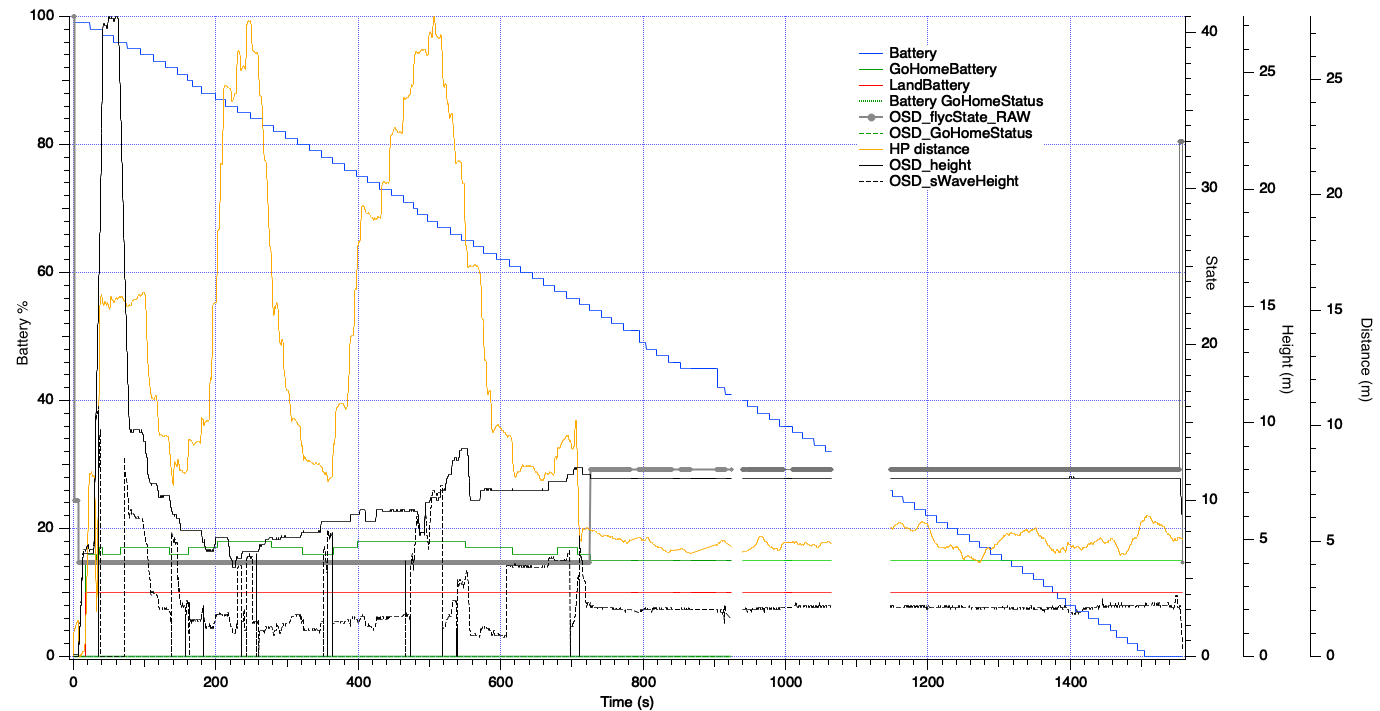

Apologies for being a bit late to the discussion. This was an unusual case, in that what happened appears to be a loss of uplink data to the FC at around 720 seconds. As a result, at 725 seconds, the FC initiated RTH (OutOfControlGoHome) which immediately converted to autolanding because the aircraft was too close to the home point. The landing point was unsuitable and so the FC switched to "hover". The downlink was mostly continuous, with just a few gaps, but there was no further uplink to the FC, hence the "command timeout" messages from the RC, and the aircraft eventually went to forced landing due to low battery.
I've not seen such a case of uplink loss - especially where the downlink was good.

I saw it once just like this, as documented in the thread I linked to above. Don’t recall if you were on that thread at the time. It definitely seems like a pathological case. I would lean toward the A/C going deaf rather than the RC not sending. Because restart of the RC (and GO4) didn’t help.

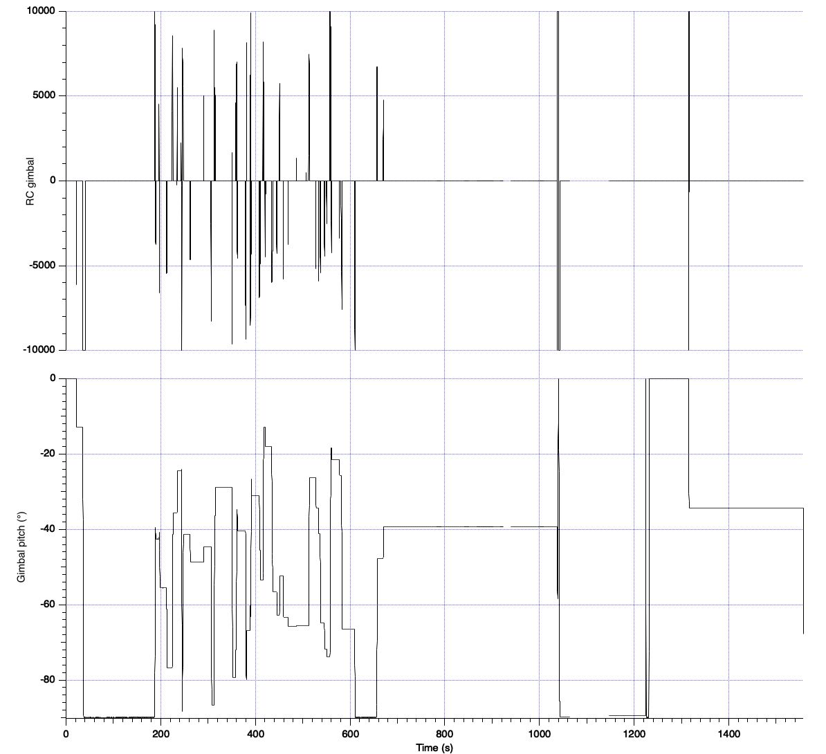

One point though, it was not a complete loss of uplink as I could still control the gimbal (i.e. tilt).
ALSO, (something I have not mentioned previously) I noticed that when I applied rudder inputs while there was no flight reaction / change the gimbal did move slightly in the same direction. I assume this is part of the mixing process to absorb the movement of the camera? Mind you this happens while the drone is sitting on the ground without the motors even started... To me this means the ac was receiving stick inputs, of sorts.

That's why I referred specifically to the FC uplink. The gimbal was responding, at least at some times:
Sorry, I did not realise there were multiple control links. Thanks for clarifying.
