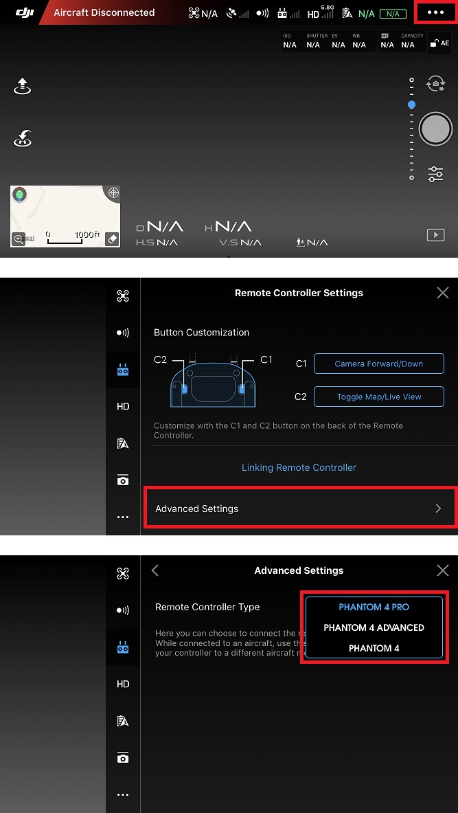

I've never tried using my P4P GL300F RC with my P4 craft. I always assumed it wasn't compatible since P4 doesn't support 5.8Ghz. Have you tried that, and it worked OK? Does link OK, then the app simply detects a P4 and not show 5.8Ghz?
You'll be able to connect it after configuring this setting in DJI GO:
