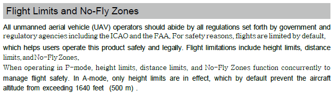

Ok so @George Race has posted a preliminary copy of the P4 manual a few times in the last hour or so, here is the link to one thread:
Phantom 4 operators manual
After a quick skim I see that it says that the P4 will have an option to enable Dynamic RTH like the Inspire 1 has, also the NFZ's restrictions do not apply when flying in Attitude mode.

It seems too good to be true.
Too good to be true? I think it's true with P3P. With ATTI there's no GPS, so how does it know it's in a NFZ? Recently when the craft wouldn't let me take off within 2mi of an airport, I switched to ATTI and took off anyway to get a photo of a friends cabin from 50ft high. I think ATTI works anywhere doesn't it?

GPS is still available/usable while in ATTI mode. However, the Phantom doesn't use it to hold its position.

Hmm, If that's the case I wonder why my P3P allowed me to fly in a NFZ in ATTI after refusing to let me start the motors in P mode. What about if I turned off GPS on the iPad (which I didn't do when I flew in a NFZ recently)? I'll have to test this again more extensively, such as taking off in ATTI, switching to P after take-off, etc.

In ATTI mode you still have GPS lock. That's why RTH still works. This is of course if the Phantom is able to acquire satellites.
All P-GPS does is hold position when stopped. Other than that it's the exact same as ATTI (except for the DJi speed limits and the new info mentioned here). When moving in P-GPS GPS isn't controlling your position as the Phantom will drift during movement even in P-GPS mode.

So if GPS is active in ATTI mode, shouldn't it prevent you from starting motors in a NFZ? My bird flies in NFZ's using ATTI, when at the same place it won't let me start the motors in P mode. Don't all P3P and P3A's operate this same way? Isn't it possible GPS is enabled when RTH is triggered?

I dunno it depends on what DJi does but GPS lock is active in ATTI. If DJi wanted to they could restrict NFZ flights while in ATTI if they aren't already doing it.
