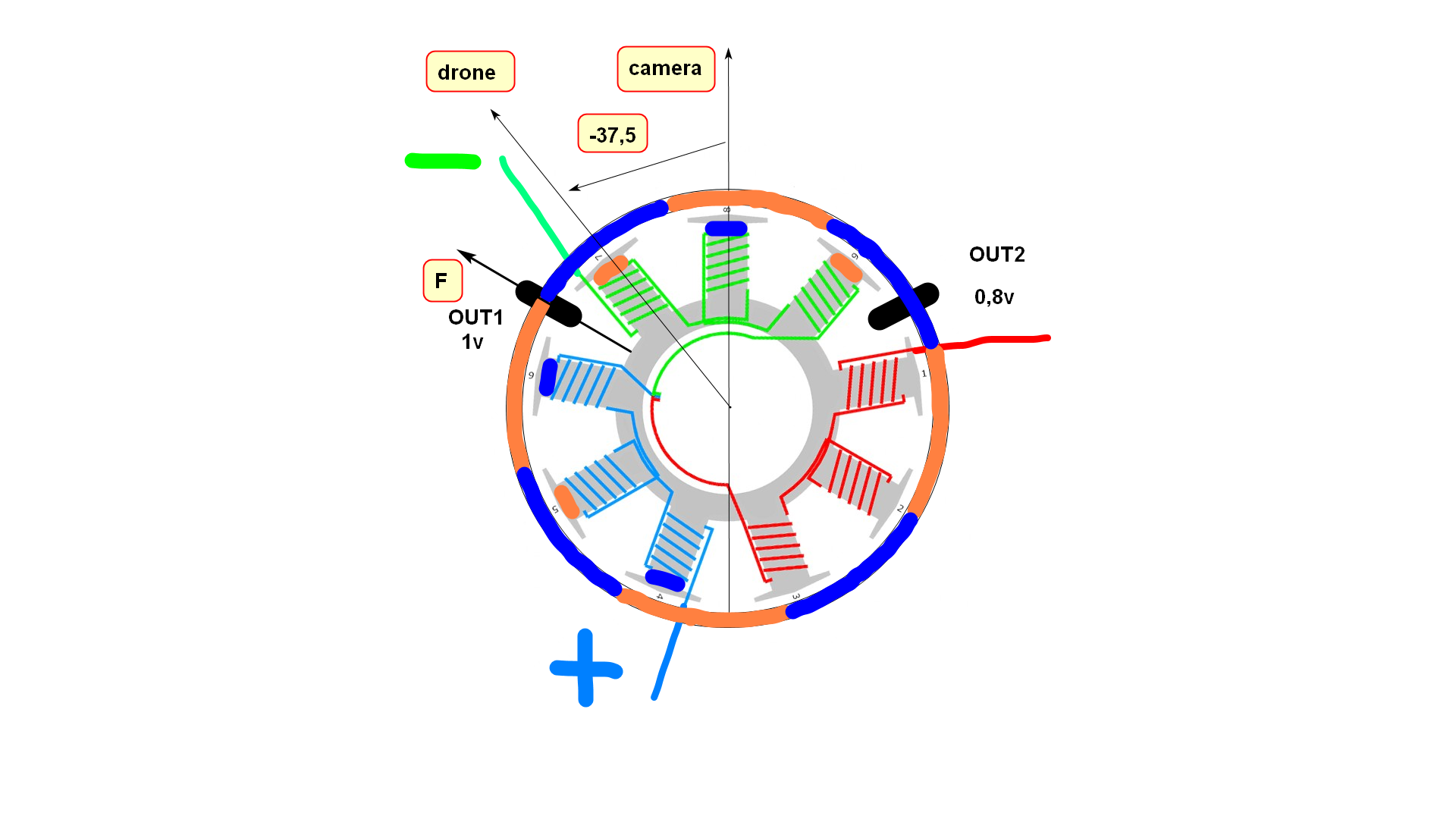

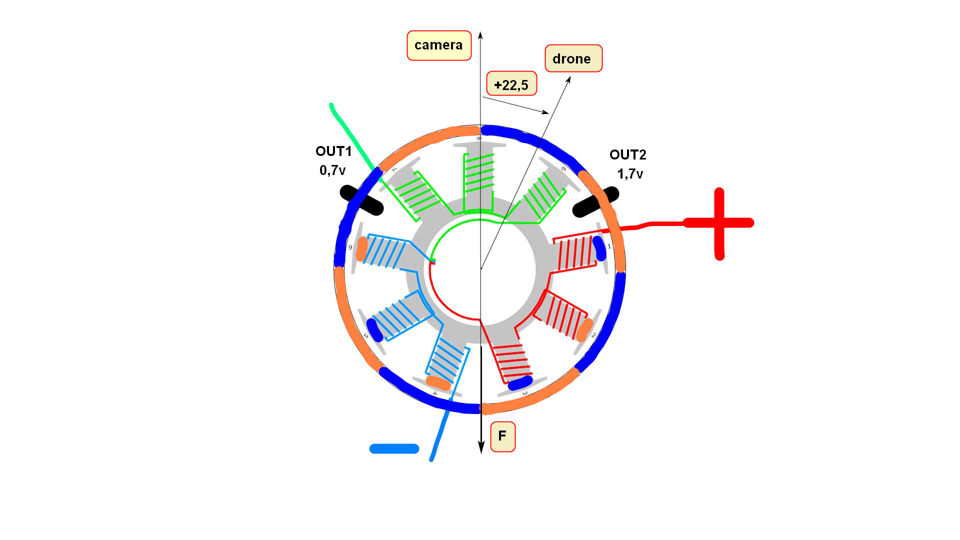

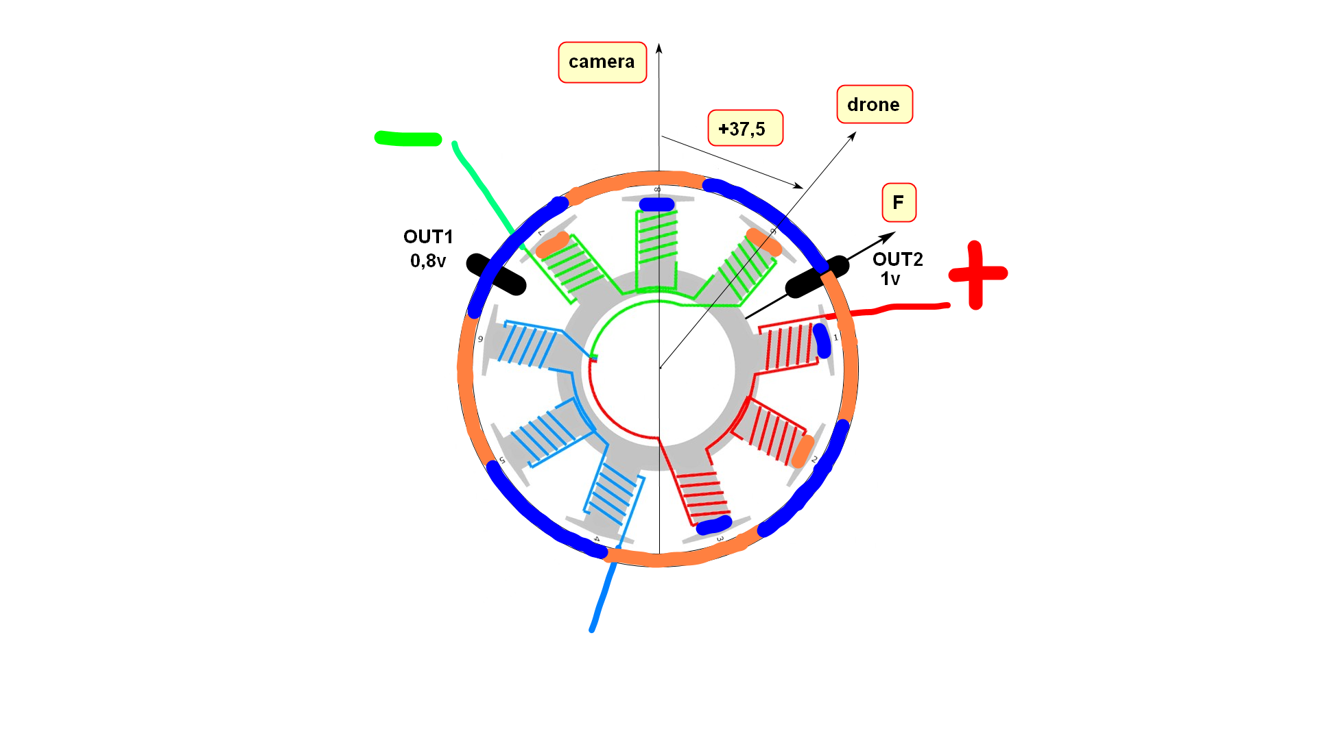

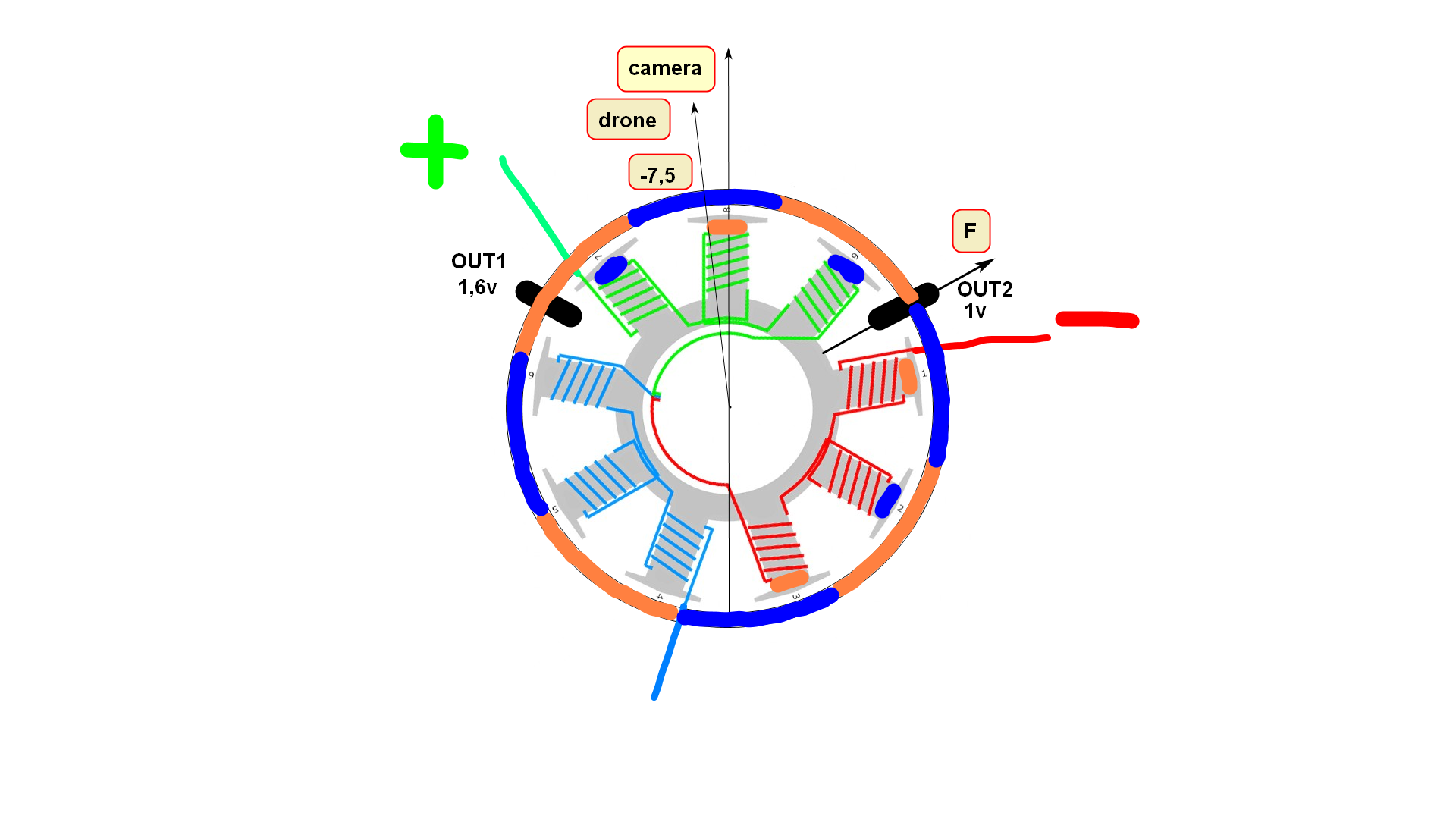

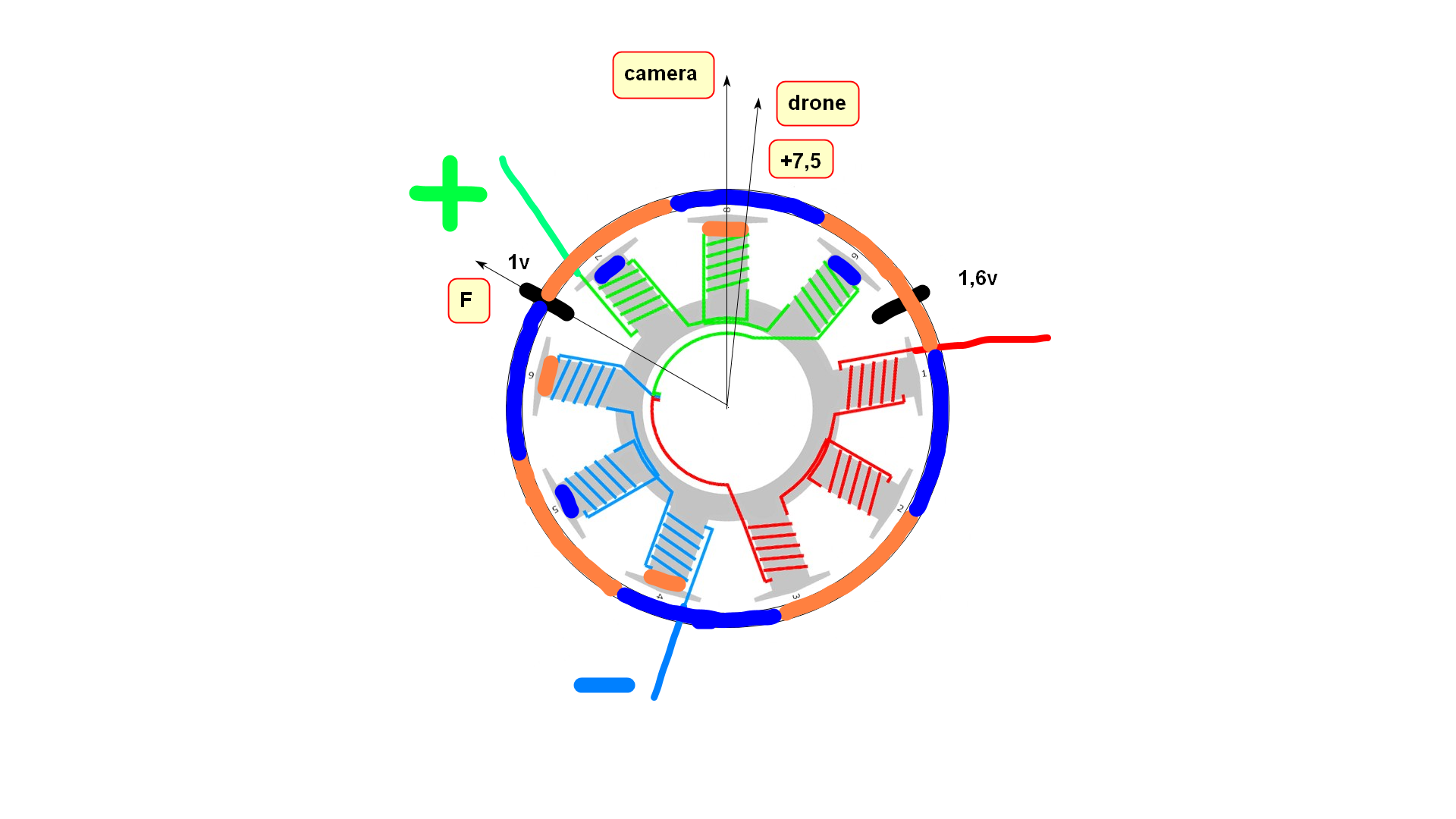

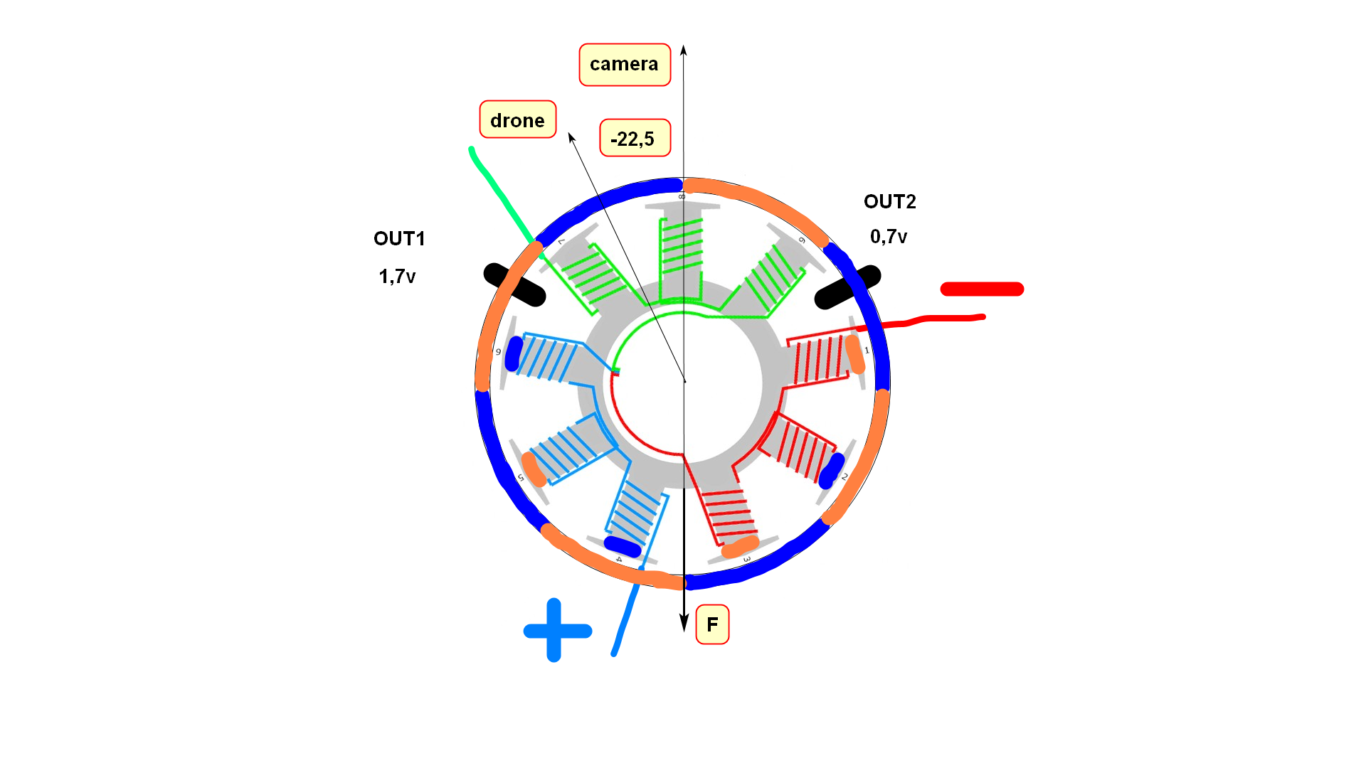

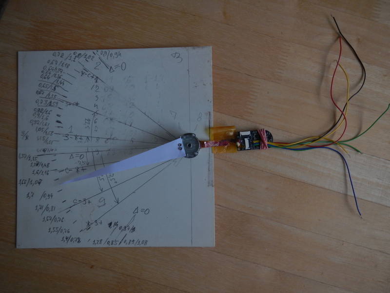

There are six options for supplying voltage to the motor. The current will flow through the 6 teeth of the windings. They will stand symmetrically opposite 6 magnets. The center of forces is marked with the letter F. The mounting angle is easily calculated. In the sector we need, there will be 6 camera positions. I connected the hall sensors to a multimeter and recorded the output signals for each of these positions. The diagram shows the "correct" voltages. On a real magnet it may be different. For example, a Hall sensor between two magnets should output exactly 1 volt. If this is not the case, either the magnet is defective or the sensor is misaligned from the ideal position. This turned out to be with me, after soldering the sensor, the situation was corrected. The last photo is magnetic powder sprinkled on paper, under which the magnetic system.

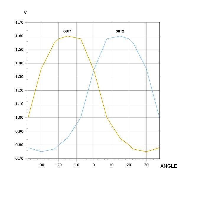

For visualization, I made a graph of signals from sensors depending on the angle of the yaw motor. This graph repeats every 45 degrees (we have 8 magnets). If the camera deviates more than 37.5 degrees, it will jump to another sector and the camera will look at the drone's support. I limited the deflection angle to 30 degrees. I just glued thin elastic bands like stops. Drone calibration accepted it!

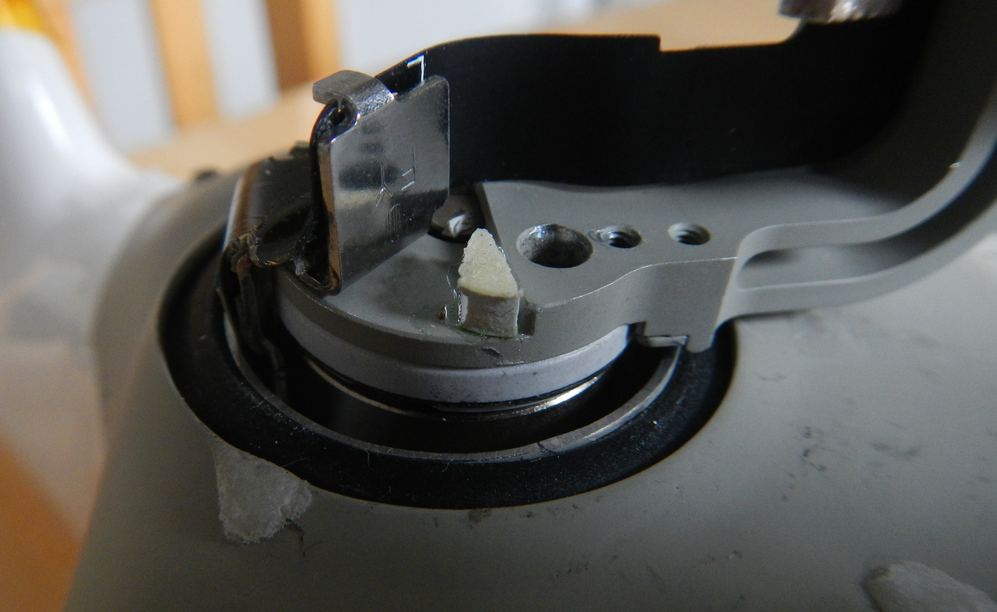

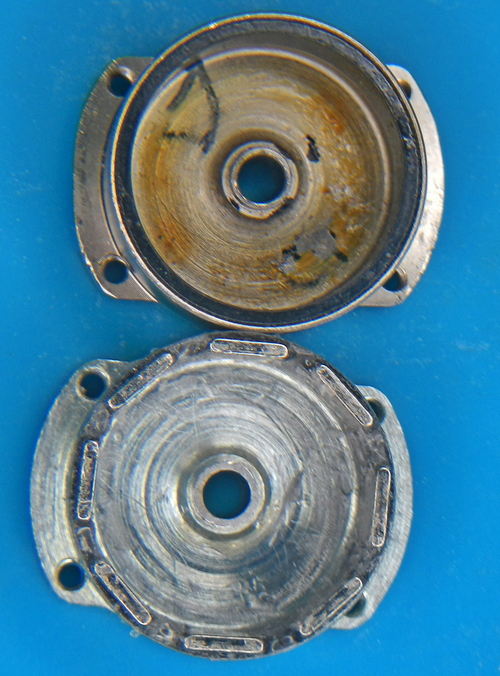

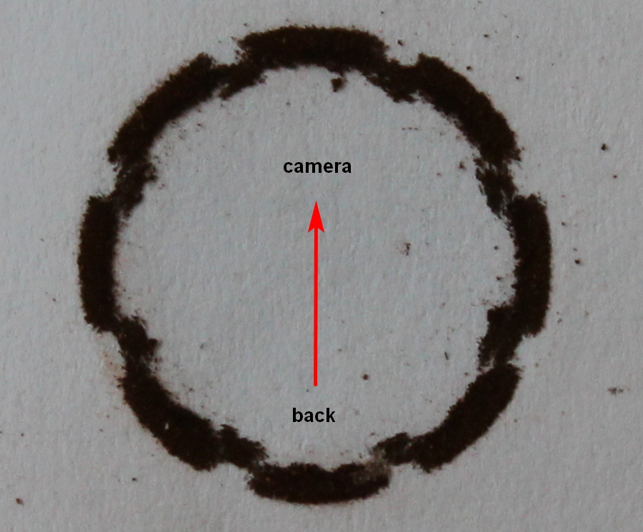

The extreme positions of the camera do not always coincide with the extreme positions of the magnetic system of the motor. This is one reason why the camera suddenly looks at the drone's cradle and the controller reports gimbal motor overload. Turn the camera left and right (do not turn on the drone!) The drone legs should not be in the camera's field of view. In the photo there are limiters that are easy to stick on. Also a photo of how to build a stand for testing Hall sensors and checking the motor (if you have an 8 volt brushless motor speed controller, you can see how the motor works)

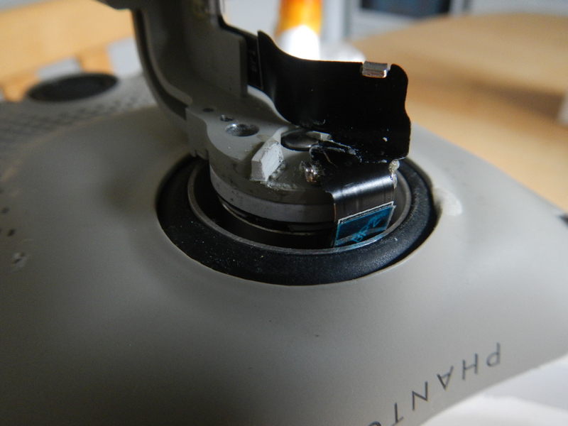

The image shows one of the problems. There are worse than that.
Thank you.
Try the legs up calibration. If that doesn’t work your going to unfortunately start swapping yaw motor hubs until you get the right one. Definitely put the original ESC board back in because the roll motor as well as the yaw motor are paired to it. The pitch motor is paired to the board in the camera

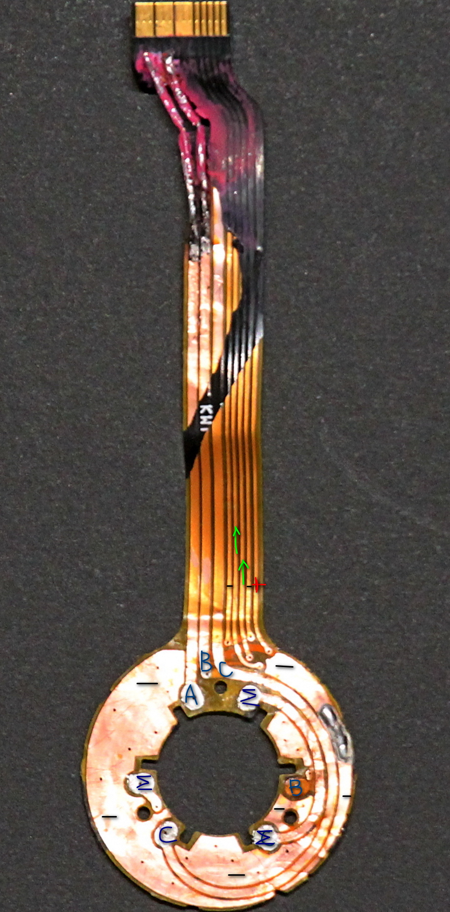

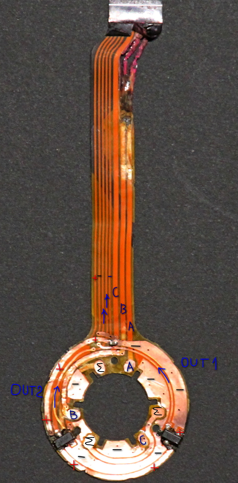

Photo taken after testing. So the wires lead nowhere. A motor test is required if it is suspected that it has burned out or the magnets are damaged. I used a Hobbywing Skywalker 2-6S 80A UBEC Brushless ESC and a servo tester, applied 8 volts. This is not on the photo. Hall sensors are not needed.
I have an extra ESC from a Phantom 4 with a connector for the yaw motor. All wires are soldered there. If you find such a connector in old electronics, use it. It's hard to do this without a microscope.

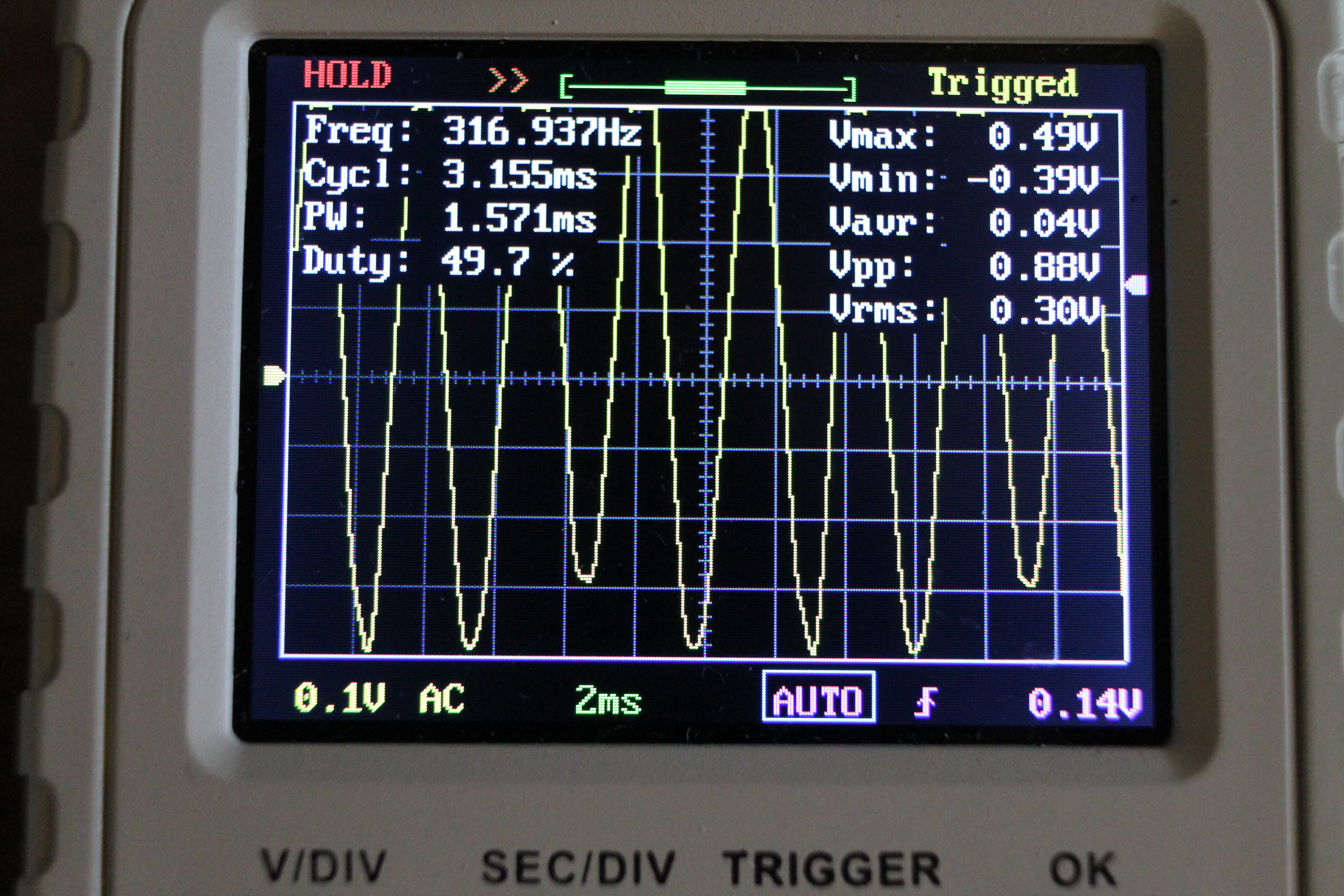

The sensors use 5 wires. Everything is marked in the photo below. To test them, you can apply 3.3 volts (more than 20 volts, according to the datasheet). The sensor has a built-in stabilizer. the output signal is measured by the tester. As a bonus, I am attaching a photo from the oscilloscope - a signal from one sensor when the motor is running. Ideally, all waves are equal on both sensors.
There is a chart in the previous post. This "butterfly" should be symmetrical.
