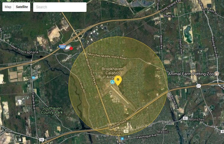

FYI, when planning your flights in the future (if you decide to buy another Phantom), this map will come in handy. It shows no fly zones and authorization zones. For this flight, you can see your location (the red dot on the map below) was next to an authorization zone.

1) I turned on the aircraft and waited for green ok status and saw that the home point was accurate, close enough to where it started and was ok with that
- if you look at the satellite photo it was about 5-10 feet SE of the concrete in the grassy area for launch

3) Why the software thought the UAV was in an Auth Zone when it was in a warning zone, but fairly close to the border of an Auth Zone. Possibly due to the weak GPS signal in the phone itself?

Agreed. However, in this case, it doesn't seem the software caused a problem. Your flight log shows a trail of pilot errors that led up to the disconnection and your Phantom ultimately being lost among the trees.
I did use that map as well as a sectional chart that I was trained to use in class. The software on the screen stated that I was approaching an auth zone when I was well into a warning zone. It was not supposed to lock me out, but it did. I think that this is probably an excessive action in the software to enable the lockout in that position, especially when already in flight.
