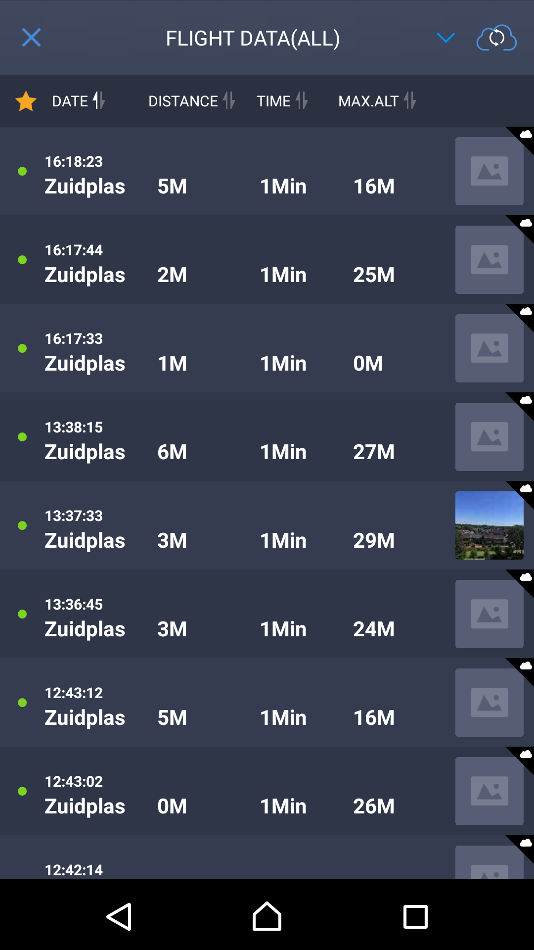

    I recently got my P3S. I was a bit disappointed when i took it out of the box, charged everything up etc. and then took it for a flight. I only got 30 metres of live feed. After that it said "No Signal".
    I am fully able to control the quad, just not able to see the live feed. My Flight data also looks kind of dodgy. I added the Flight data as a screen shot.
    Thanks in advanced!

    It appears you're only flying straight up into the air? Is that correct?

    Yep, thats right, antenna was pointed as supposed, not with the tip towards the aircraft

    What kind of distance do you see when not flying directly overhead?
  5. MR6S
    Aug 18, 2016
    17
    Exactly the same, hight is max 30 m, distance is max 40 mi
