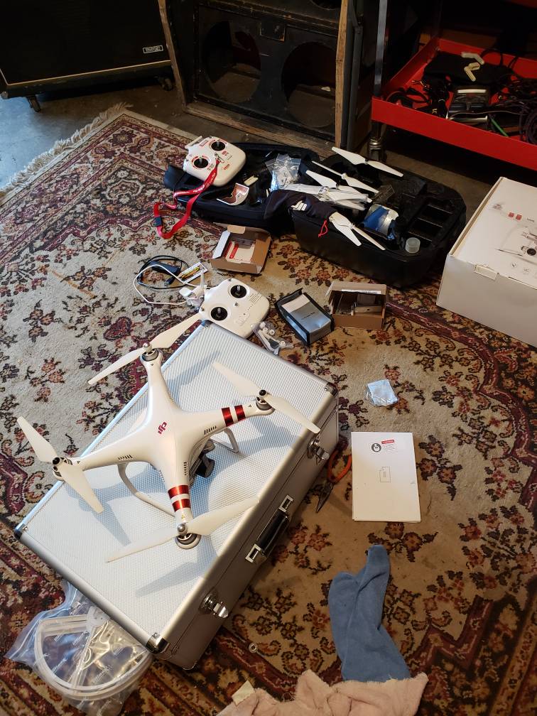

Found a p3s to replace one I lost, couple of questions, had flight data reviewed ,said mother board crashed causing fly off,(never found stuck in heavy forest tree tops) questions 1 I have two remotes now ,how do I know old remote isn't fried,2 what do u have to do to pair old remote with new bird,( I want to modify antena mod slso). 3 has anyone added some form of GPS tracking device to drone,( I feel if I had on old one I could have found ),thanks I'm refreshing my memory looking at tutorials getting ready to fly, got whole package cheap, guy flew couple of times wasn't into it
Found a p3s to replace one I lost, couple of questions, had flight data reviewed ,said mother board crashed causing fly off,(never found stuck in heavy forest tree tops) questions 1 I have two remotes now ,how do I know old remote isn't fried,2 what do u have to do to pair old remote with new bird,( I want to modify antena mod slso). 3 has anyone added some form of GPS tracking device to drone,( I feel if I had on old one I could have found ),thanks I'm refreshing my memory looking at tutorials getting ready to fly, got whole package cheap, guy flew couple of times wasn't into itView attachment 113328

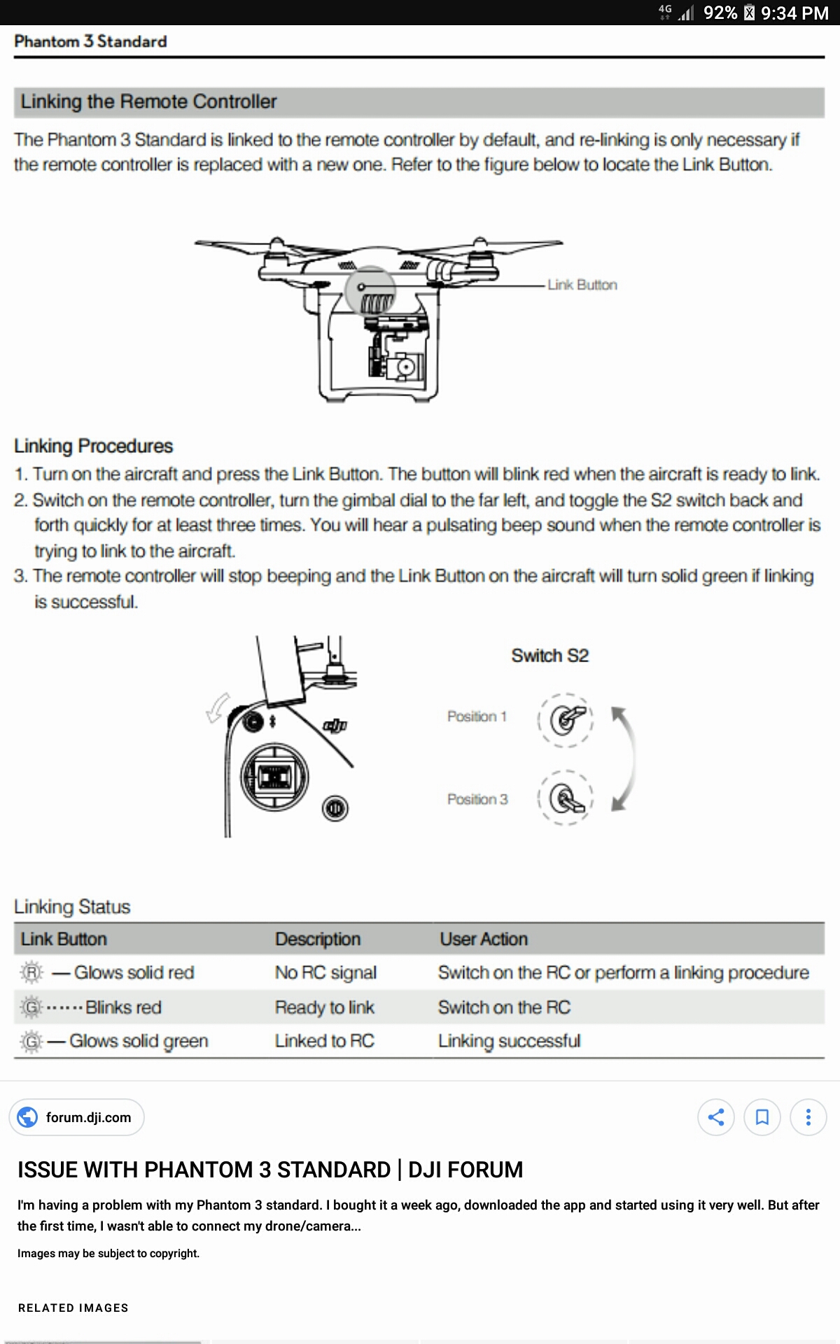

Good score,just relink remote of you choice and good to go,,I keep my new p4 one for spare,,,here's manual link but you can just open app under rc linking and do there aswell
Reactions: Scott Davis
If a P3S behaves in the same way as a P3Adv linking a new controller to the drone breaks the link between the drone and the old controller, if you subsequently want to use the old controller then you will have to relink it to the drone, ad infinitum
Reactions: Squirrel!
I don't know how to interpret that sorry, do you mean that when a new controller is linked the P3S does not break the link with a previously linked controller?
Na as normal it will just ask to confirm settings,don't have to worry about previous link,,it's easy to unlink remote from drone just with single press on link button,it then turn red ,this way as well will link remote new or old,,,hope I word that right
