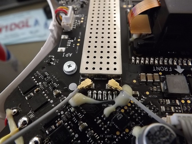

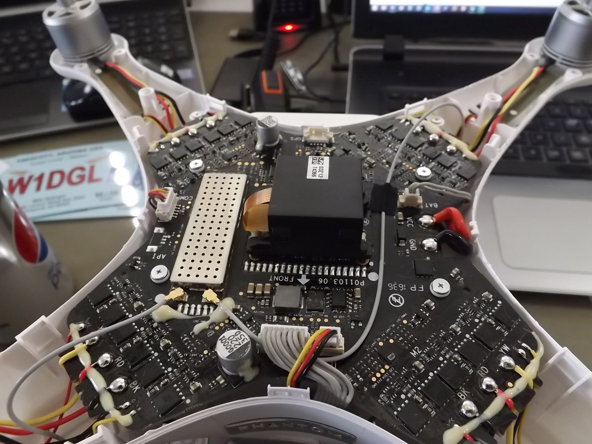

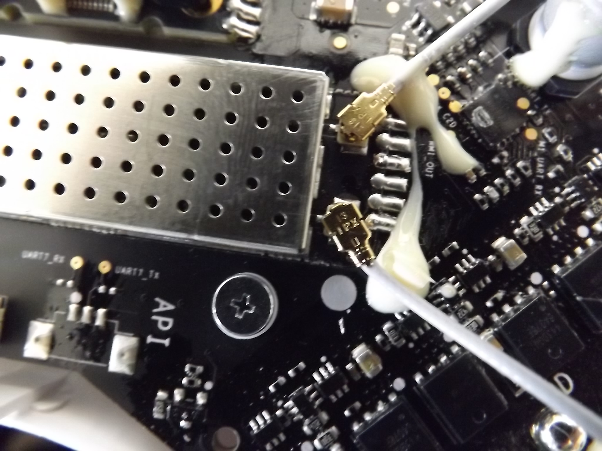

OK, a couple of pictures (closeups) of the antenna connections on the main board. Someone on a DJI forum mentioned that I should check them. While doing that, I accidentally pulled one of them loose from the silicone, but the connection itself seemed solid.
I'm guessing that the unit above them with the holes in the chassis is the transceiver module. I was not getting the connect/disconnect issue until after it crashed. Connects/disconnects again about every 30 seconds or so.
