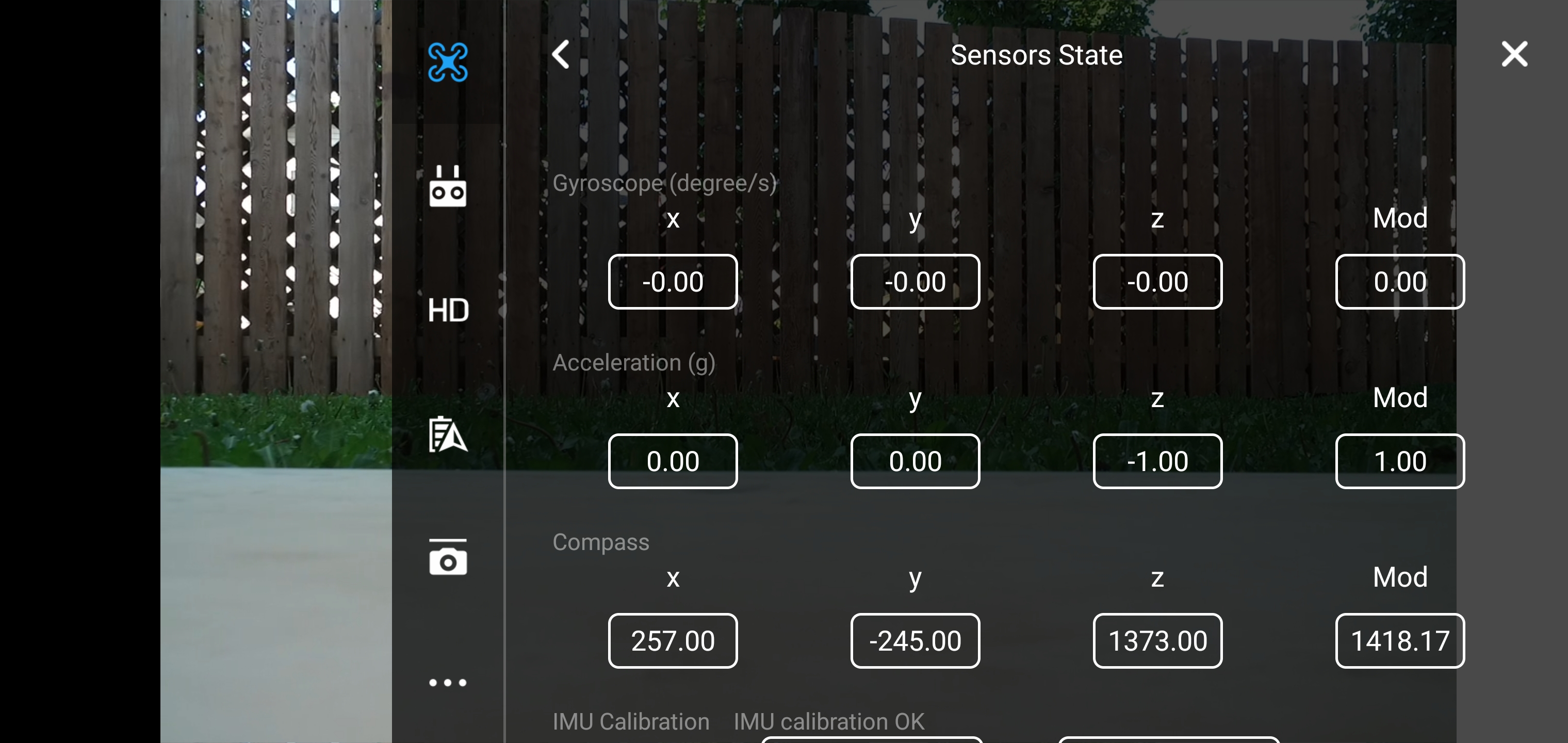

Hi All,
My P3P has an annoying habit of physically dropping altitude, meaning the aircraft will slowly lower it self down but the altitude onscreen remains steady. I compensate by climbing, which registers onscreen, but it will not maintain a steady altitude while hovering. An example is: I take off in my yard and hover about 6 feet off the ground, mainly to test my batteries, at the end of a 20 minute hover, the aircraft is still only 6 feet off the ground but my constant correcting by pushing up on the left sticks shows I'm at 30 meters onscreen. I've tried many IMU calibrations (both cold and warm temp) and the calibration always completes normally but this issue never goes away. Do I need a new barometer???
There's the beginning of calibration...

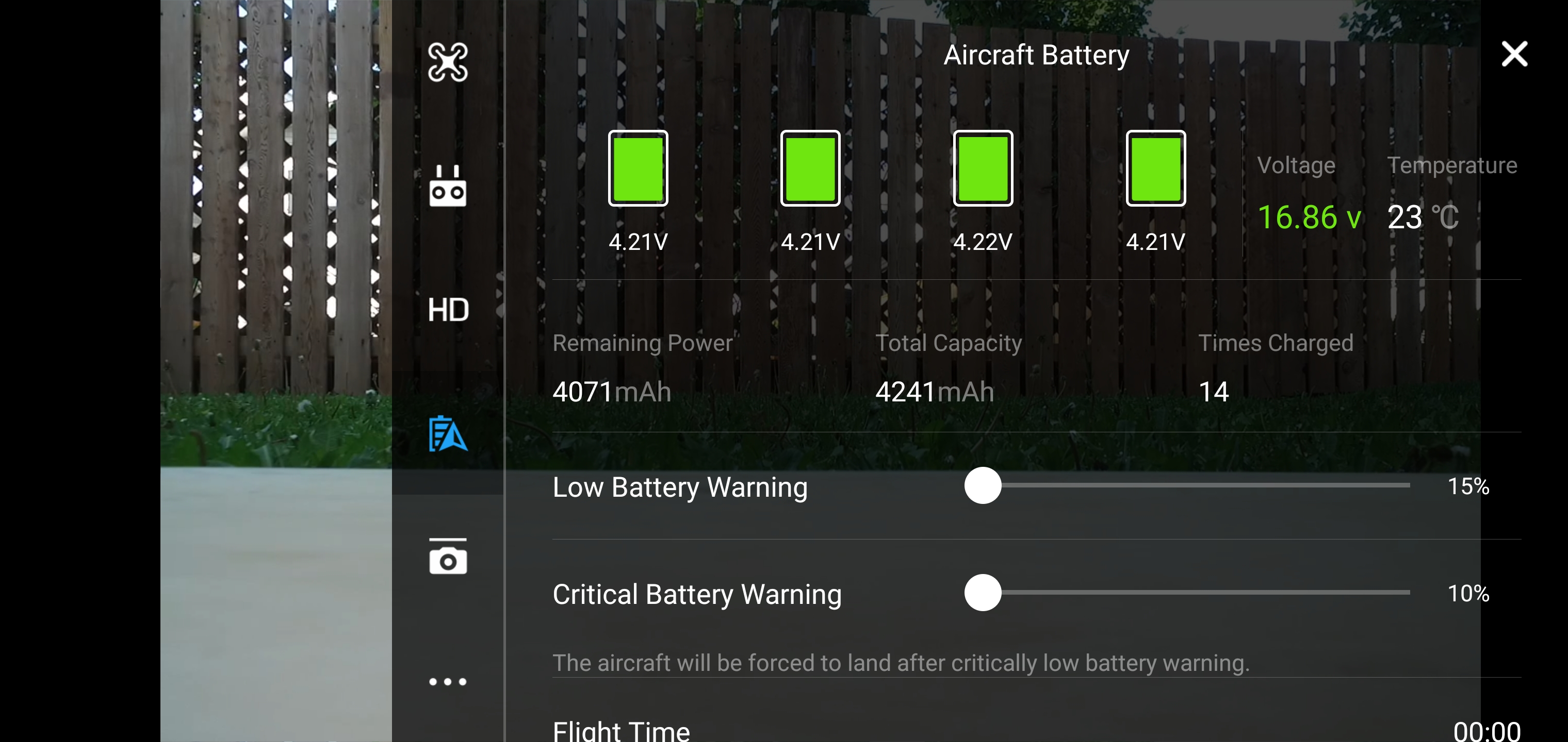

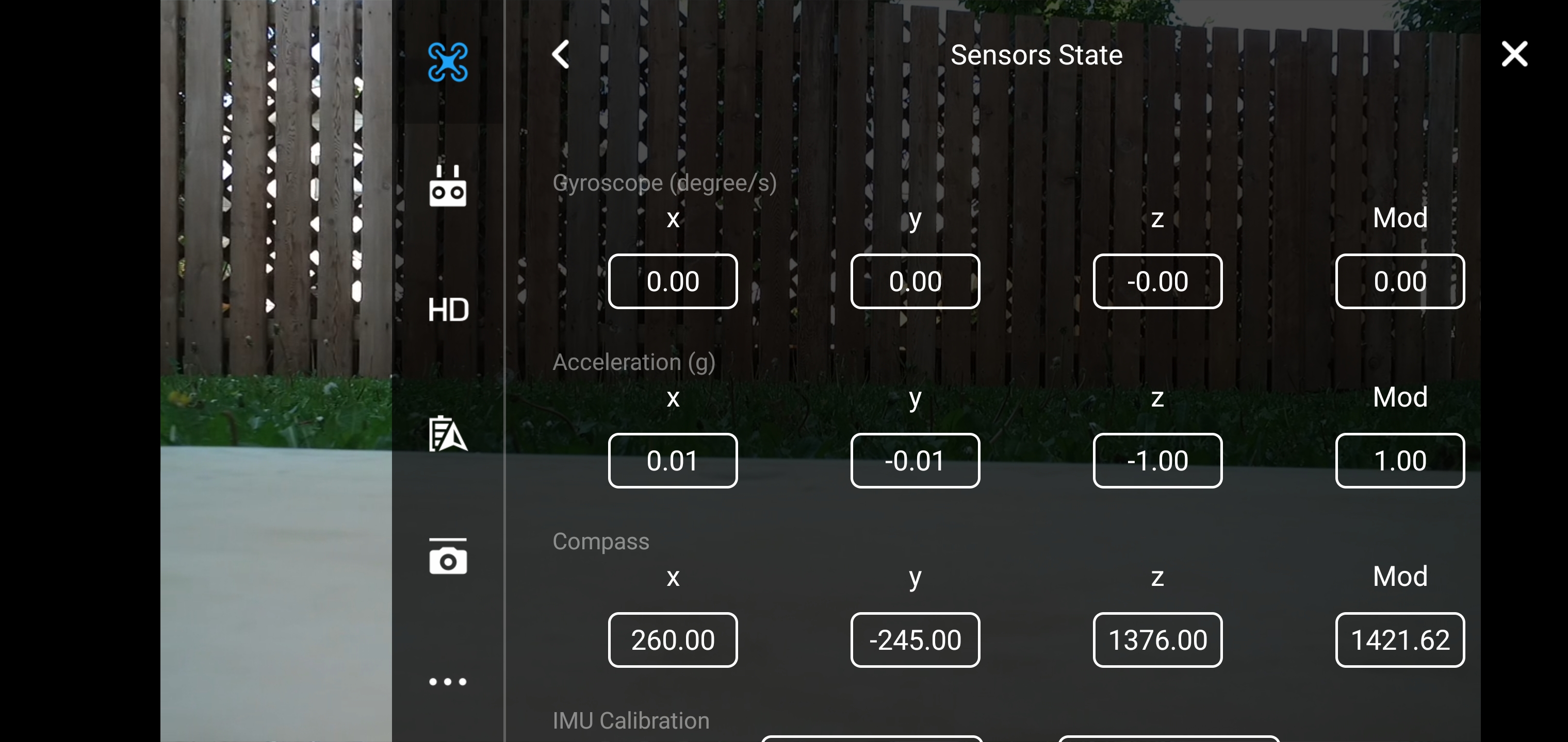

Here's the end as well as a battery and temp reading at the end.

The Z has always had a mod of 1.0. This AC has had 2 minor crashes. No damage other than props. Could the IMU damaged?

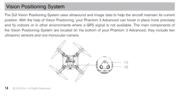

Have you checked to see if the Vision Positioning Sensor is on?
It does the same thing whether VPS is on or off. VPS does show proper altitude from ground level when on.

I would think that VPS would stop it from descending too close to the ground but it doesn't. It gets very close to the ground, close enough that I manually correct by climbing, to be honest I havent let it actually touch down so I'm not sure if it would.
I’m wondering if the VPS is even working...

Well it does correctly show the altitude from the ground although I've never really found it to help much for stability, indoors or out. Even with a clear pattern for it to "look at" it wanders around. Normally I keep it turned off as I've read the ultrasonic sound it creates can annoy dogs and other wildlife.
