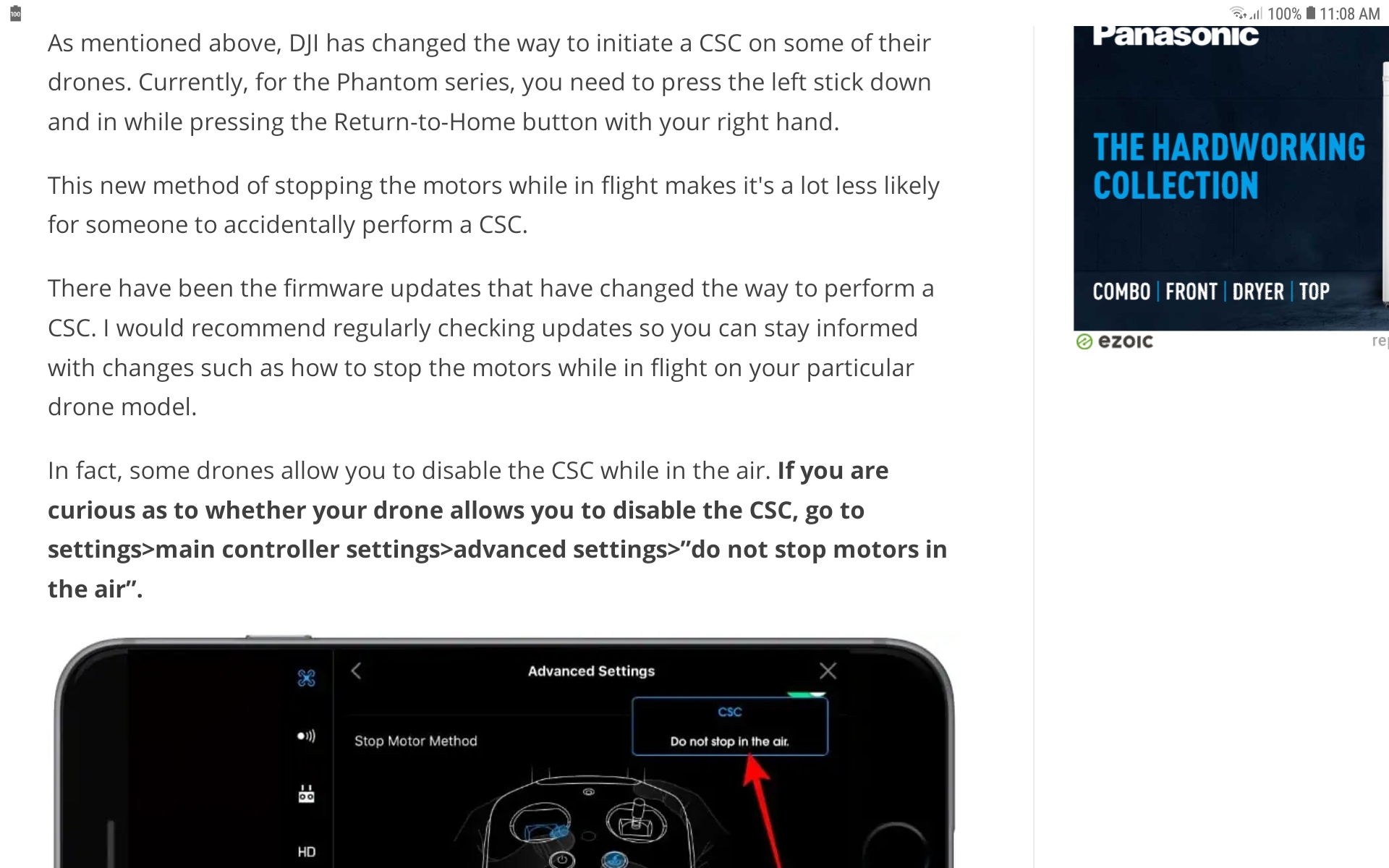

Can use left stick to inner bottom corner and RTH button for mid air shut down.
I dont know how fast it shut in,I never tryed it
This was the one I refer to
FYI that the method you mentioned, stick plus RTH button, was put in place in early 2016 for the P4 models but was not added to the P3 models.
Later in 2016, the P3 models saw a change to CSC. The change increased the time it takes for CSC to stop motors from near instantly to about 3 seconds. The RTH button method was not included for the P3.
Ever since 2015 we have been advising P3 owners to not use the CSC to shut down the motors once landed because it often causes flip overs due in part to initially surging motors. Since 2015, we have recommended using only the left stick down method to stop the motors once landed. CSC is still however the means to stop motors while in flight even if it takes a few seconds longer than it did when the P3 was first released.
One side note is that several people over the years have reported that the CSC method failed to stop the motors, even if holding the CSC long enough, if their AC was inverted following a mishap. They either had to use left stick down to stop the motors, or physically remove the battery if they didn’t think to use left stick down.
This was the one I refer toView attachment 122335
Ever since 2015 we have been advising P3 owners to not use the CSC to shut down the motors once landed because it often causes flip overs due in part to initially surging motors. Since 2015, we have recommend using only the left stick down method to stop the motors once landed. CSC is still however the means to stop motors while in flight even if it takes a few seconds longer than it did when the P3 was first released.
Ah ok was not aware,,I just read ""for the phantom series """ well that's more misinformation on djis part..
Sorry bout that,,I not have posted it,they should be more specific
