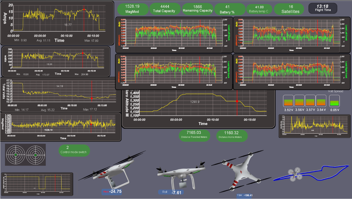

Here is an example of a converted log using the template in the Dashware profile:

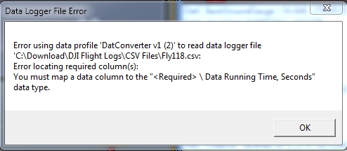

I have updated and copied over the appropriate files, see the gauges in the program but am getting the following error while trying to add the data file. Not sure what I'm doing wrong. Any help would be appreciated. Thanks in advance
I do not know which version of Dashware template you are using. But you should try to copy the file you copied in the Dataprofiles again:
i.e. Close Dashware and copy again
The file in the Unzipped file called: DatConverter v3.xml (could be called differently depending on the version you are using)
copy file to
C:\Users\xxxxx\Documents\DashWare\DataProfiles
Let me know if that helps
copy file to
Thanks for the reply. I have copied the file again but continue to get the same error. Maybe I will try a different version of DashWare. I am currently using v1.7.37
