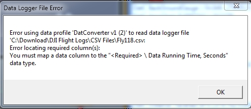

It produced a csv that I tried to use in the program.. But I got...
"<Required> \ Data Running Time, Seconds data type"
(In a pop up window)
Yes this showed up & I did it...

Hi, I am trying to use this flight log reader and I am getting an error on my converted CSV file. I wonder if you might know how I can correct this?
Unfortunately I have limited experience with Dashware. I installed @Luap 's profile following the instructions and have used it a couple of times. Your best bet is get @Luap or some other Dashware expert to help you.
During the installation there were several steps that I didn't understand and had to rely on following the installation instructions exactly.
I can generate an error similar to yours by not specifying the data profile; not "DatConverter V1", I am wondering why yours has a "(2)". Maybe you copied it twice so you have DatConverter.xml and DatConverter.xml (2)
In order to use luap's Dashware profile you must use the DatConverter found here Fly.zip or upload it to flylog.info and then download the .csv.
Sorry I can't be more help.
Bud,

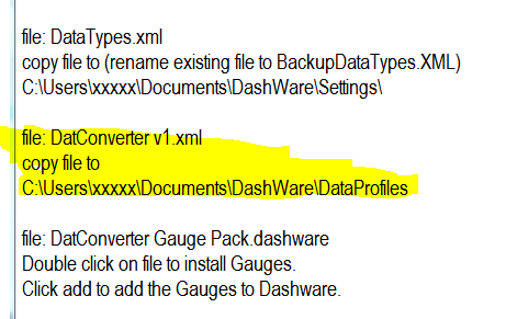

Close Dashware.
And copy again the DatconverterV1.xml only (overwrite it). Part marked in yellow
Close the Fly118.csv file you might have open in Excel (or opened in any other program)
Open Dashware, load the template, then click on the + add Fly118.csv and profile DatconverterV1. (it should not be called DatconverterV1(2)) as per your above screenshot.
i.e. follow the video here.
If you still get the same error message load profile as per video in the last screen of the video and make a screenshot of the full screen.

Close Dashware.
