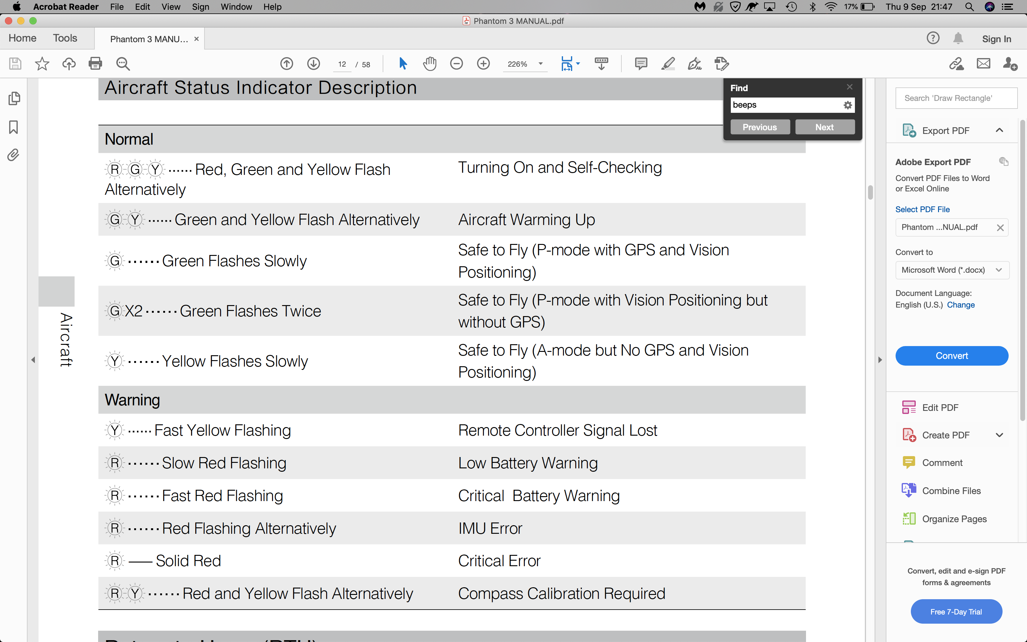

What are the rear status lights doing?
I was thinking along those lines next ianzone. If you can, do an IMU calibration, only takes a few minutes and can't do any harm. Also make sure the RC/Drone are linked?
