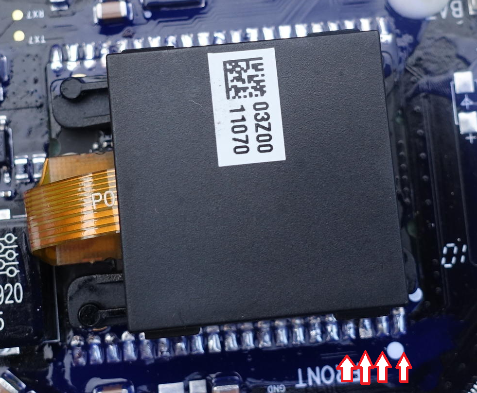

hey Drusha - it sounds like you dont have the battery cable setup right, or the motherboard has some damage, or your compass fix didnt work. In crashes the middle of the board where the board and imu come together, if one of those soldering conncetions is broken or not perfect you would get those beeps.check these very carefully (all of the solders not just the ones with arrows)

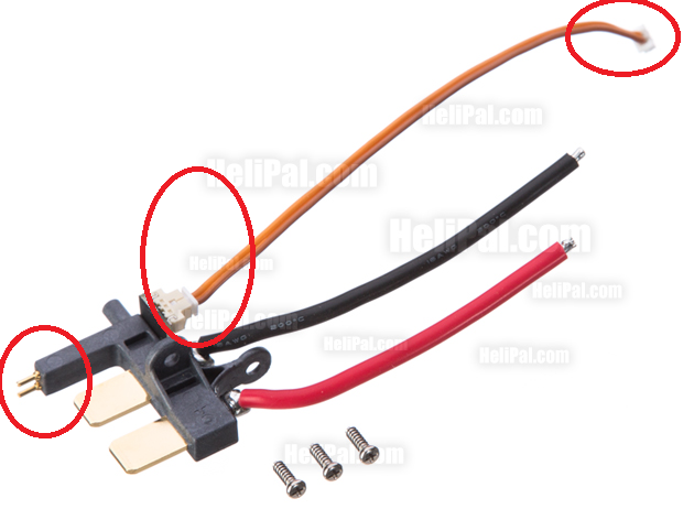

But, if everything powers on (as it does) and camera works, no compass errors .. just no battery, I think its the small cable which goes from the spring pins of the battery connector to the board. This one:
Check that the springs on the left side still push in/out and connect with that part of the p3 battery Make sure the orangeish cable is securely plugged in there, and that the other end is plugged into the mainboard. Make sure no issues in the wire. My gut feeling is that this is the problem since it powers on you just dont get any battery details.
