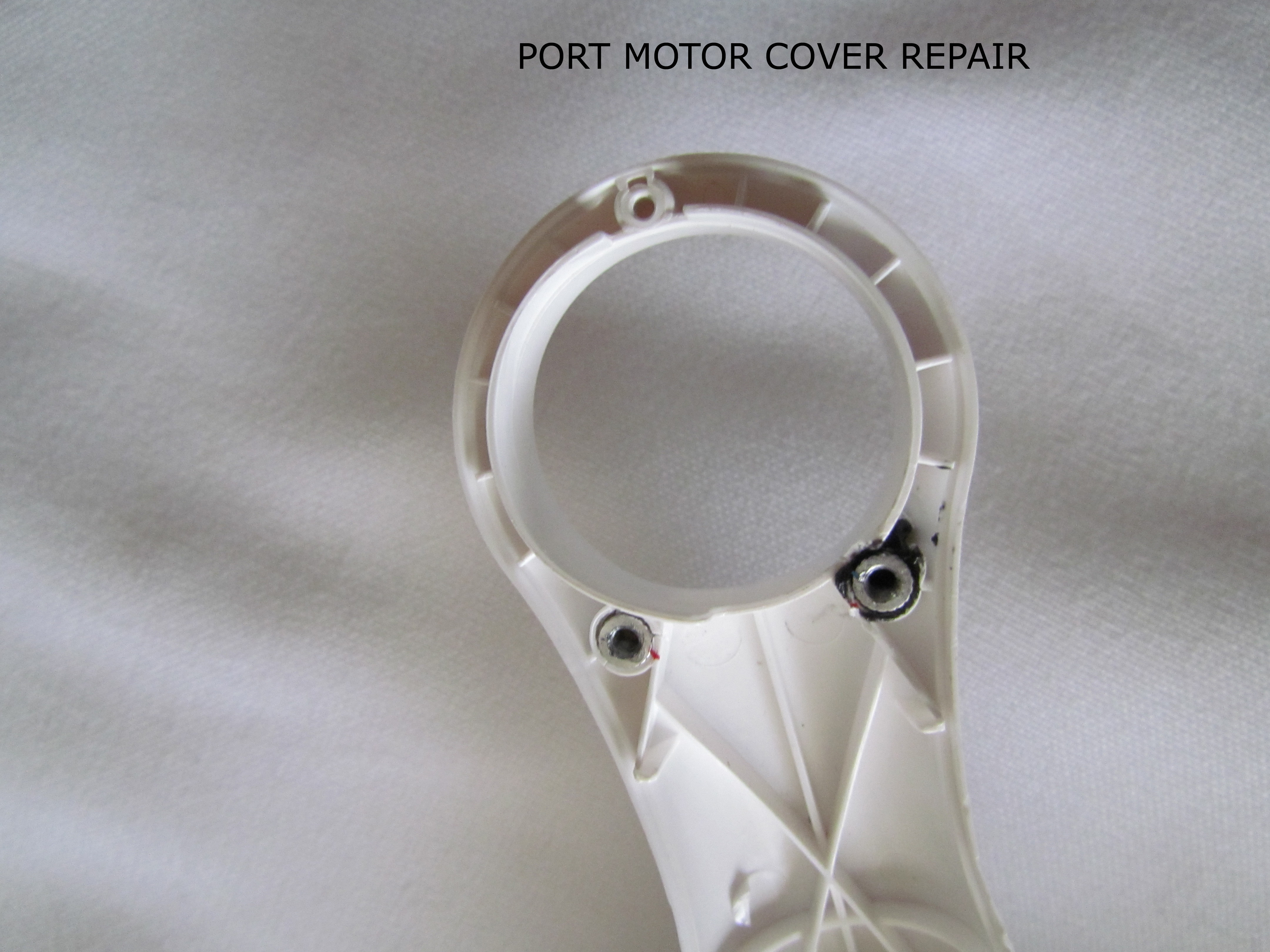

Post crash analysis shows that even though the battery reported that at the moment of impact the batteries were supposedly 23% charged, but cells 3 & 4 are bad with voltages of 2.79 and 2.81 while cells 1 & 2 were 3.4 and 3,2 respectively. The visible damage from the crash was one broken propeller, the camera broke free from the drone at the yaw arm and the top shell had damage from a screw being pulled out. I'm waiting for the repair kit for the gimbal and was able make temporary repairs with BJ weld for the screws that were pulled out of the top. A new top is on order.

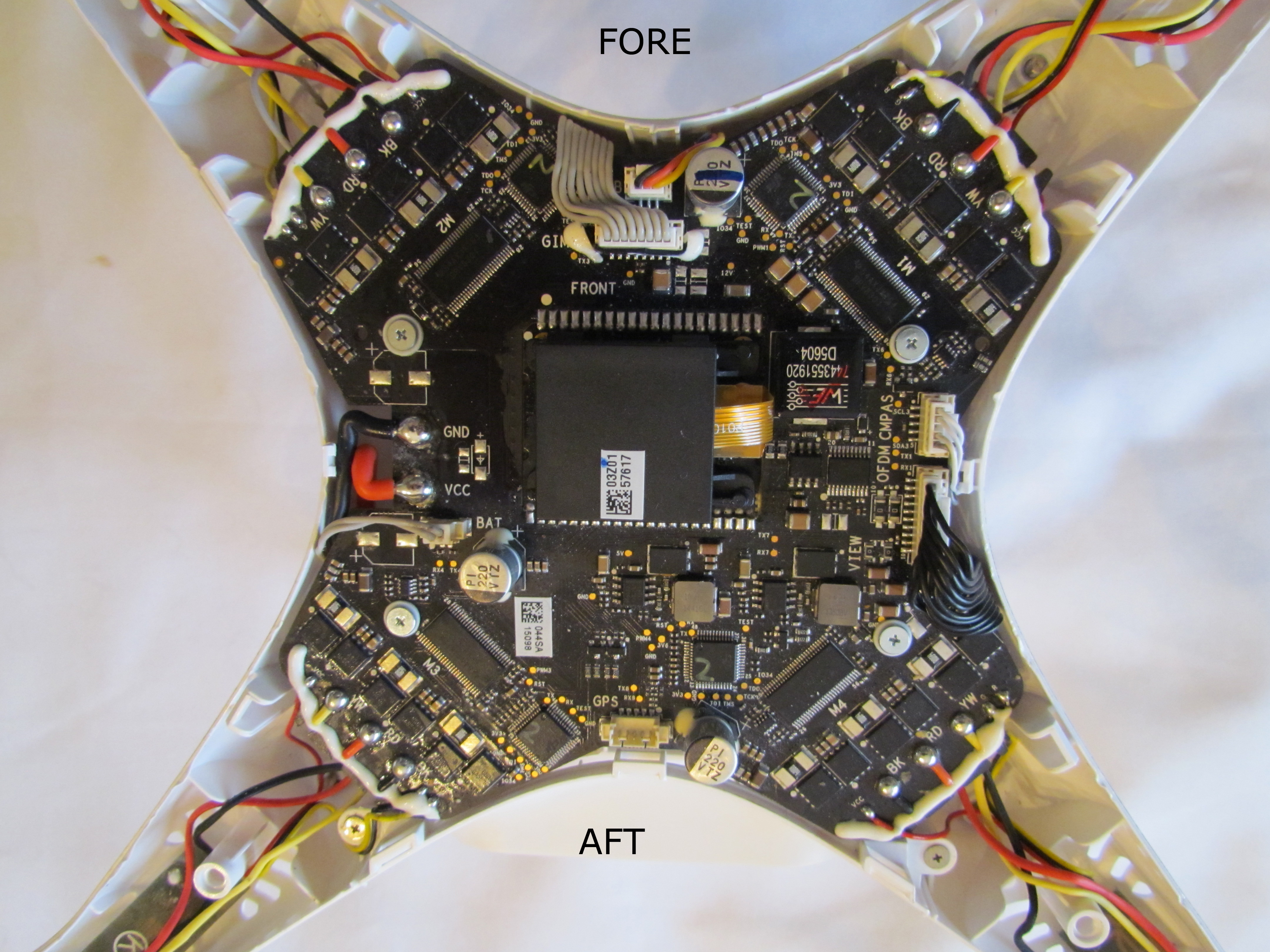

I disconnected the two cables to the gimbal body and removed it from the drone and tried again with the same results. Next, I removed the top cover again and inspected the main board for damage and could not find anything with my untrained eyes. Google searches suggested a re-flash so I reconnected the gimbal body, formatted the micro USB and copied the V01.11.0020.bin file to the card and powered on again just to get the same results. This is the same version that was previously on the aircraft.

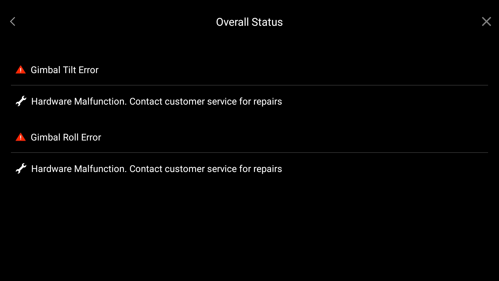

KachemakDiver - Thank you.
Yes. Here are the reported errors:

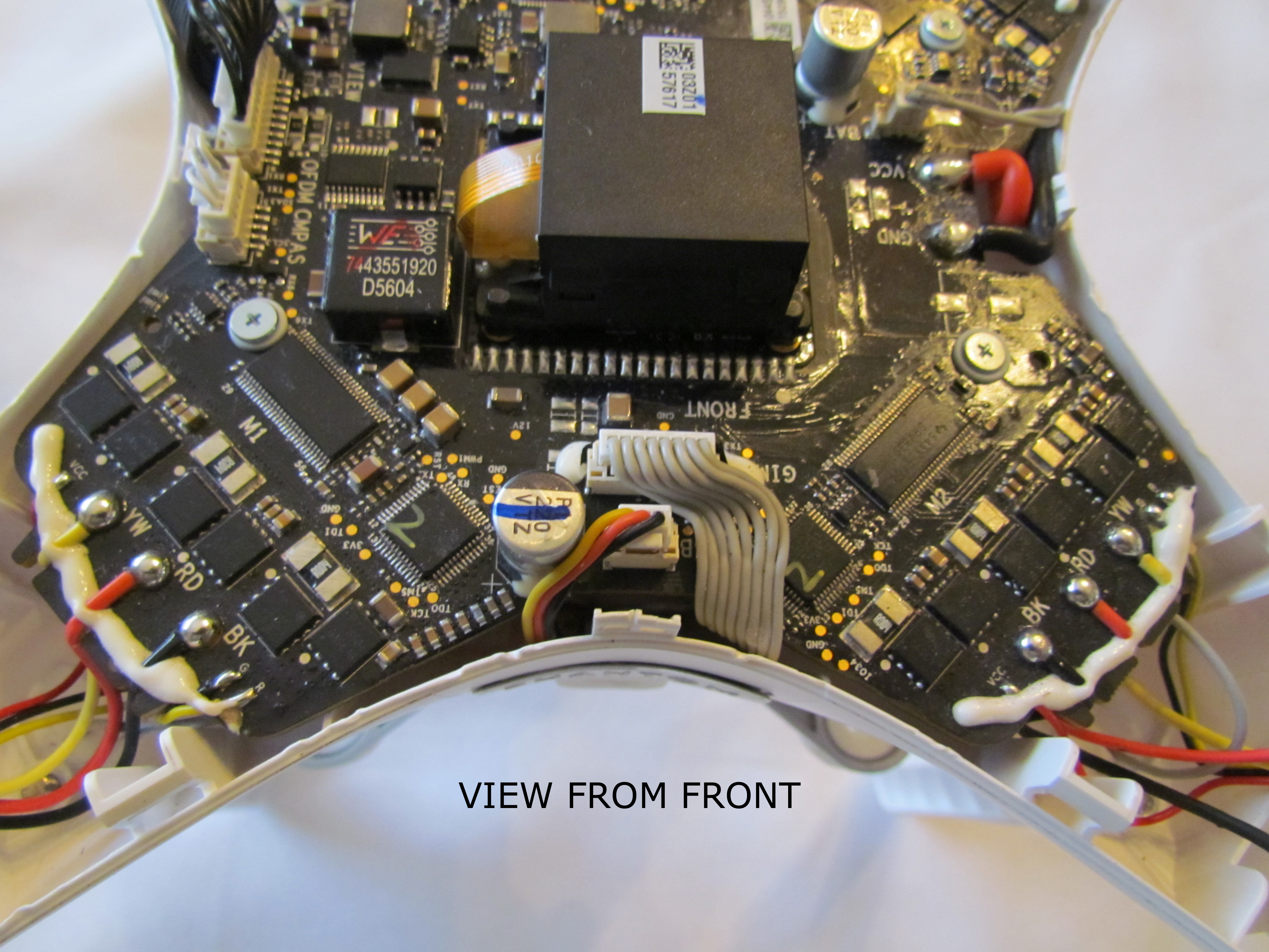

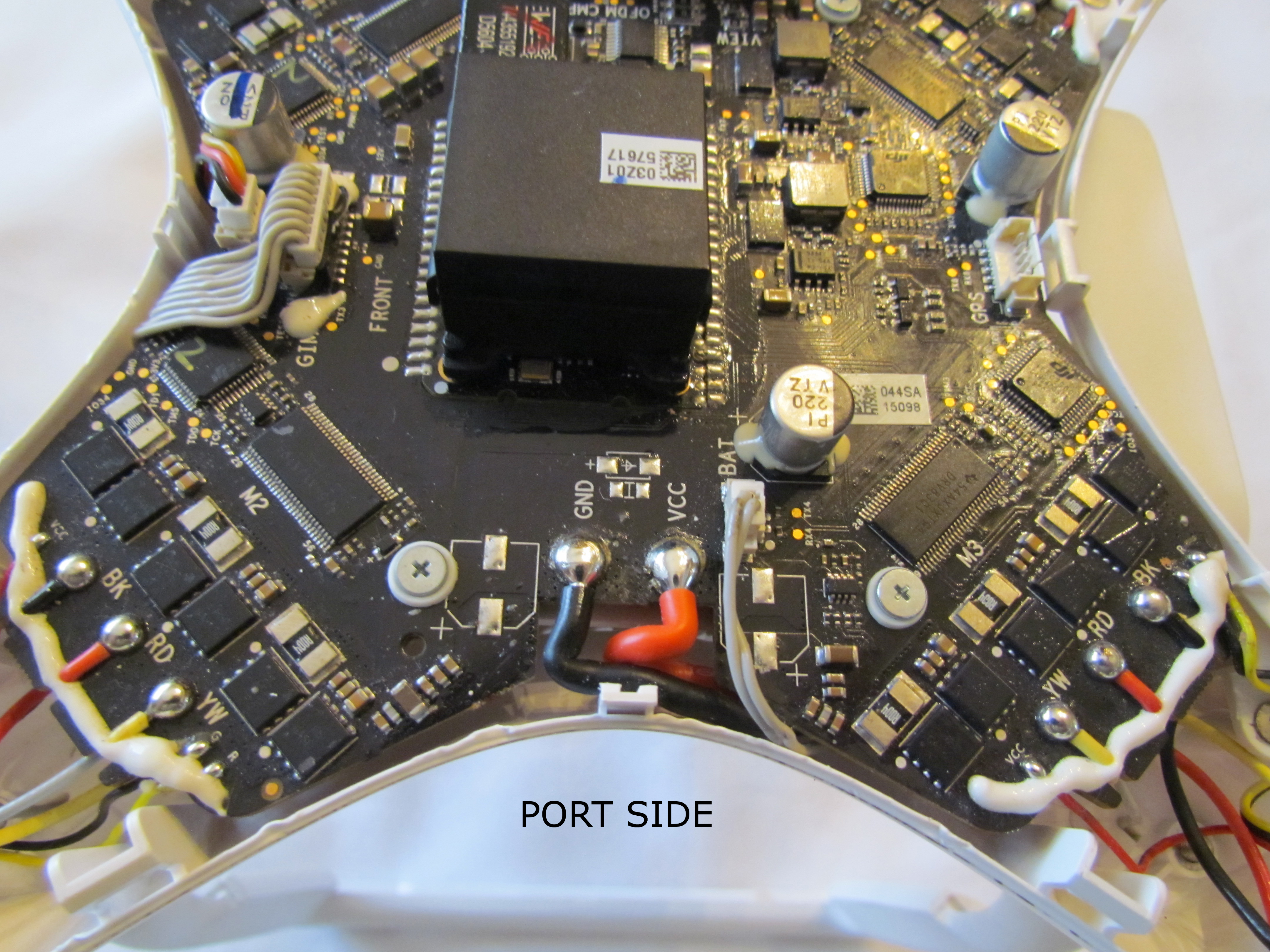

Your FC probably isn't working. ESCs are beeping because of no "hello" message received from FC.
Connect your front USB to PC; that will give you virtual UART port. Check whether there are binary packets transferred through that UART (the packets will also contain text messages). You may do that with PuTTY.
If ESCs have no "hello" from MC, each of them is beeping independently; if you leave it on for long enough, they should desynchronize their beeping - they don't have quartz stabilization.
Also, inspect your ESC Center Board for damage.
EDIT: Oh, I see you already did. Good. Make sure you inspected the connections around FC daughterboard.

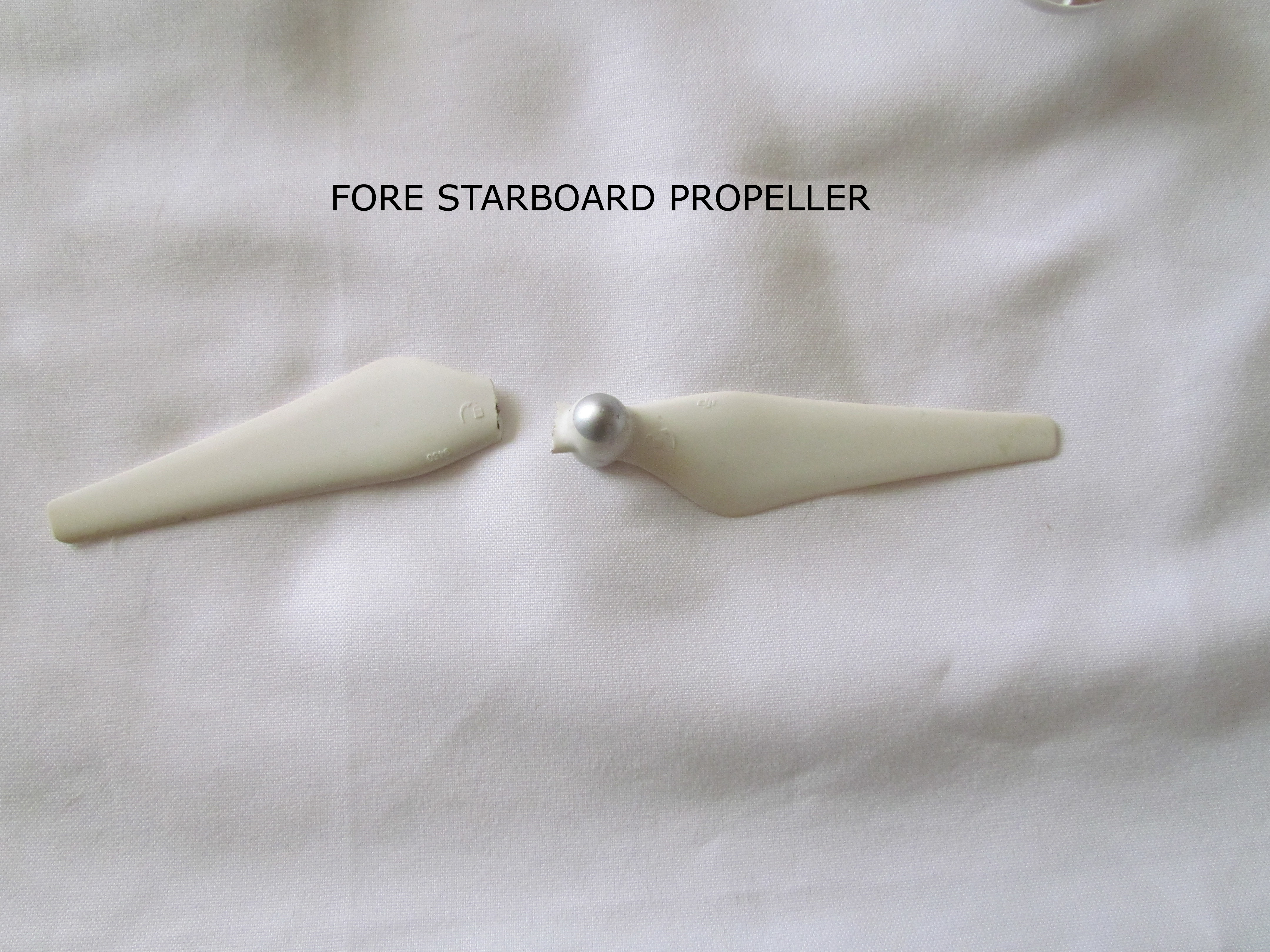

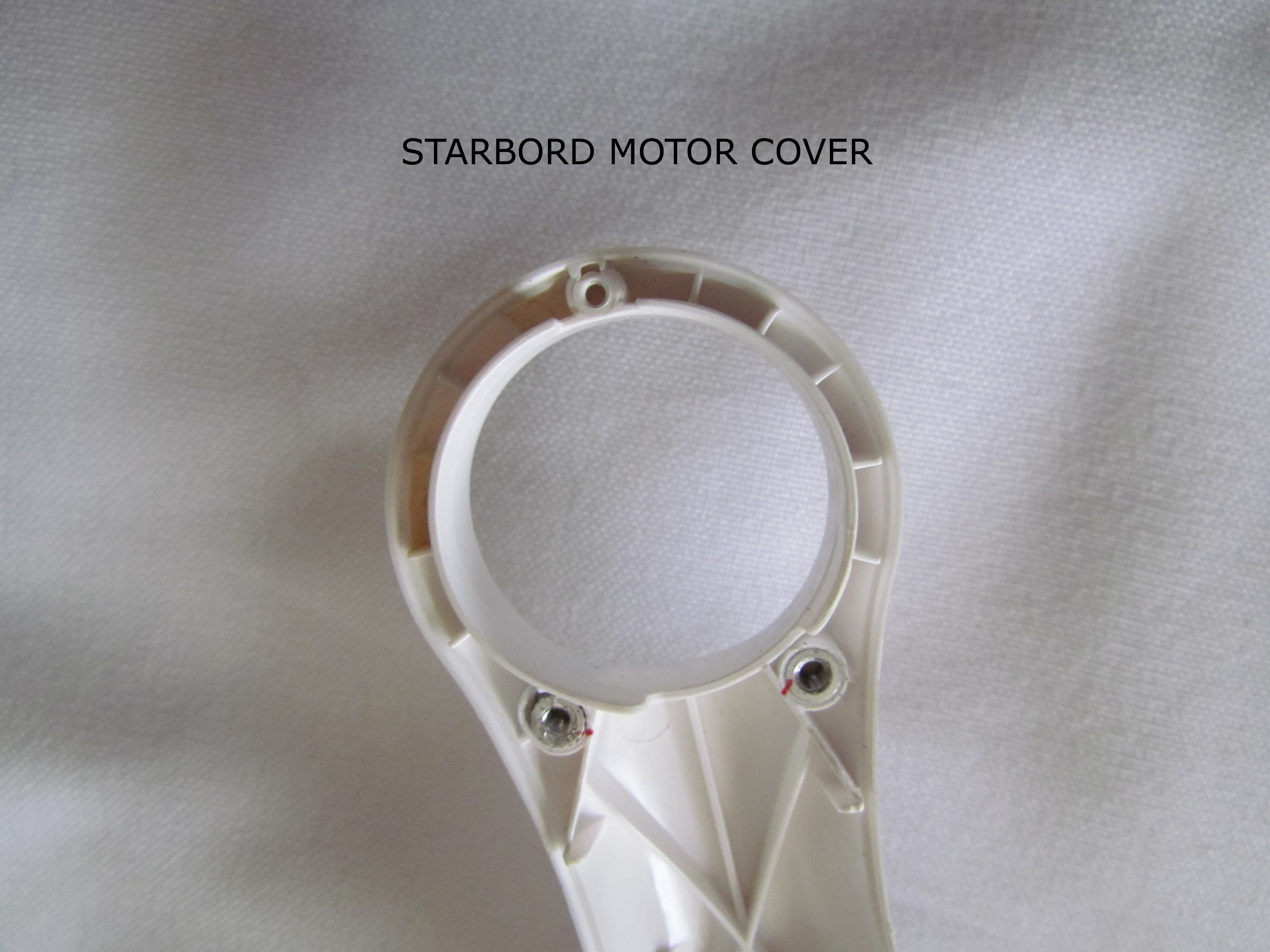

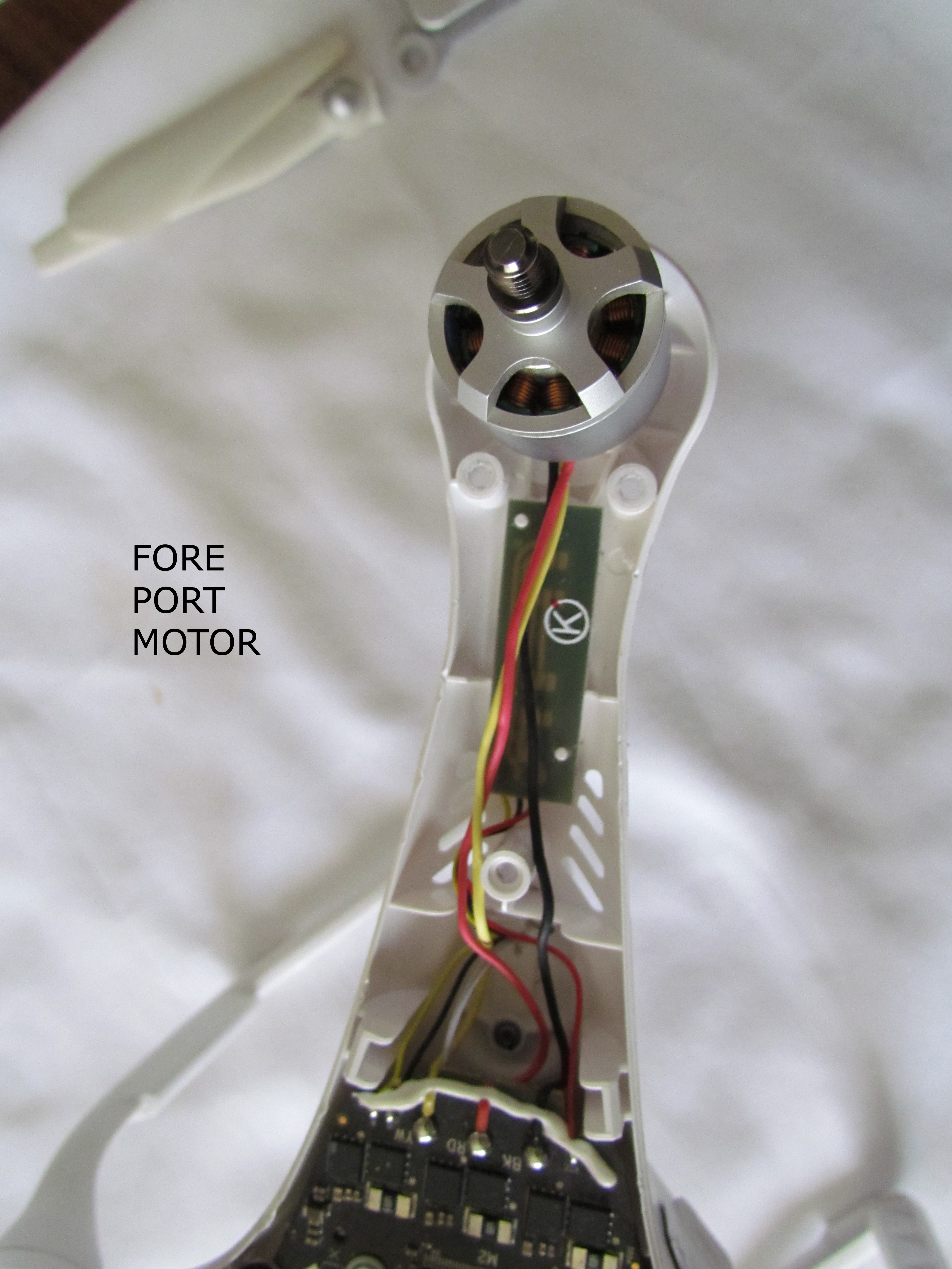

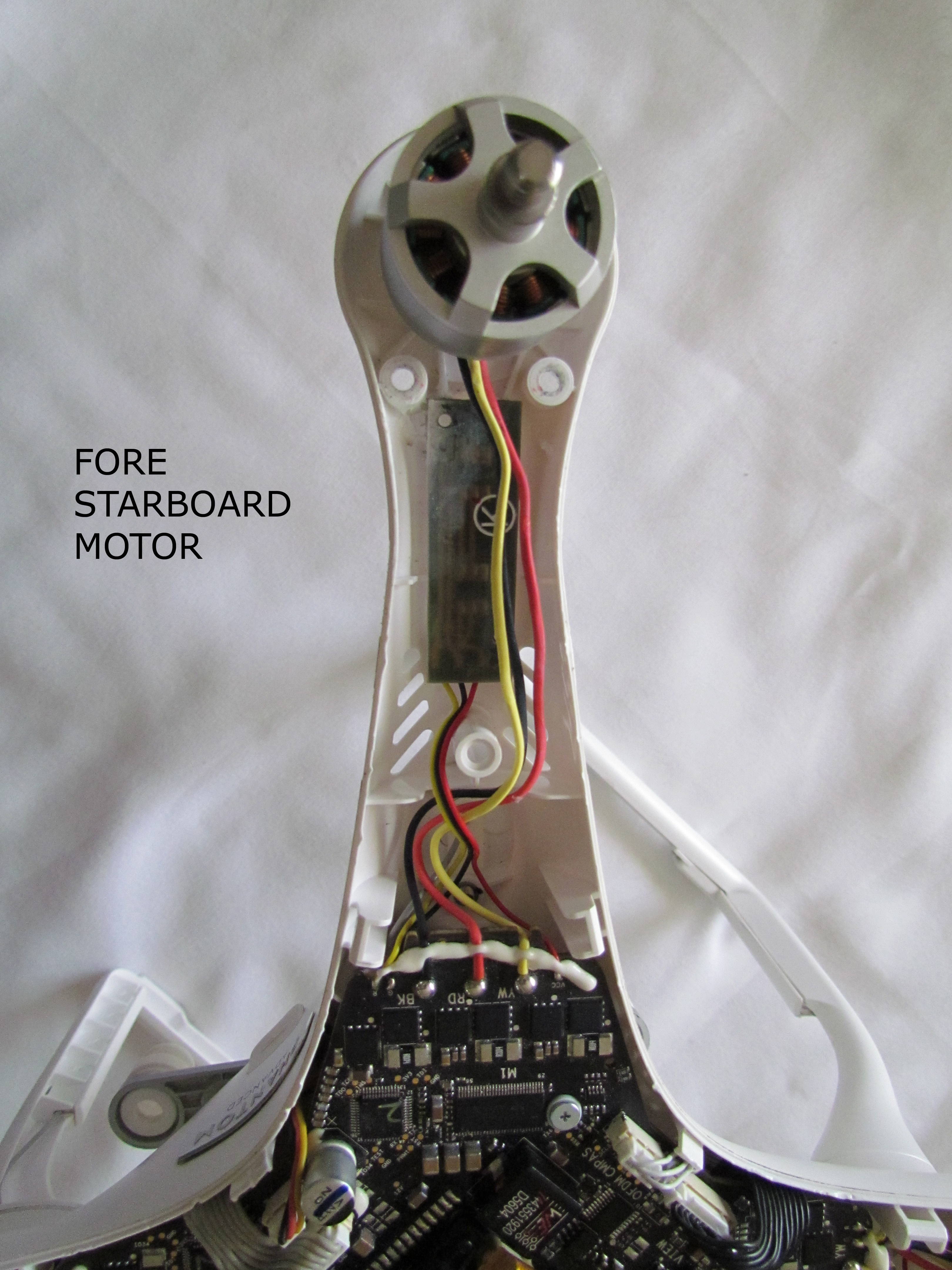

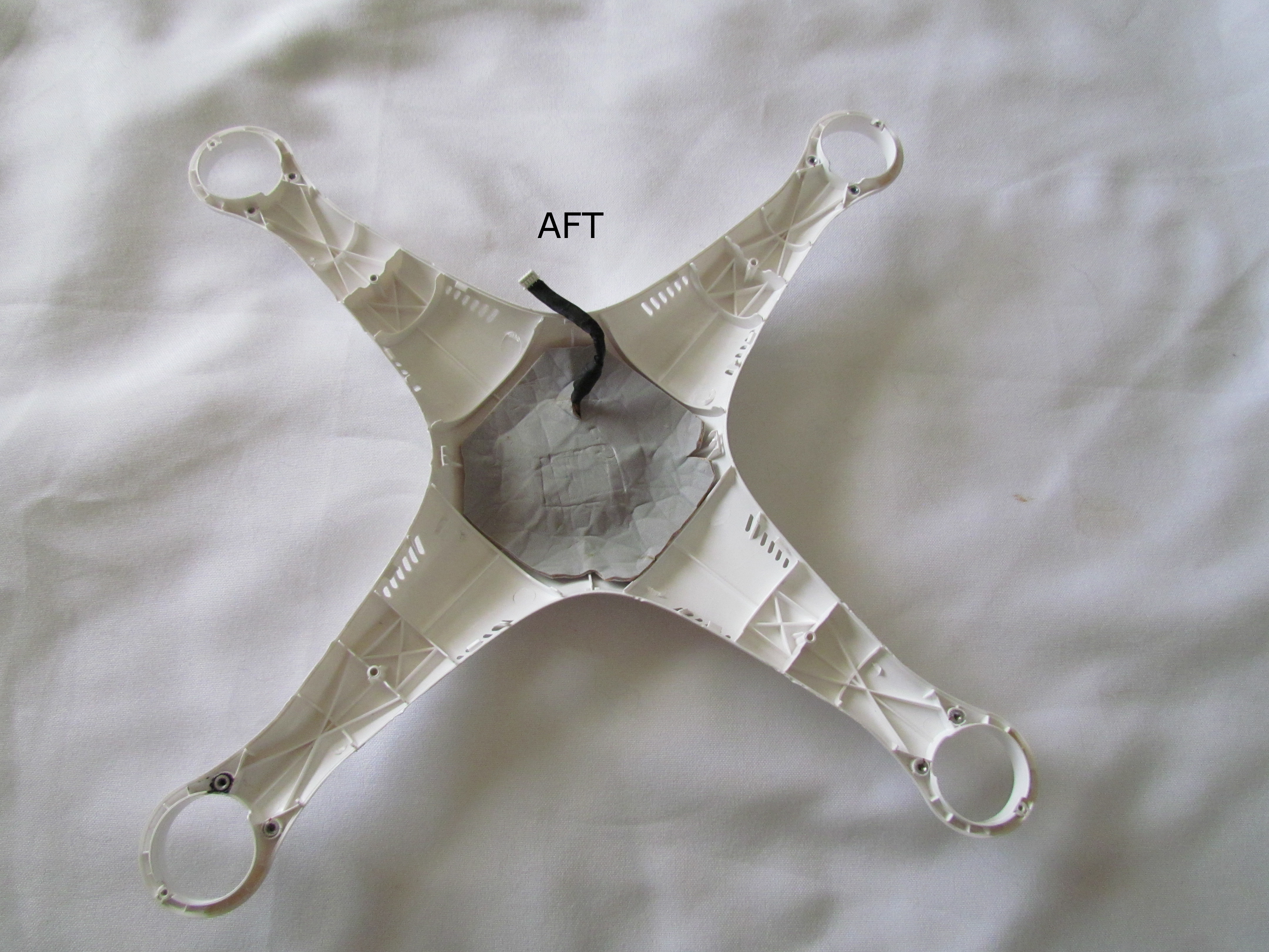

Here are pictures of the front motors, the top and broken propeller. The metal nuts pressed into the top had been partially pulled out. They were gently pressed in except for the one that was too damaged and it was fixed with a dab of JB weld.

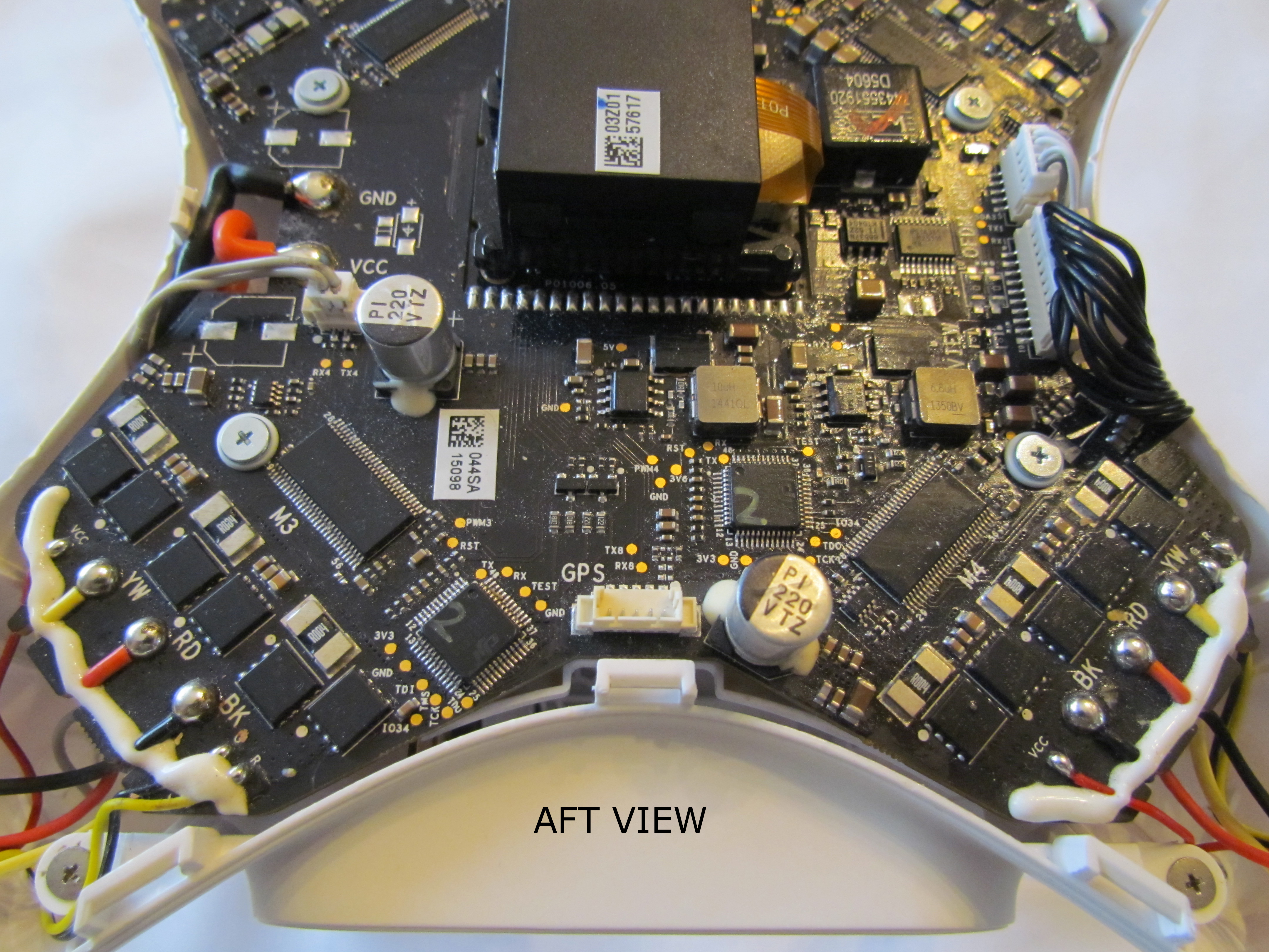

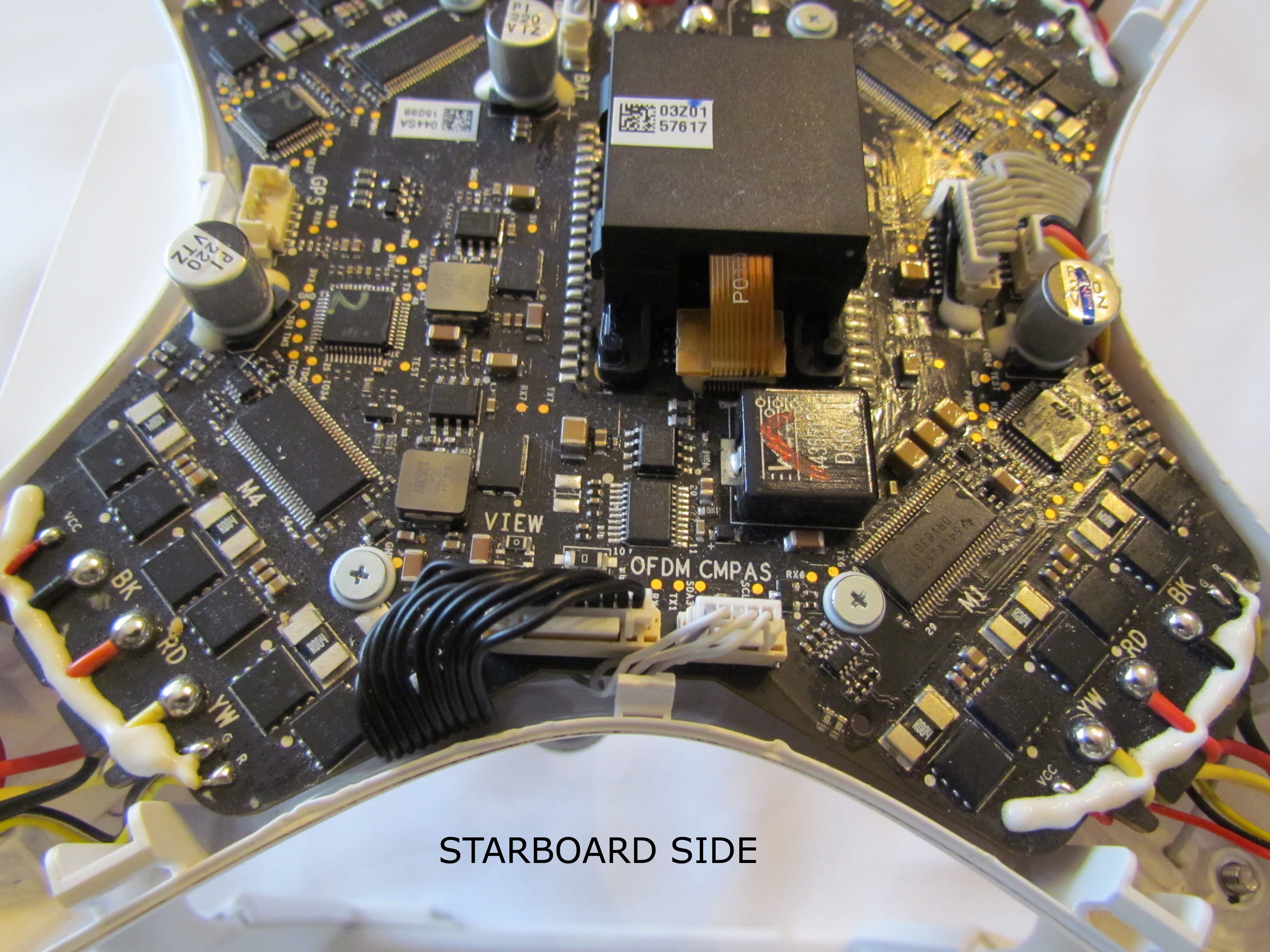

How can I get to the FC daughter board to check it?
Torn solder blobs are even visible on the photos you've shared.
P3 Flight Controller aka MC
@ quaddamage
Thank you for all of your advice. I borrowed some jewelers magnifying lenses and can see how the 'FC was pushed down breaking several, if not most, solder connections. I also see an indent in the GPS shielding in the top cover.
Looks like it is time to get my vision checked, brush up on disassembly and soldering techniques.
