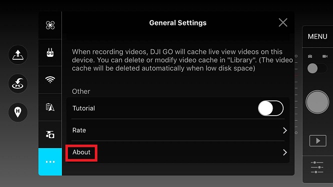

Got my P3P today (1/12/2016) , paid Drone World $49 to install updates before they shipped it. When I go to the "About" on DJI GO app, it tells me I have 2.4.3 App version, 1.5.30+ on the aircraft and 1.5.70 on the R/C. I am getting a "Battery requires upgrade" notice on the overall status screen. Should I upgrade to 1.6.4? Obviously, I'm new at this, so I'm hesitating to do anything at the moment as the bird flew as I thought it would/should with no issues.
Yes, 1.5 has major battery issues. You should go to 1.6, but leave the app alone.
Each battery will need to be updated as part of the firmware upgrade. After upgrading the aircraft, you will power off, swap battery, reboot and let that battery upgrade. Once you get a solid green light on then gimbal LED you will know the upgrade finished successfully.

I followed the directions. Step 10 went like this: A/C powered up, the status light blinked for about 5 seconds, gimbal moved around, lights under the A/C flashed, heard the D_DD once, status light went to solid green, lights under the wings blink yellow. Never saw a alternating red/green status light at all. Does that mean the latest software is on there now?
It sounds like your Phantom did not try to install the firmware. You can confirm by looking at the TXT file generated on your memory card.
Which firmware versions are displayed in the "About" section of the DJI GO app?
Thanks Pilot51. Keep in mind again, I'm brand new to this. So I put the SD card in the QC, turn it on and let it do it's thing for 25-30 minutes, check that it's successful and change the batteries out to upgrade both. Now what about the R/C? Do I put the same card in the R/C and turn it on and let it update? You're help is most appreciated.
OK, may have figured it out. What started this is that I was getting a message that said the battery needed an upgrade. I have two batteries. When I put battery "A" in, no status message, A/C version is 1.6.40, we're good to go. When I put battery "B" in, A/C version is 1.5.30+ and I get a "Battery needs upgrade" message. I changed the bin file location on the SD card, put the SD card back in with battery B in the A/C. Turned the A/C on and blinking red and green status light appeared, got the the Morse code for about 1 minute. Then I got the D_DD tone, solid green status light. TXT file says success. Now both batteries give the same version 1.6.40+ and no messages. I think I got it to work.
Now the next question, should the R/C version be 1.6.40+ too? It shows it to be version 1.5.70. "msinger", I do appreciate your help very much!
