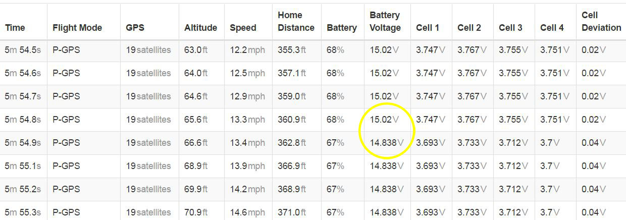

P3 inverted and fell from the sky...into a lake :-(
I posted to log from the DJI app to the first post on this thread. Could there be more data obtainable from the aircraft itself? If so how can I extract this data?
I noticed in your log that battery voltage does a sudden drop at 5m:54.8s this after voltage shows a continual increase?! up to that point in time. Also note that at that point in time the voltage drop across the 4 cells is different for each cell. Why?
