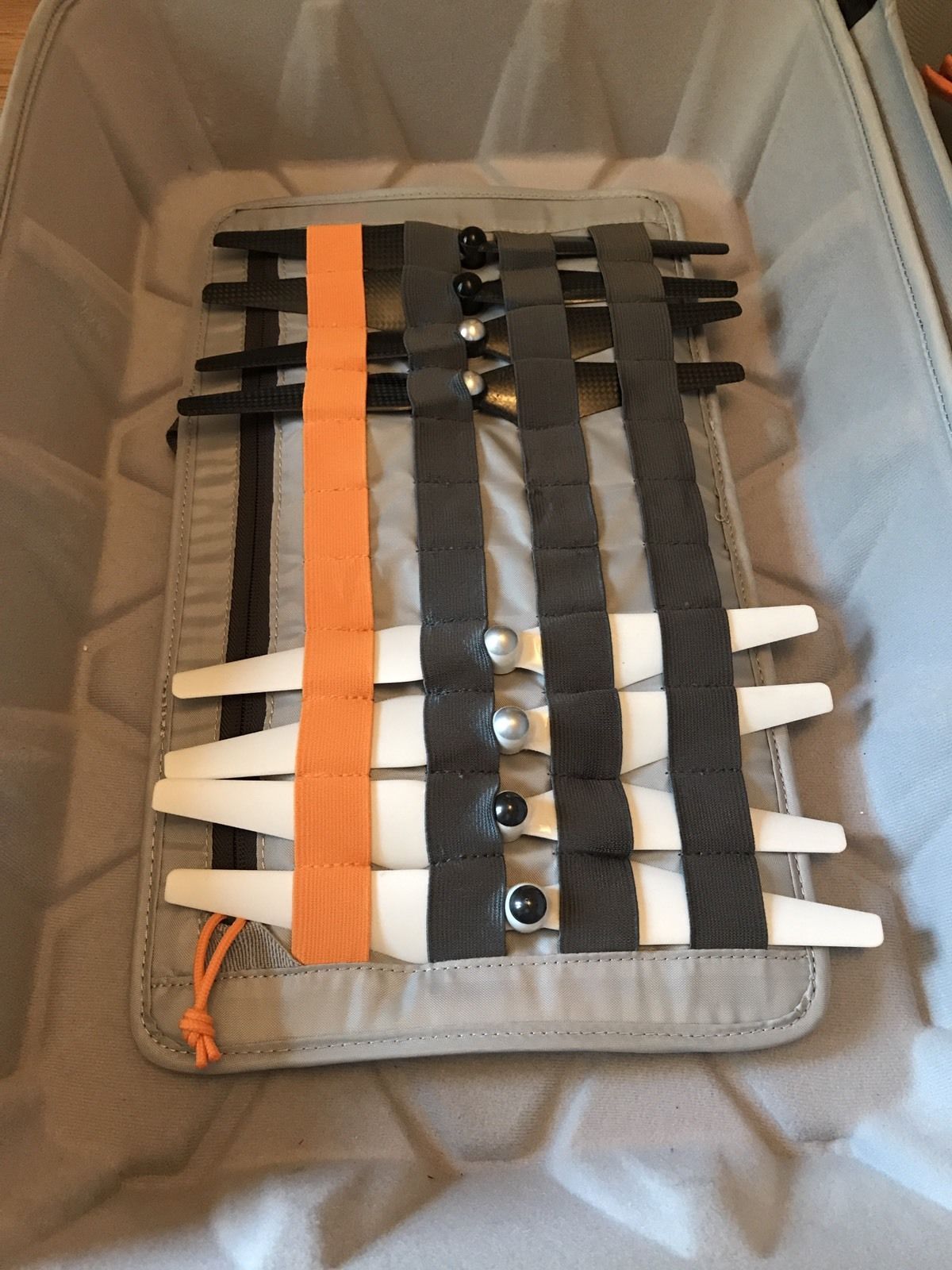

I was using black carbon fibre props, see top of the photo below. Come to think of it I don't think I ever got any propellor errors until i started using the carbon props. I'm almost certain the props where well attached, however I admit I had not been closely inspecting the blades for any hairline cracks. I guess carbon fibre could fail more catastrophically than plastic blades which will bend much more before breaking.
Yea, this makes much more sense than the solar/cosmic/electro-magnetic interference speculation proposed earlier.
Stick with OEM props.
They look like faux CF props? Not the carbon impregnated DJI offering. There are a lot of problems reported with the 3rd party offerings. The biggest issue is the hubs, often brittle with no give. The genuine props deform when torqued (the threads) ensuring a tight grip with less tendency to spin off.
Ahhhh, now it all makes sense. Carbon props strike again. Another crash after a carbon prop fly off. If they were genuine DJI props, DJI might have covered it if it was still under warranty.
