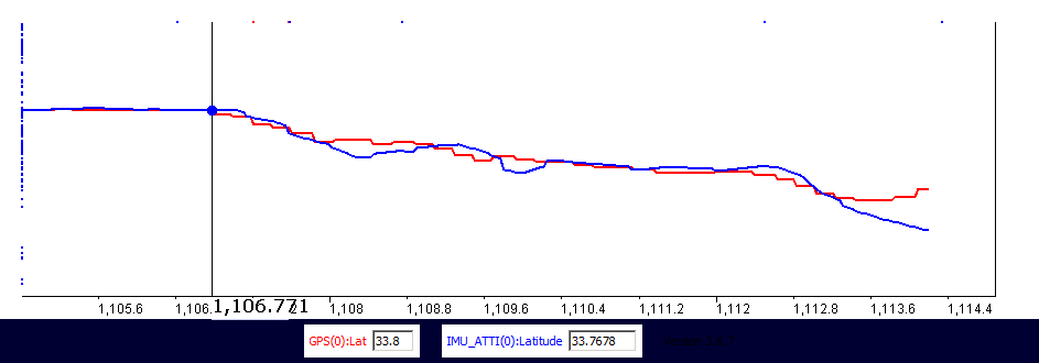

The reason I suspect that the cause was due to poor GPS data can be seen here.
The blue plot is the Latitude computed by the FC and shows the P4PV2 moving south. This in incorrect since the P4PV2 was moving north. But this isn't totally conclusive since the FC uses other data besides actual GPS data to compute this value for Latitude. More significantly is that the raw GPS data (red) also shows the P4PV2 moving south.
