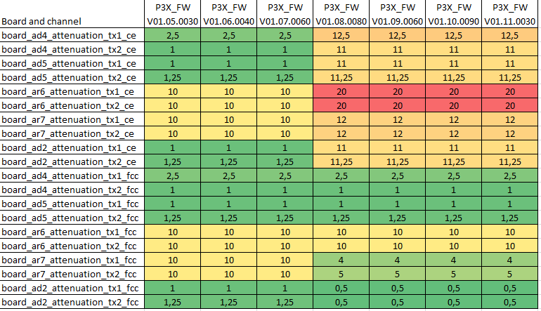

Ha, I got the lightbridge script running.
Here's a comparison of attenuations set in various firmwares. Note that this is OFDM board (air side) only! The GL300 has its own values.
- values represent attenuations of the RF signal at OUTPUT of transceiver in OFDM
- values are in decibels (I scaled some values according to description, hopefully correctly)
- there are different values for different boards - here boards are named ad4, ad5, ar6, ar7, ad2
- ad* boards are those with Analog Devices transceiver, ar* are with Artosyn transceiver
- the RF signal after transciever goes to RF amplifier, so differences between boards are due to different transciever and different amps used
- I can see that the attenuation values for "ar7" are ridiculously high.. I don't know what's up with that. This is what I received from the firmwares.
EDIT: I did some investigating on the ridiculously large values, and asked others about it. Turns out the table is correct - DJI made a mistake and reduced the range of board AR7 to circa 100 meters. These values were probably ment to be for AD2 board (for AD? boards, values need to be divided by 4 to get decibels, so that would make sense).
Wow,
This is the first and the most helpfull piece of information i've seen in all my searches for the subject. Proof that beyond 1.7.6 the range is significantly reduced when in CE.
10 decibels (and 35 for ar7) is A LOT of power loss.
On the contrary, when in FCC, in higher firmwares the power of ar7 and ad2 boards is increased. Only ad2 is down by a margin.
Thanks Quaddamage.
This is eye opener for me as well. I'm checking the data over and over, even peeked at assembly - but everything looks correct.
In at least 3 versions (maybe more - we don't have values from before FW V01.05) Dji didn't even differentiate the power between FCC and CE modes (remember the data is for AIR side only).
EDIT: There was an error - some values for ar7 and ad2 were switched. Updated the table in original post.
