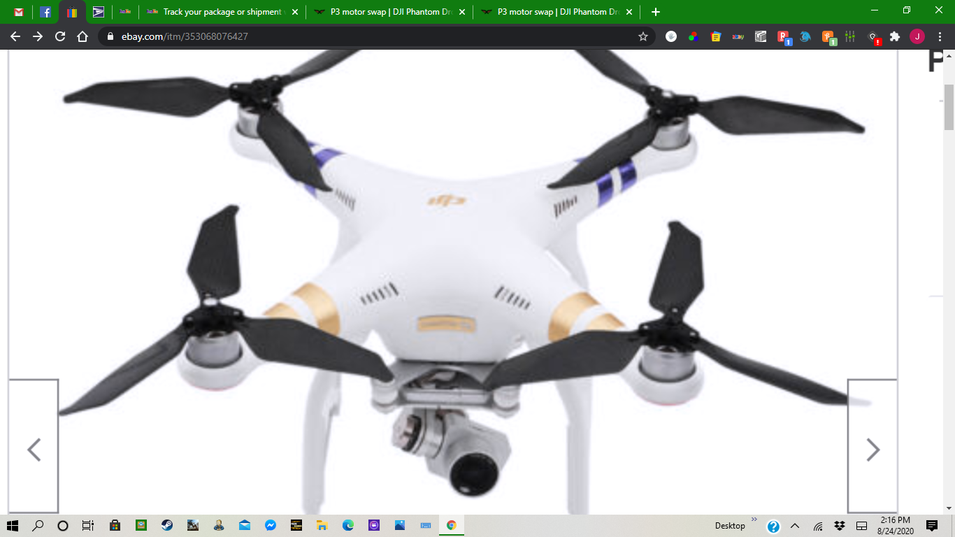

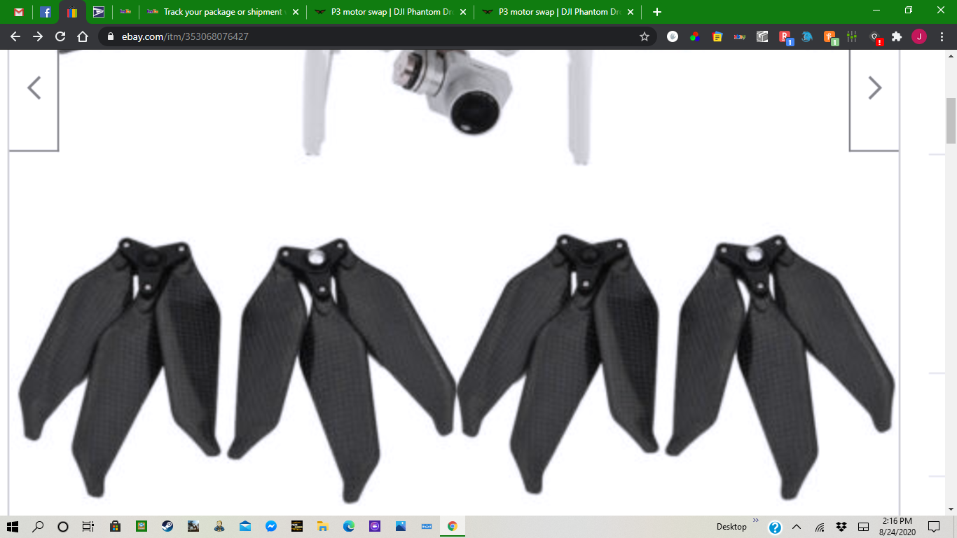

I will check them out. Are they supposed to increase thrust and payload? If so how much?
Thanks

Have you had time for testing? If so how did they do?
Yes I've had time to test them I usually get 15 minutes on a battery on my phantom 2 I flew for a whole 30 minutes on one battery & I did a test where I held my drone in my hand throttle it full throttle with both type of propellers three blade propeller did lot more Lift.
