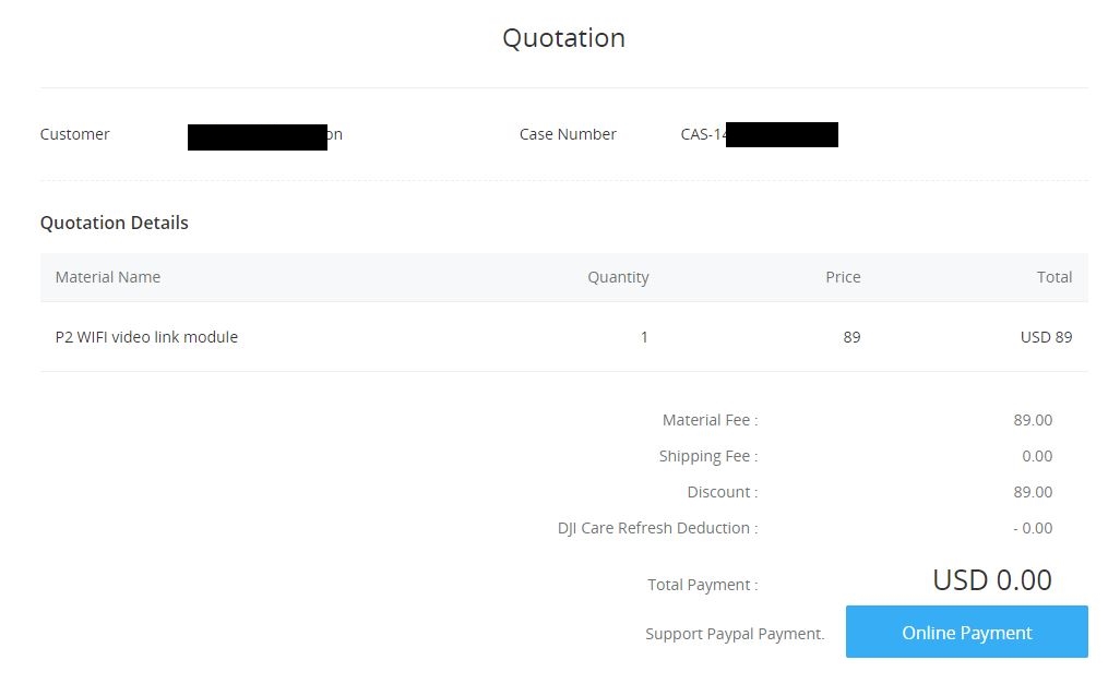

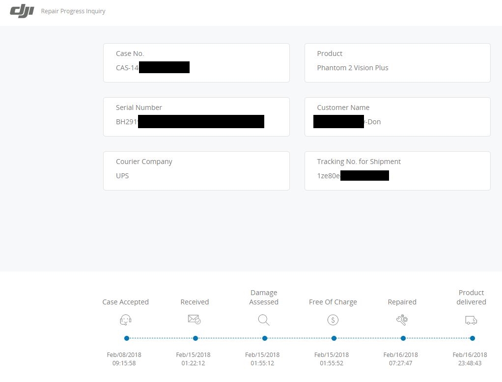

Couple of restrictions though, the bird can't have been disassembled before, and you must have the original Proof of purchase. I think it's awesome that they are standing behind the issue, since it was poor design. It's called the P2 Care Plan, google it. I happened upon it looking for a fix.
Couple of restrictions though, the bird can't have been disassembled before, and you must have the original Proof of purchase. I think it's awesome that they are standing behind the issue, since it was poor design. It's called the P2 Care Plan, google it. I happened upon it looking for a fix.View attachment 95347 View attachment 95348

Did you send in the drone plus controller or just the drone. I just started the process and it listed just the drone for return.
Thanks!
Sent mine in and DJI just quoted me 320 bucks to repair. How are people getting DJI to actually cover it under the P2 care plan?
Hello, There is a survey form to fill for a warranty claim for the video loss.
P2 Care Plan Survey
Something important. For you and everyone to send P2V+ to DJI Cerrito, California.
I sent mine complete in original box, except batteries as instructed by DJI support Team.
I packed it properly for trip protection. Image attached here.
They sent me a label for UPS Ground Courier.
I sent it. I did not make a written inventory.
They received the box. Processed. Repaired. Sent me all informations during process.
They were always very friendly.
