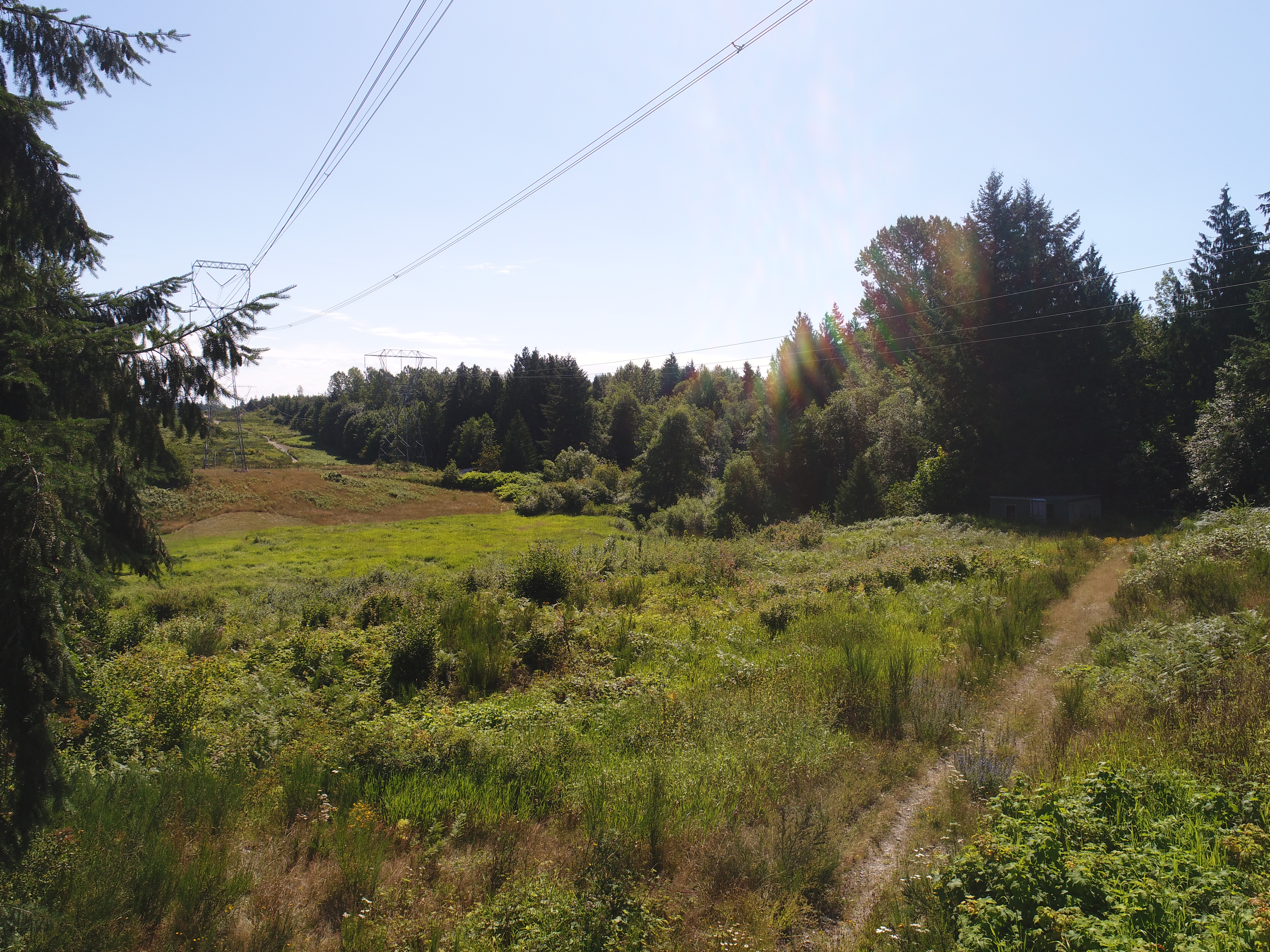

I frequently fly 200 feet above high power lines near my home with no problems. However during one previous flight, my Phantom 4 did a RTH and flew almost in between the cables coming home. I had my RTH altitude set too low and didn't realize it until I watched the video showing how close I came to the wires. I don't know the voltage involved but these are long distant transmission lines supported with towers, not simple utility poles.
By not experiencing any negative effects, I would assume that the Phantom's on board receiver is pretty much immune to interference from these 60 Hz lines.
