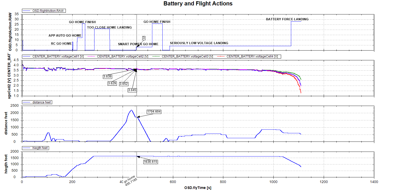

If you look back at the chart in post #10, RTH was transmitted to the AC. The theory being that since the AC was at the max allowed altitude, and the throttle apparenty stuck at 100%. The AC could not initiate the return. RTH is very slow, and the high rpm's could not be reduced to allow the return at that altitude with the stuck throttle. Even being that obviously it was far above the set RTH altitude by the OP, the aircraft will not try and descend to RTH altitude if it is above that point per the way RTH is designed. That's what I am suggesting. Even if RTH had worked, it would not be able to descend to land. Those are my thoughts.

That is a distinct possibility, under normal circumstances shutting off the RC will result in RTH. It should stop the climb at that point. I would have to go back and look at the altitude settings to check where the AC was when RTH was commanded, but if I recall without looking, I believe he was too close to the home point at those times, so it would have landed. Your suggestion would be be quite viable assuming that this "stuck" RC throttle is indeed true, but the only way to confirm without a doubt would be to see the AC .dat. But obviously that is not likely to happen.

They all will react the same. But my primary point was, this aircraft was at the MAXIMUM altitude limit at almost 2000ft and could not fly higher, although it appears it was trying. Here is another chart, I didn't put up before but you can see the RTH actions and Low battery RTH actions in comparison with the battery levels and altitude.
