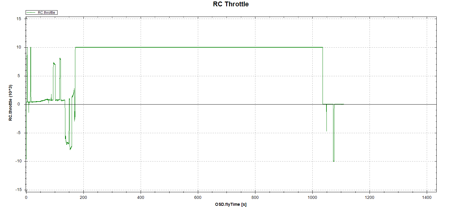

At a quick look, It appears your RC throttle was stuck at MAX for quite a long duration, but recovered near the end. I am just putting this up as a reference for the moment.
Wow, would this mean that my controller somehow malfunctioned? As you can see from the video, we had the throttle on full descend and it wasn't responding.

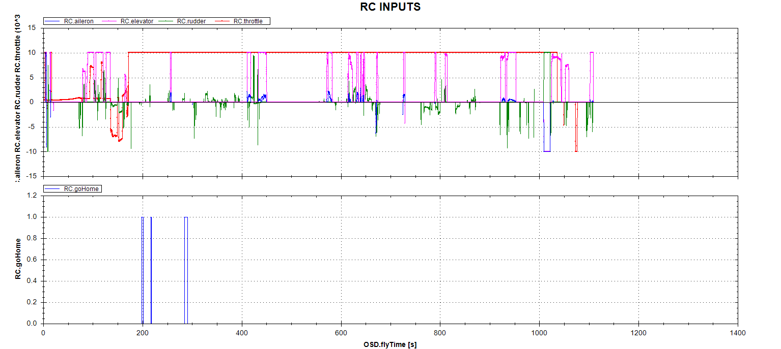

As shown below, all of the RC controls were responding apparently with the exception of the Throttle which is odd because the rudder was. Your RTH commands were also transmitted it appears. ( I will have to look back at the distance from home, due to the aircraft will autoland if the RTH command is given too close to the home point.) Again however, assuming this throttle data is correct, and will ask @sar104 to look at this as well, the aircraft could not RTH because it was receiving full up throttle commands. Again, I need to look back at the timeline, but just from this it appears to be the case. As a note, it also appears that at one point the aircraft was on its way back home as commanded. Either you cancelled it accidentally thinking that it was not recieving or some other anomaly occurred.
This is interesting. Again, and as you can see from the video I posted, we definitely did not have the throttle in the up 100% position, so I'm assuming it's safe to say that something was malfunctioning? We tried everything we could think of at the time to get this drone to land for about 15 or so minutes.
That I am fairly certain even without the video. No one in their right mind would do such a thing on purpose. Just trying to look at some more of the data before offering any sort of conclusion.

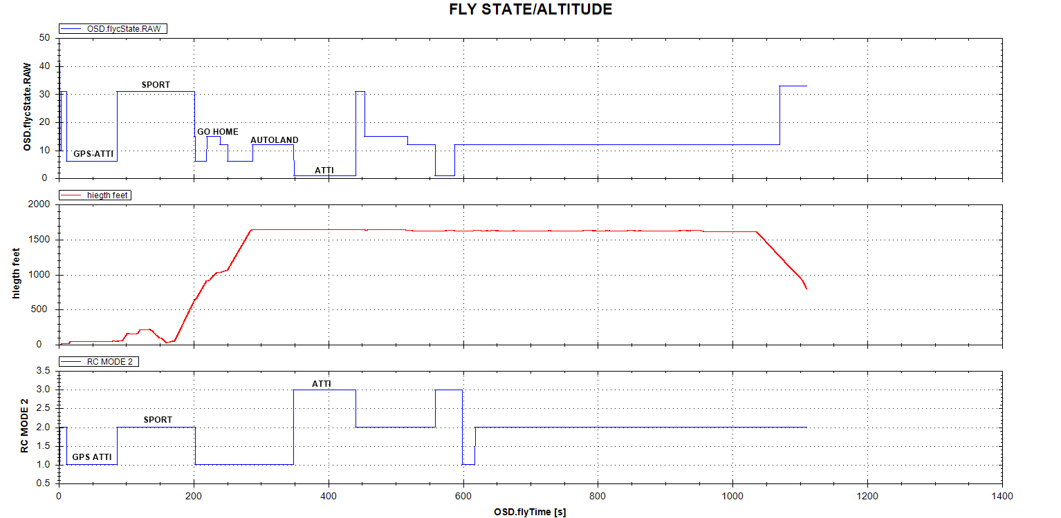

I am "almost" convinced that this was indeed a "stuck" throttle. Judging from all the other RC inputs reacting as they should. The chart below simply shows the states of the AC and RC vs the Altitude. The altitude remains unchanged until the close to the end of the flight. What is very odd however is that right at the end, the throttle seems to have recovered but by then it was only around 70 seconds until the end. I will assume that you were moving the mode switch on the RC in an attempt to get control. That is shown in the bottom chart.
We did switch the modes on the control when attempting to gain control back, nothing worked for us though and we never had control over ascend/descend. Does a "stuck throttle" happen often on these? Am I out of luck as far as DJI helping me because the drone is over 1 year old? I'm so upset because I don't feel I did anything wrong and now I've lost my drone.
Apparently that is the sad part. I don't think you did anything wrong. But if this issue is a correct diagnosis, and nothing is a sure thing, you could possibly still deal with DJI and provide all the data that you have. It may or may not be successful, but you have nothing to lose by doing that. Granted you do not have the AC but you do have these data files to utilize as a possible case. Let me ask one other @BudWalker for a third opinion on this. If we all agree then you have a good case, I would think. However, this could also be a case of some sort of "debris" interfering with the stick motion, but I think you would have noticed that.

I took a quick look. It certainly does seem that the RC thought the throttle was full forward in the interval [171, 1033] secs.
