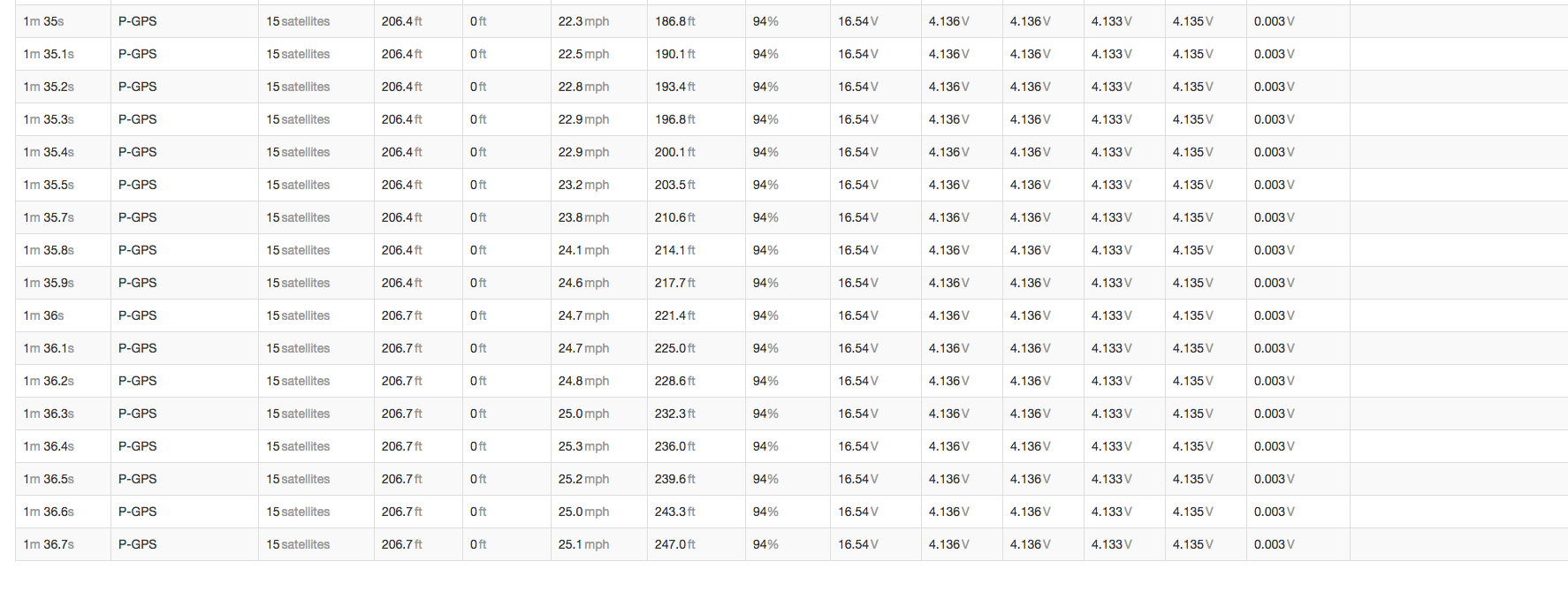

Reviewing the flight log, nothing jumps out at me. I'm attaching the last two seconds of capture. Looks like things were going great and then, nothing. Does anyone see something I'm missing as a newbie?
Thanks!
Angie
Thanks!
Angie

Quick look through the flight data and apart from you taking off before homepoint was recorded, nothing else. There are no flags in the file regarding loss of signal, RTH being activated, no compass errors or interference issues.
Seems like it went straight into a tree at speed for whatever reason......

The problem here is trying to match the incident description to the log.
The log stops with the Phantom only 247 feet from home (and well above tree level).
How/why did you say it was maybe 300 yards away?
If it was 300 yards away, it would be hard to hear any crashing.
The loss of signal is a puzzle.
It appears that there's no terrain or trees that could have blocked signal.
There's nothing up as high as the Phantom was to run into.
The conjecture about RTH is a distraction. - The Phantom was already well clear of the trees.
If the Phantom continued in the same direction, there's nothing to run into.

Hi, Meta! My mistake....I meant 300 feet, not yards LOL!. So, my estimate was about 50 feet more than what is shown in the log. You are correct. At the crash location, there were no trees or other obstructions of sufficient height to have impeded the flight path of my P4P. THANKS for the tip on the Find My Phantom feature! I will try that this evening when I return to the site.
