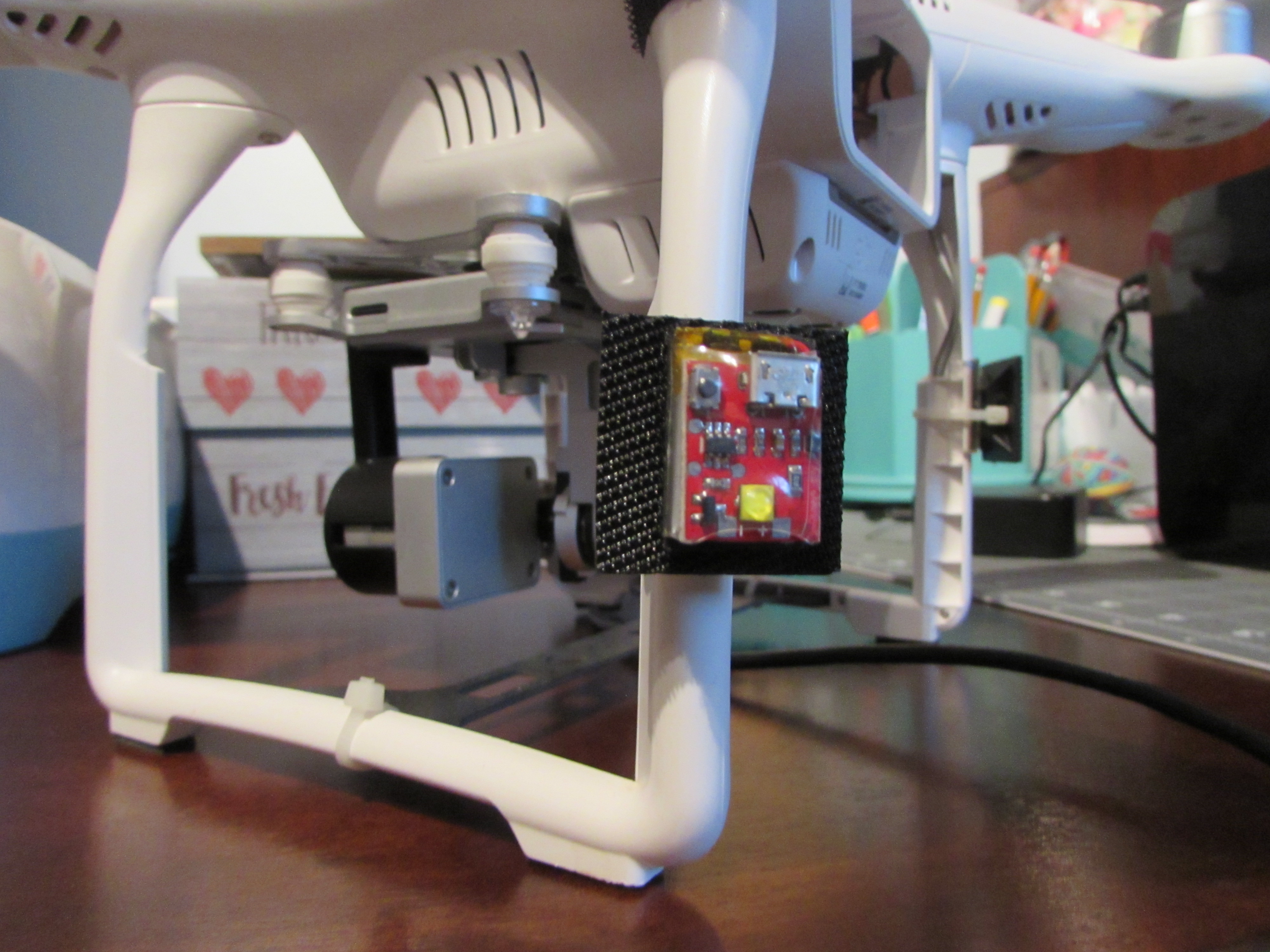

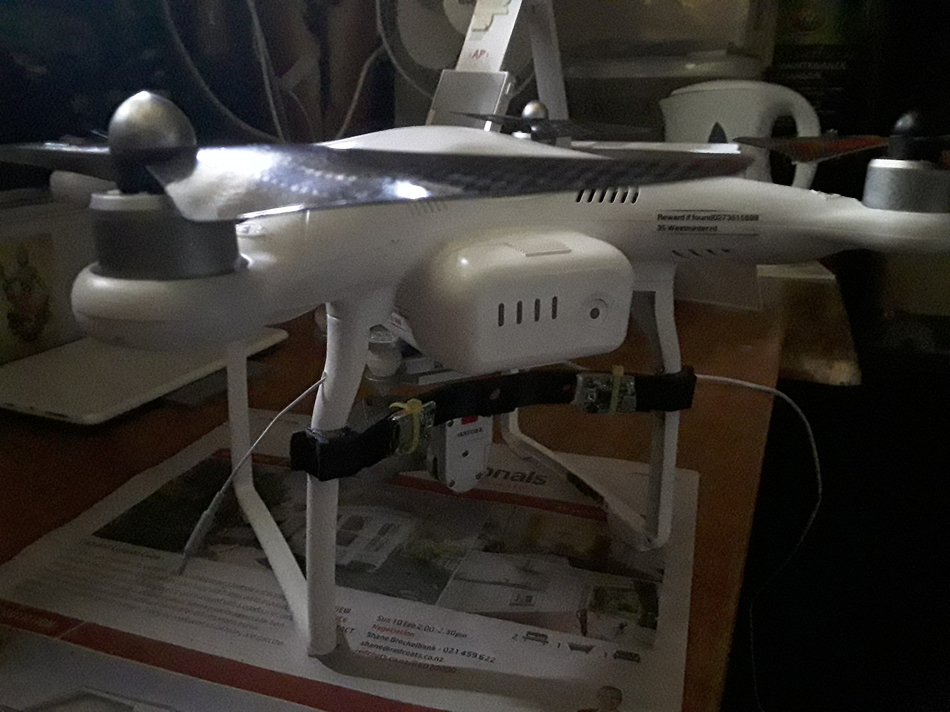

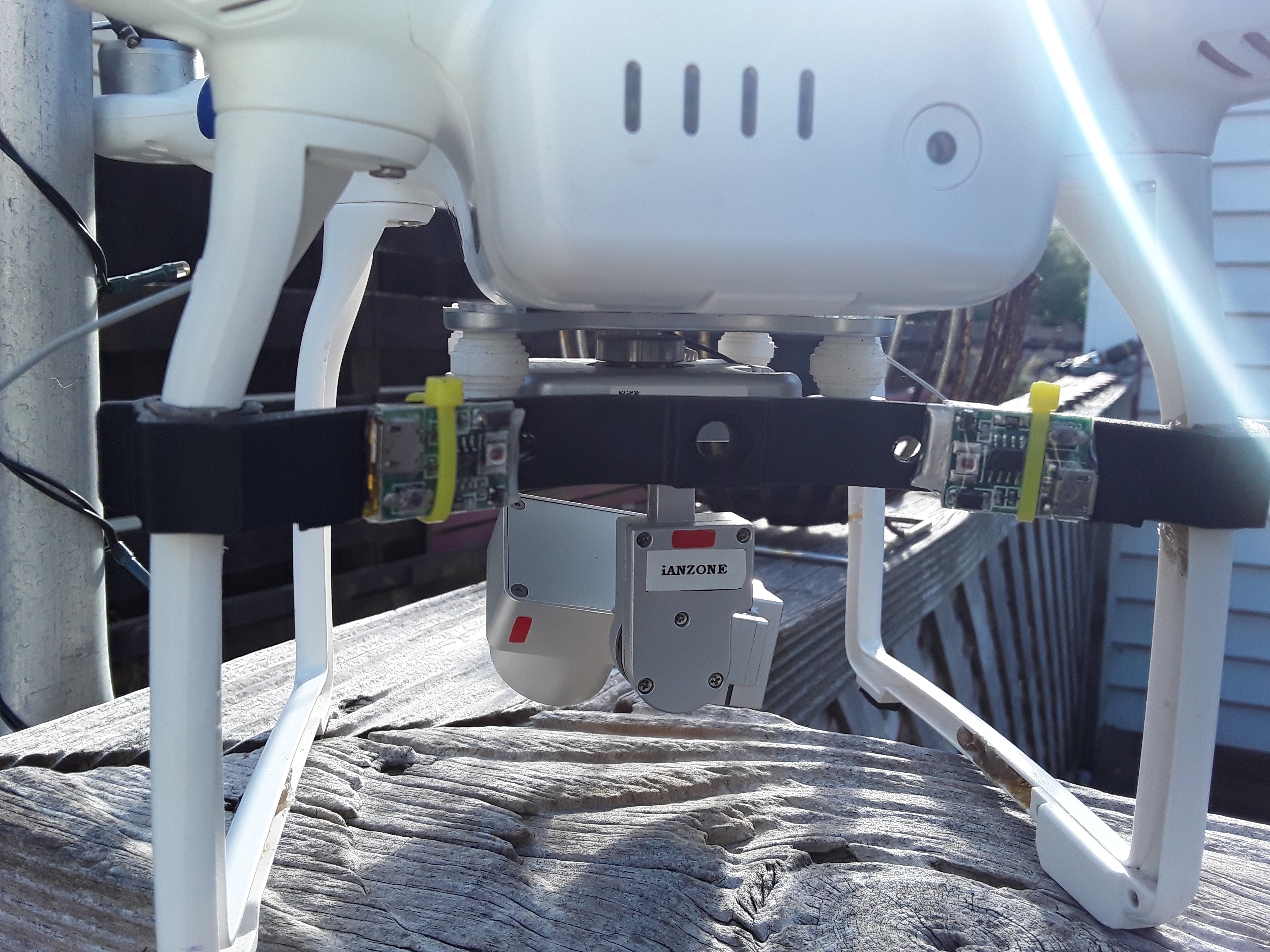

Been playing with lights again,used lumb cube holder with bit hot glue to secure it solid,this just one light flashing but have 2 on back,also drilled hole in each antenna leg so they come outside the craft ,not stuck behind the plastic which restricted signal,works very good

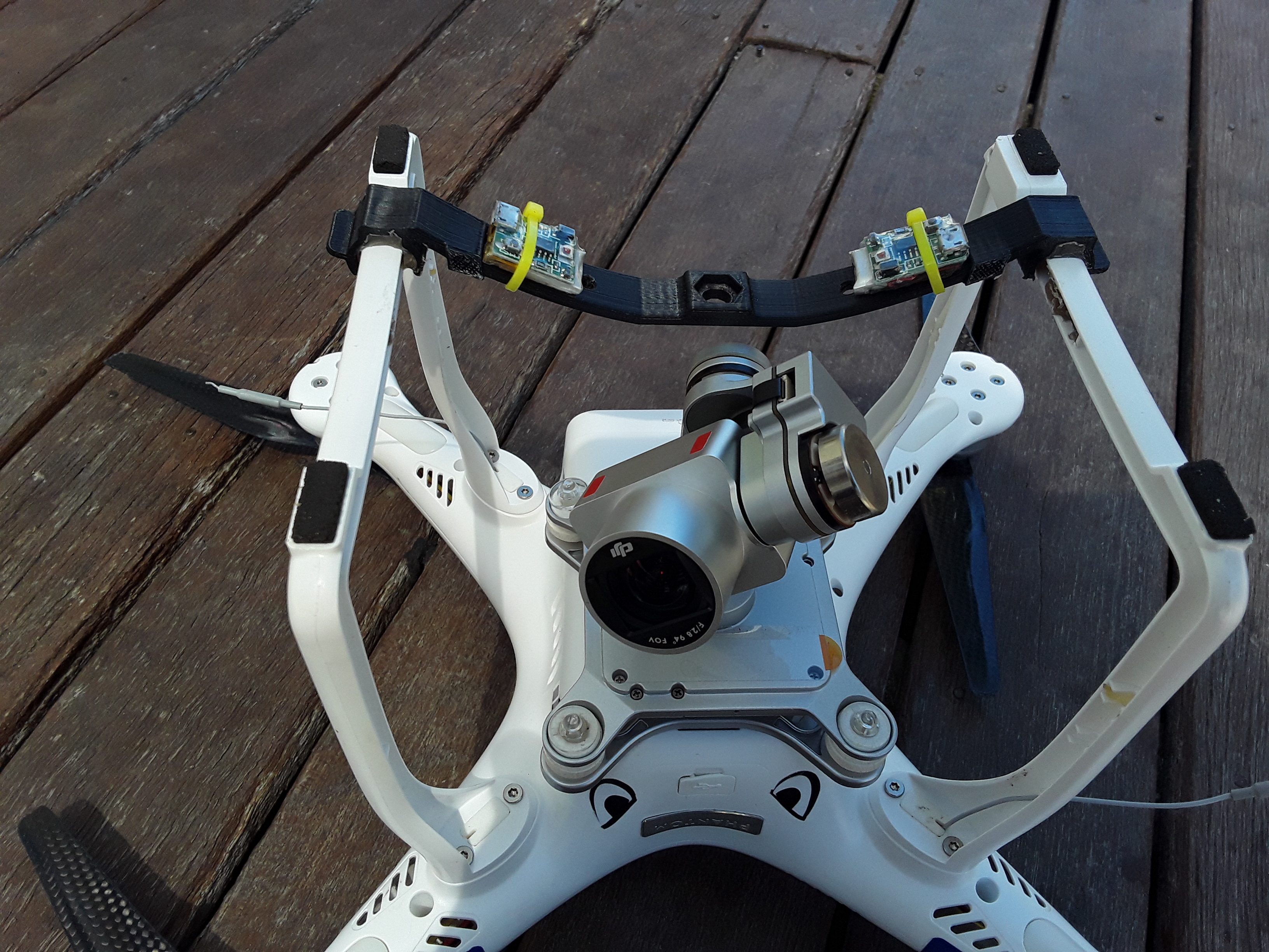

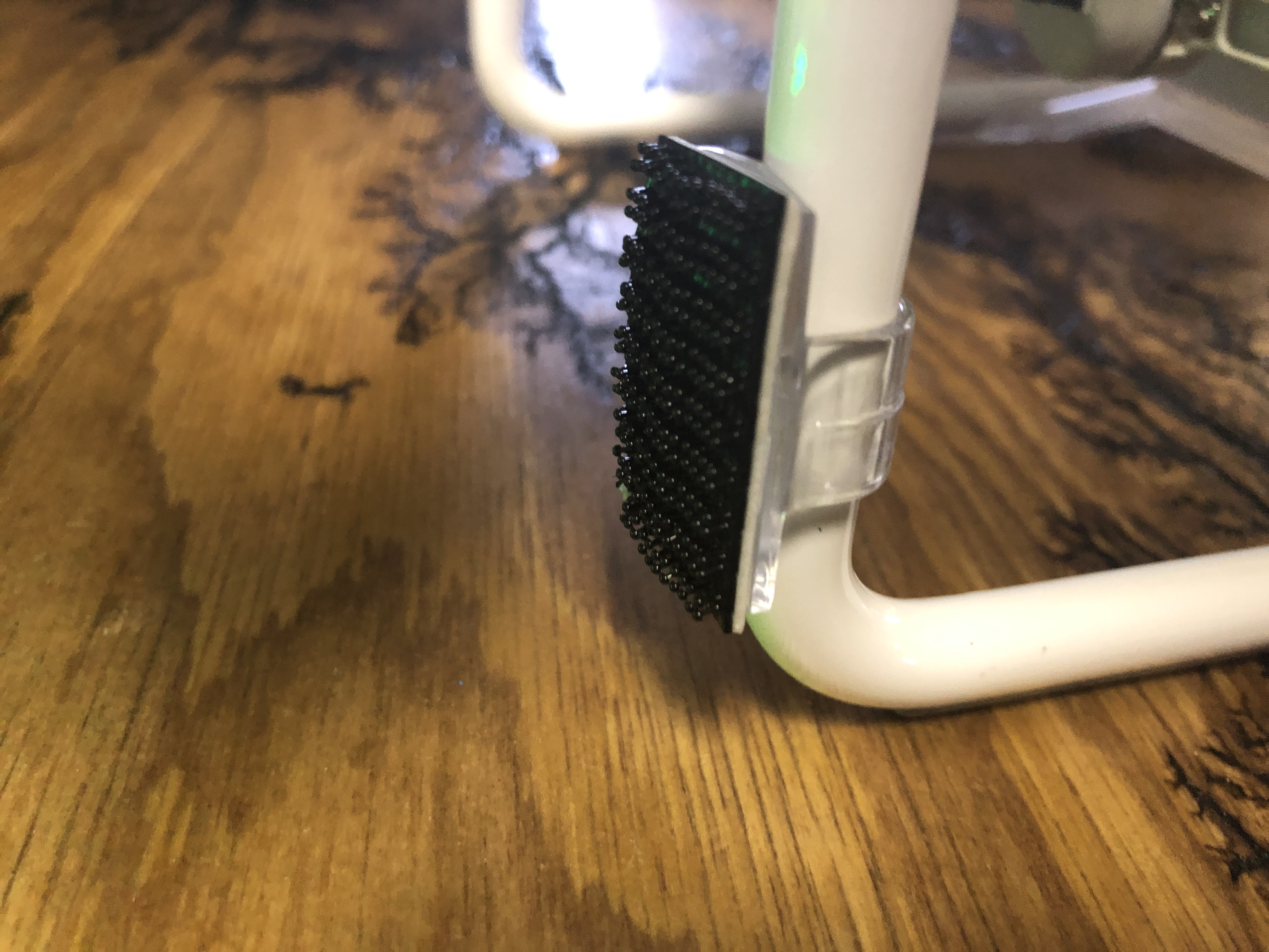

Similar concept, but much easier. Use a tie strap tie down with velcro. That's it. Been flying with these for quite a while. Signal is not affected at all.

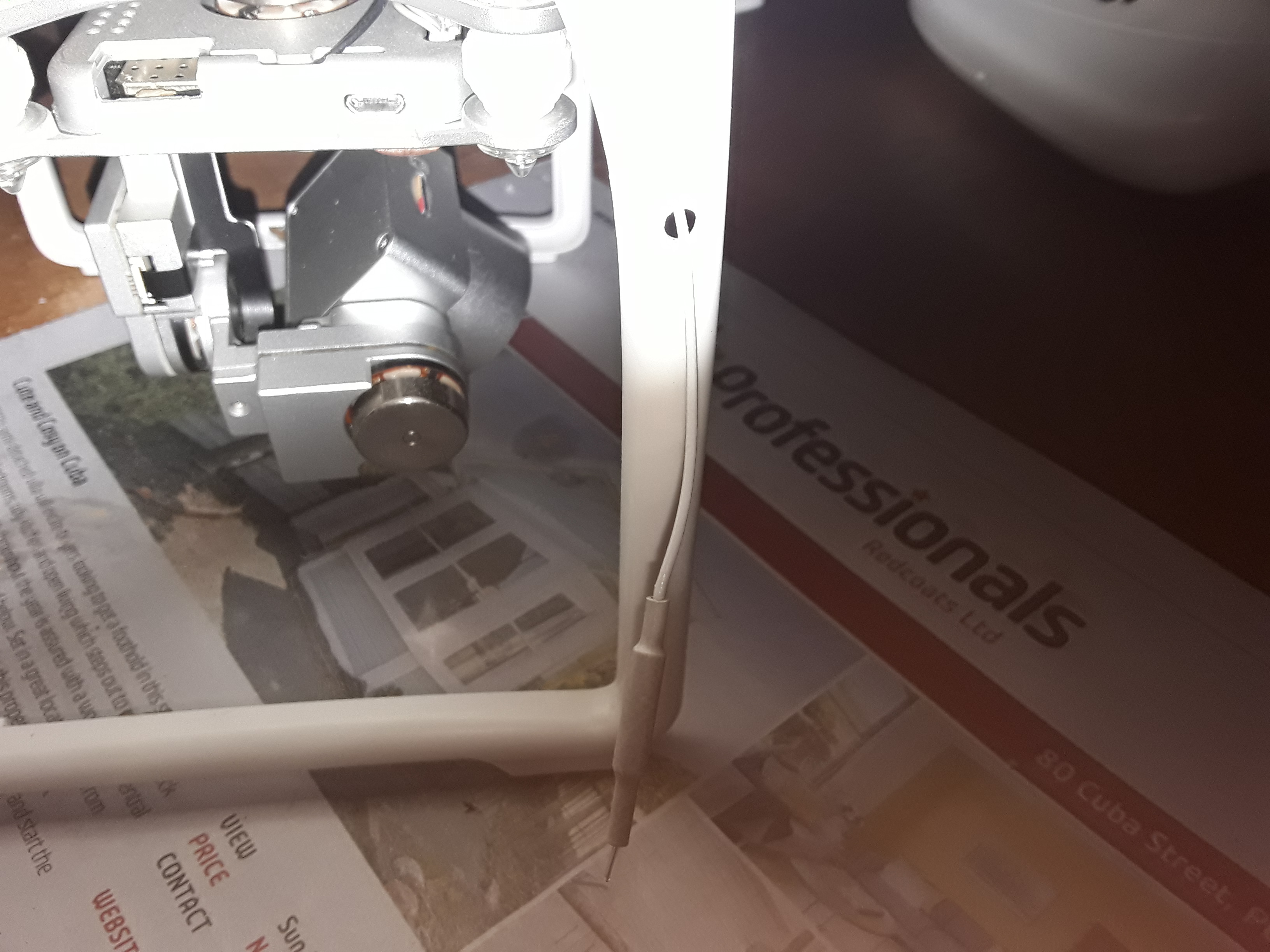

Wire out the side is my rear antenna, works well like this,,stores have built in 3.7 lipo batt with off on switch,I had these on p4 but since dead now I use on p3,,good in daylight aswell,yes have been blinded few times with these

Similar concept, but much easier. Use a tie strap tie down with velcro. That's it. Been flying with these for quite a while. Signal is not affected at all.View attachment 108453
Nice yes I have tryed velcro, these held with double sided car tape and cable tie for extra security, I had one full off in past,,...must add I had mine on bottom of feet but keept getting compass error,,once I move my error was gone

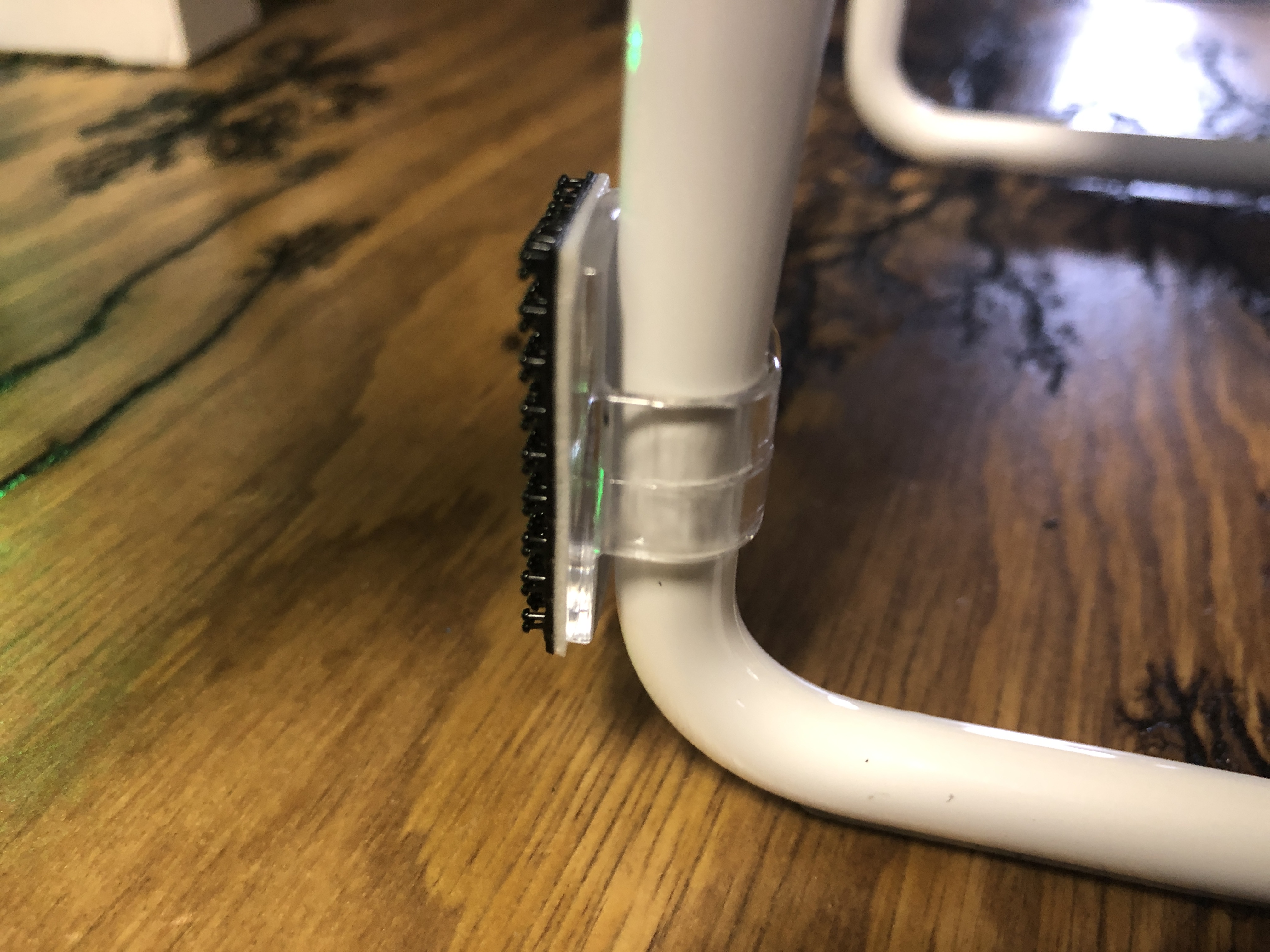

Well......the picture of my nice and neat lil very light weight and BRIGHT " LED light " should tell you all about it.
And about a hour and a half work off and on to make it... and its visible at least 2 foot ball fields away.and quite all that i really like to fly at OR really less at night.....the battery life is very good and yes that LED lite ONLY cost me $2.00 USD ( two US dollars) .
With no lens..it throws a lots of light 180 degs away from it.
And it's VERY VERY Bright !
It uses 3 LR 44 batteries and i can buy them at the Dollar Tree at 4 LR44s for one dollar per pack.
It uses "snap lock" velcro to attach it to the vertical landing gears legs !

Yes I was not happy and move mine again ,,to the feet this time,,they sit flush under feet still ,,
