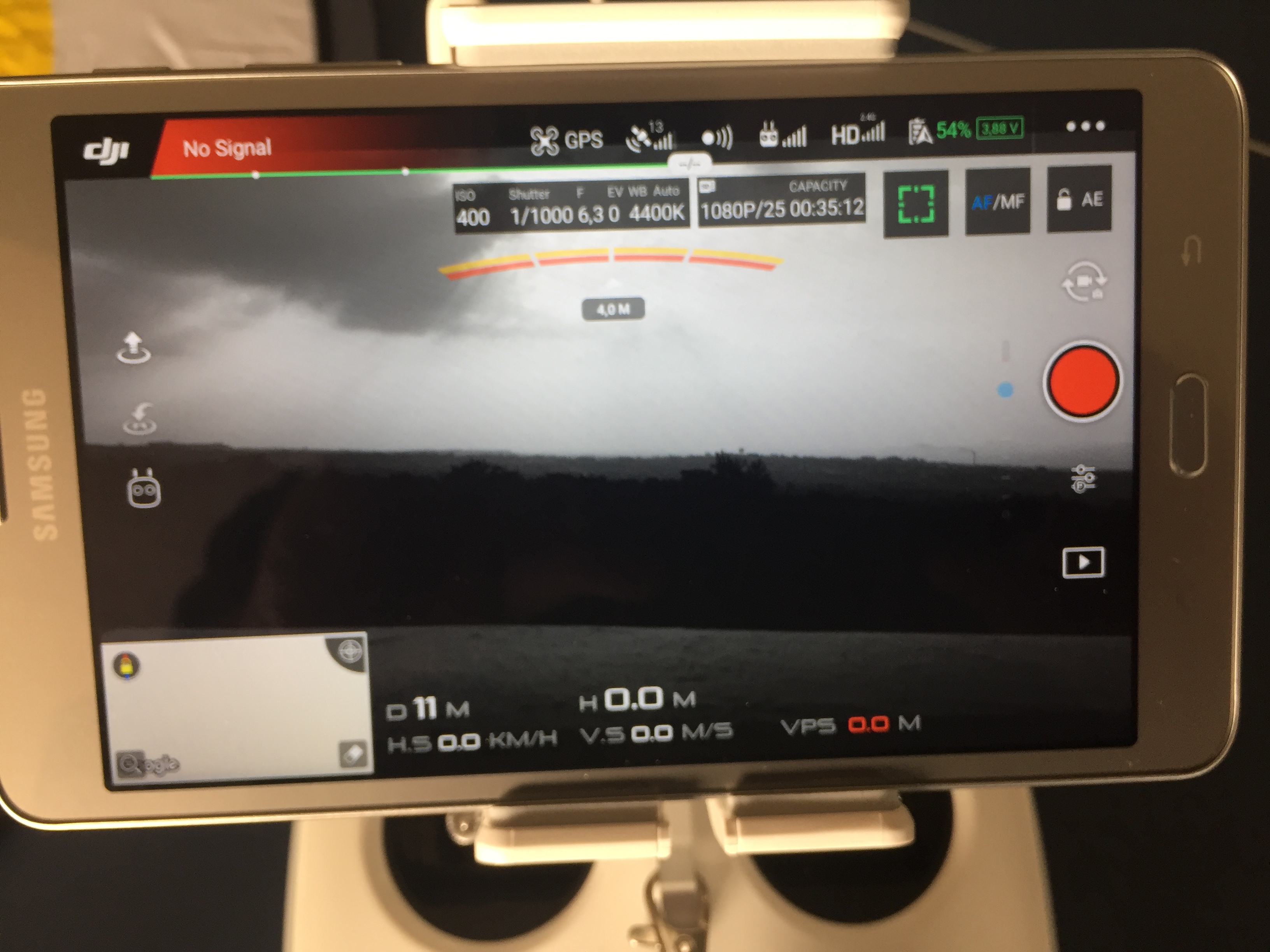

Hi guys.I am having a problem with my new P4Pro.When i start everything up it tells me on the tablet ( Gimble overload ) and when i toggle the camera up and down it does so but there is no live feed from the camera to the tablet and on the top left it shows NO SIGNAL.Please see photo attached and shed some light on this for me please.

Ok so problem solved now.There is a small rubber gromit holding the gimbal that we had not removed yet.All ok now.
