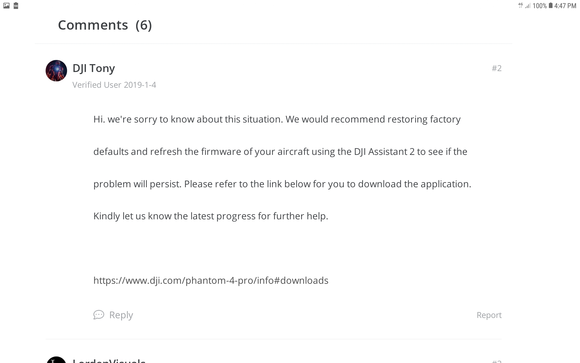

Ok I find this reply on other post with same issue,,could also be bad sensor on battery catch,,"battery sensor error "....I did Google search and a few came up but this closest to a fix..good luck

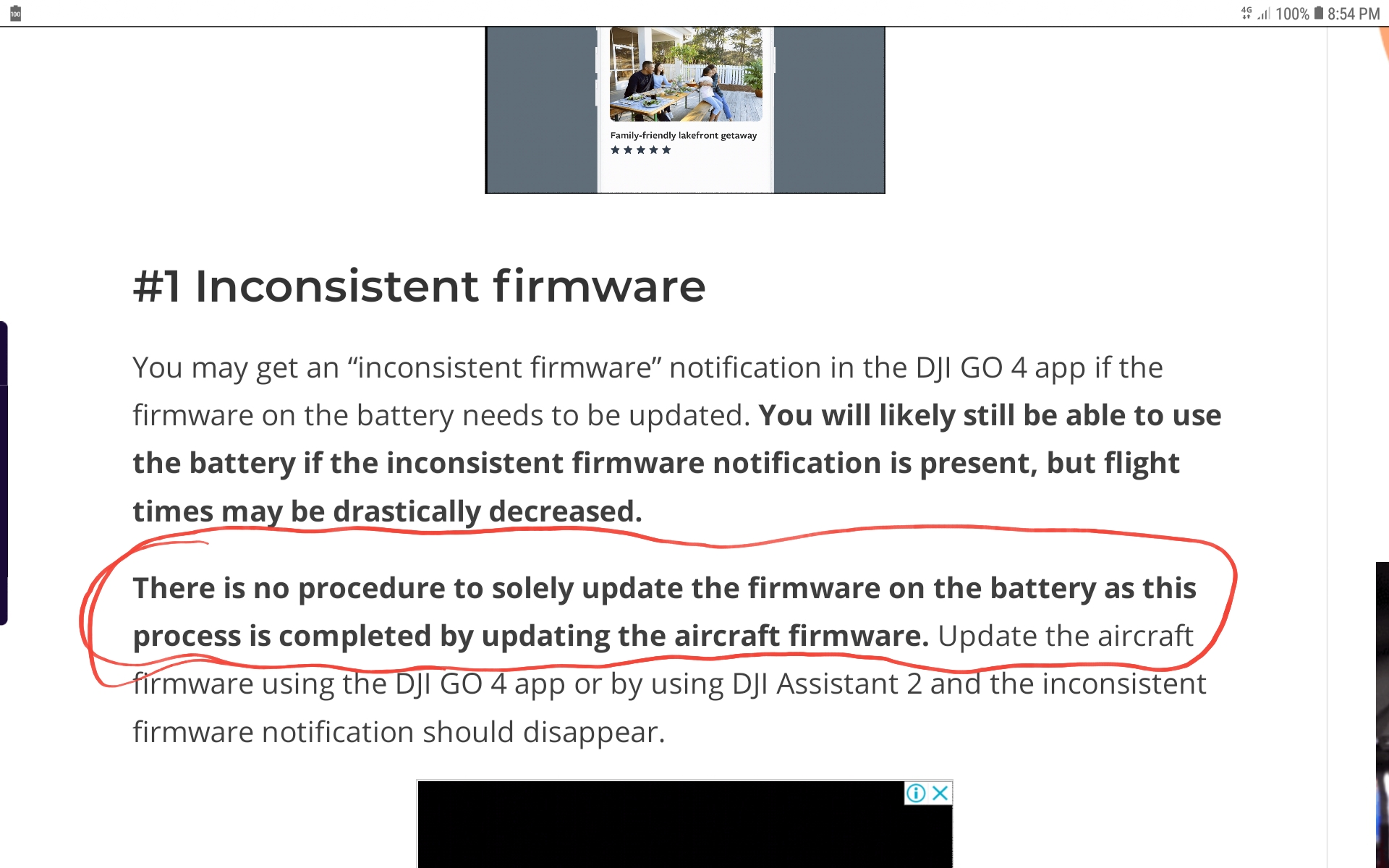

Yeh I did think at first a firmware mismatch on the batteries but after reading this bit I circle below.
I can honestly say all phantoms I have and have owned I have never updated a battery,,,I know during firmware update it goes through things showing a % logo when install in progress,,I can remember the battery being part of it,,I'm however not 100 % sure if this process updates any battery inserted in the future, and then again I've never had any prompts to update a battery so presume it's done automatically through software ,,I've heard of people updating there battery but it's always sort of stumped me,I got no computer so no assistant 2 in my books but everything works fine,,,so hanging on the fence about batterys being different if not updated and stuck in a p4 to fly,I've brought battery from stores and just charge and fly no issues..
I'm no tecanogical brain surgeon so probably not know what I'm going on about but I never updated battery,,
If I really wrong with this please inform me so I know what I miss out on lol
Bottom line it's just my take on battery update
Confused myself
4 batterys, and at throttle only makes me point towards esc or 3 in 1 board but this drone is a replacement, it's not out of the blue to receive a faulty drone,its happen before here ,I think you should upload that flight here and others that can read software graphs might be able to pin point what happen under power,,
