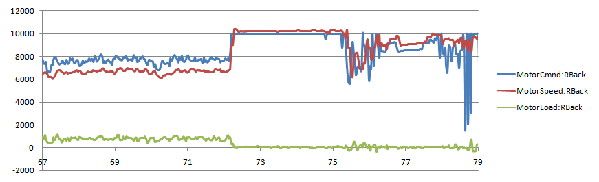

  8. BudWalker
    Jun 24, 2015
    1,099
    392
    Santa Margarita, Ca
    From the .DAT. Clear case of lost prop. But you already knew that.
    The RB motor shows loss of load (no prop to turn), both commanded and actual speed going to the max (trying to lift the RB)

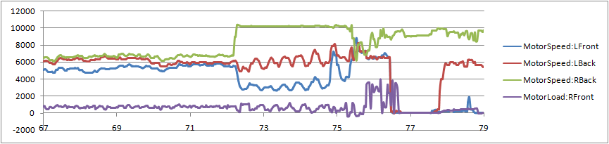

    This shows the speed of the other motors. The Left Front is reducing speed to counter the lost propulsion on the RB
