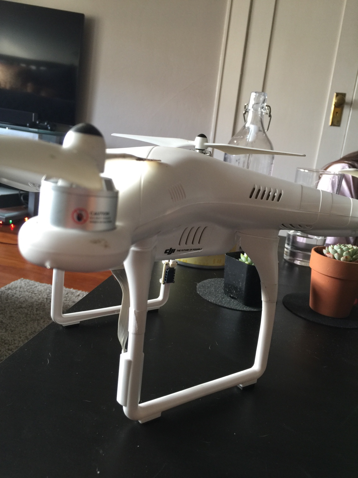

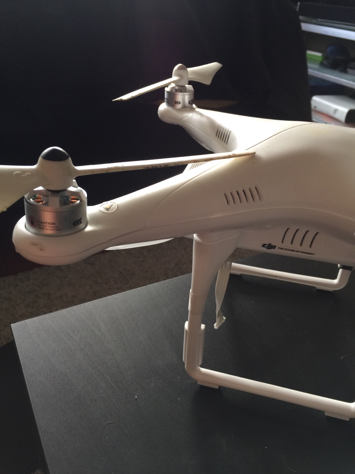

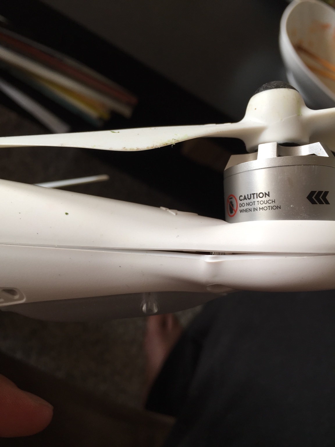

    Has this happened to anyone before? I don't want to power it up. Anyone have any suggestions?

    Start by rotating each motor by hand with the props on to see if each feels the same. Then to find out if you need motor or the ESC board take the props off and see if you can spin the motors up using the RC controller.
    The shell and any other parts can be ordered from B&H in NY. I use them because they are an authorized DJI dealer and do not inflate their prices.

    I also noticed that your quad looks more like a stripped down P2 non vision then a P2 vision + which comes with a gimbal and camera attached when bought. So what's up with that??

    I'm not sure why this was posted on the vision board, I apologize about that. This is definitely a P2 non vision with the h4 3D gimbal. all the motors work fine after testing this out. Looks like I'm going to have to buy a new shell... Have you done the transfer from the old to the new shell? Any manuals it previous threads about transferring the guts from old to new

    I had a simalar problem all I did was take an Emory board and sand the prop down a little to shorten the prop itself

    Yes I just trimmed one of the wing a tiny bit and it works perfect. Just ordered FPV too! Super stoked. Bird runs great
