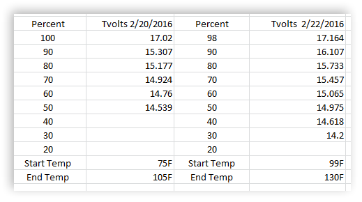

I agree, it's best to watch voltage, not percentage. Msinger's flight log view shows in spades the DJI "gas gauge" algorithm seems to be unreliable. At the same percentage of 30% or 50% the voltage can vary 1 whole volt (total voltage). Look at the numbers of my two flights, then look at the 40% comparisons to EmptyHassan's flight below. Considering the voltage under load ranges from 17 to 14 volts, 1 volt variance at the same percent level between two flight in the same model bird is a lot. I truly think the DJI gas gauge algorithm needs improvement.

Here's a recent flight summary of one of my flights shown below, using your "Log Viewer". At 30% it's shows a total voltage of 14.20V. That's a whole 1volt delta versus the OP's 13.216V at 37%. Then, look at his total voltage 10 seconds into his flight, 13.517V and 41%. Compare that to my 40% level below, 14.618, also more than 1volt difference. I'm puzzled why there's such a huge discrepancy of volts versus percent. I would think the percent level number is derived primarily from an average voltage level under an average load, but apparently other factors are in the mix.
