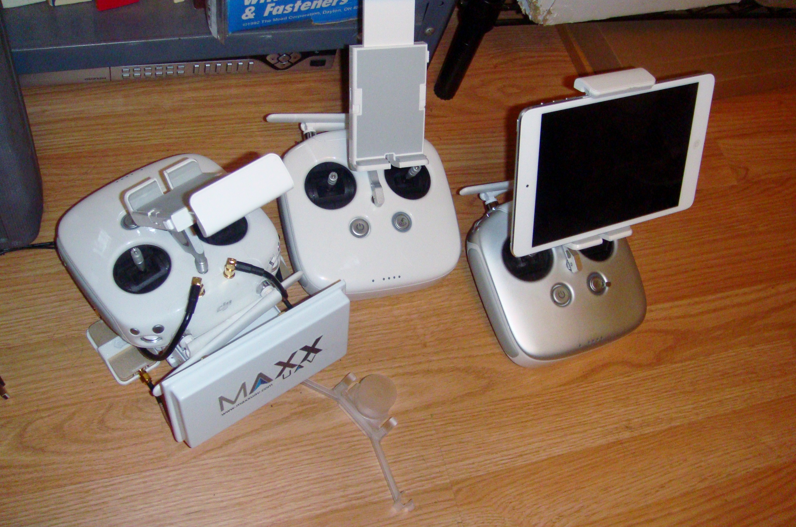

I have 3 controller now for two P4's, and will pick up another P4 when prices drop more. One is amped, and one is a GL300a., that I use for one P4. The Gl300a is easier to carry. The third is a Inspire controller I will use for the second P4. Now the question is why do I need four. I thought I could link two controllers to the same drone. No can do. As I tell people, I am smart, just not real smart. I prove that to my self every day. That is why I like it here. Some very, very smart people.
