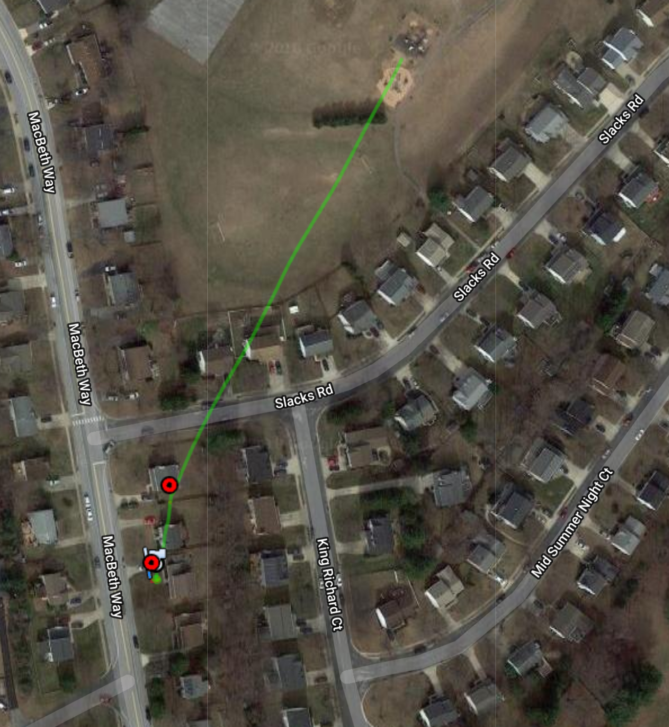

My P4 vanished
It's possible that the uplink remained good, in which case further stick inputs could have been acted on but the log would not have recorded them. However, the sudden loss of downlink coinciding with sudden braking makes a battery issue more likely in my opinion.
The total power loss makes the most sense. I was in a rush to get it in the sky. Maybe i didn't put the battery in all the way. If a sledding teenager picked it up and took it home as a trophy, I have very little recourse. Correct?
Unless you can track it down - correct. You could post some flyers offering a reward perhaps.
Is it possible its on the second guy's roof?

Same data as the log. I'll bet a a kid picked it up. In which case it's gone.
Thank you all so much. This group has been incredibly helpful from research before buying 2+ years ago to battery issues a year ago. To this. Thank you all. I will update if I ever find it.

The drone never came home and my phone wouldn't reconnect with it. I have no idea where my drone is.
Very sorry to hear of your loss. I hope somehow it's returned to you. I had a similar experience and never expected to see my Phantom again. But I was fortunate to have someone find it and contact me so I could retrieve it. Which leads me to ask, was your contact information anywhere on the drone?

At 1/4 of a mile away and being 70 feet high amongst many tall pine trees there is no way you had VLOS of your drone and you said you were flying at 20 mph. That kind of piloting behavior will lead to many mishaps such as yours. Charge it to a lesson learned.

My bet is battery dislodged! If only one side of battery snaps in a sudden change in speed or direction will cause flexing of drone battery compartment and battery release causing power loss. Then if hitting a tree or something else before the ground battery will fall out. Happened to me! So also look for battery on ground and drone will be a few feet away. I do not know if this has been recommended but we should all put a document on our memory card with name address, phone number and or Facebook page and put info on battery with a permanent marker. I lost two cheaper drones and I know someone will find them some day but I did not have any info on them! Sometimes it cost a lot to become smarter at the way we do things!!!
