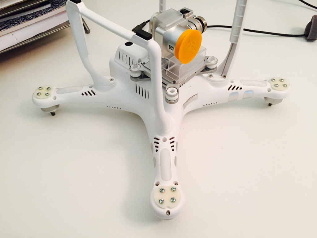

These are the plates I used. My cracks are only at the motor screws. I used them in case there is a complete separation of the motor from the arm. The cracks kept progressing so now it is going back to DJI for repair.
I have the set that covers the mounts and the 2 screw holes above the motor mount screws in your picture. Never seen these before, are they UAV bits?
Anyway, the ones I have seem to work. But I've also glue arm seems and installed. So maybe that's why....

These are my design. Phantom 3 motor mount reinforcing bracket. by Zoti
I used the one without the two extra holes because mine wasn't cracked there.
