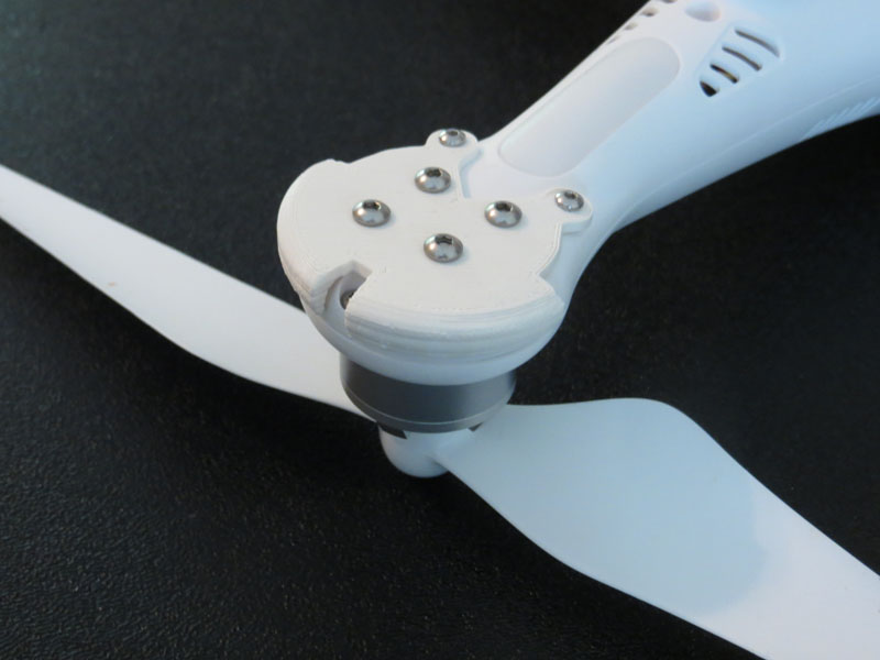

Zoti was using his own design, not the UAV Bits designed Strong Arm. We have not had any customers report new cracks or further cracking under our Strong Arm Reinforcement Plate. Our patented design couples all six screws to spread the forces out over a large area. The Strong Arm will be available in a more rigid material soon and a completely new design that makes the arms rock solid.
I will be posting an installation video on how to bed the Strong Arm for those that want a completely flush fit and maximum strength from the Strong Arm. I should have the new video up by Monday.

unless the plates fit 101% perfect i really cant see how they help, surely they must also be bonded to the shell to provide any sort of strength ?
That's what I was thinking. I bought the "StrongArm" plates kit, but haven't installed them yet (I'm not seeing any cracks yet, either). I've been thinking that the only way they could really work would be to bond them to the shell, before putting the screws in, then the screws would help clamp them in place while the adhesive cures, essentially making the arm end equal to "thicker plastic."

Following the latest threads and posts - I decided that the "strong arm" type of bodge ups - do not really help - they may delay but without some form of bonding to cement two surfaces of thin plastic ( poly) into one solid piece... the main arm support is still subject to the stresses created by the motor through the screws and heat the motor generates. I am no aeronautical engineer but it just seems common sense. Unless both surfaces are machined to fit without any space between them - they will act independently - granted there will be an amount of "grip" between two surfaces - but not enough to prevent the top plate vibrating.
I also think part of the problem is... nobody want to lock the screws permanently, so blue loctite or nail varnish is a bit like adding passengers in a car ( auto)( vee-hi-cul) the added loading may slow it a little but it still moves !
The real solution is for DJI to redesign the motor arm structure. I would suggest that as they have some very useful 450/500 frames the use the arms from them, or even rebuild the phantom on a stronger frame and wrap a skin around it!
I received the Strong Arm backpack plates last week and installed them yesterday. I haven't experienced any cracks, yet. And hopefully I won't experience any. Really, I see the Strong Arm plates as insurance to prevent a motor from flying off, should a catastrophic crack develop in flight. For the same reason, I have a gimbal protector.
I agree that bonding them would provide the most reinforcement but would void the chance of a warranty replacement if cracks develop. After a couple of flights these things seat really well and the combination of friction between the parts and the spread of force across the strong arm should help.
As said before it's a cheap option to give you a chance to save it if the motor comes loose. Not saying it would give you complete stability but you may have a chance to land.
