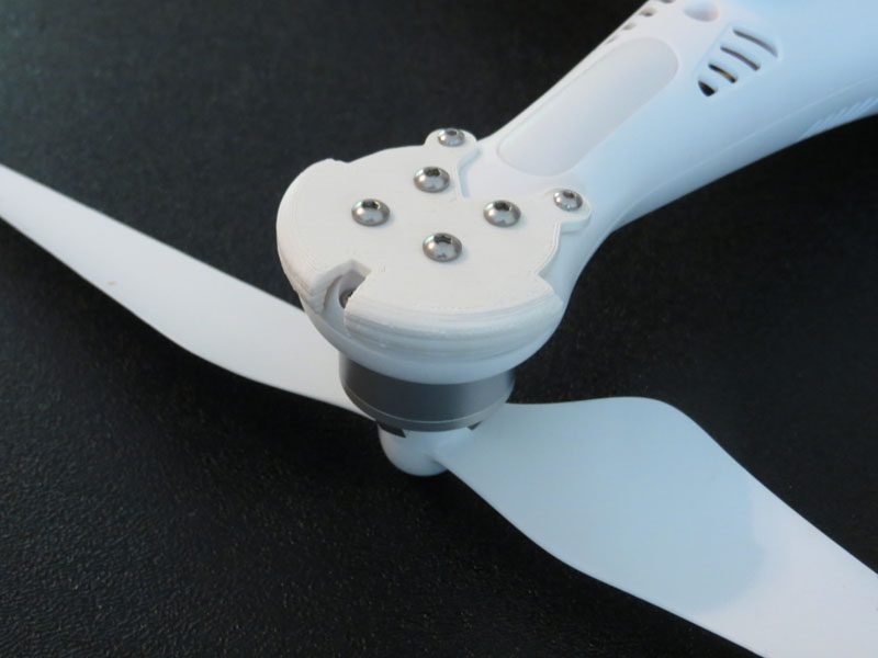

My UAVbits strong arm pieces arrived this week. Each bracket has 6 screws, not 4 as shown above. Unfortunately I can't install them because 2 of the screws in each arm require a really really special Torx wrench to remove/install the screws, smaller than T10 torx. I'm trying to get the correct size from UAVbits so I can order one.
The plates shown in post #20 above were self designed. The UAV plates have always been 6 screws as far as I know.

Zoti was using his own design, not the UAV Bits designed Strong Arm. We have not had any customers report new cracks or further cracking under our Strong Arm Reinforcement Plate. Our patented design couples all six screws to spread the forces out over a large area. The Strong Arm will be available in a more rigid material soon and a completely new design that makes the arms rock solid.
I will be posting an installation video on how to bed the Strong Arm for those that want a completely flush fit and maximum strength from the Strong Arm. I should have the new video up by Monday.
Now wouldn't it be wonderful if DJI would send a voucher to owners so they could buy your kit rather than waiting for another shell that is likely to crack.
