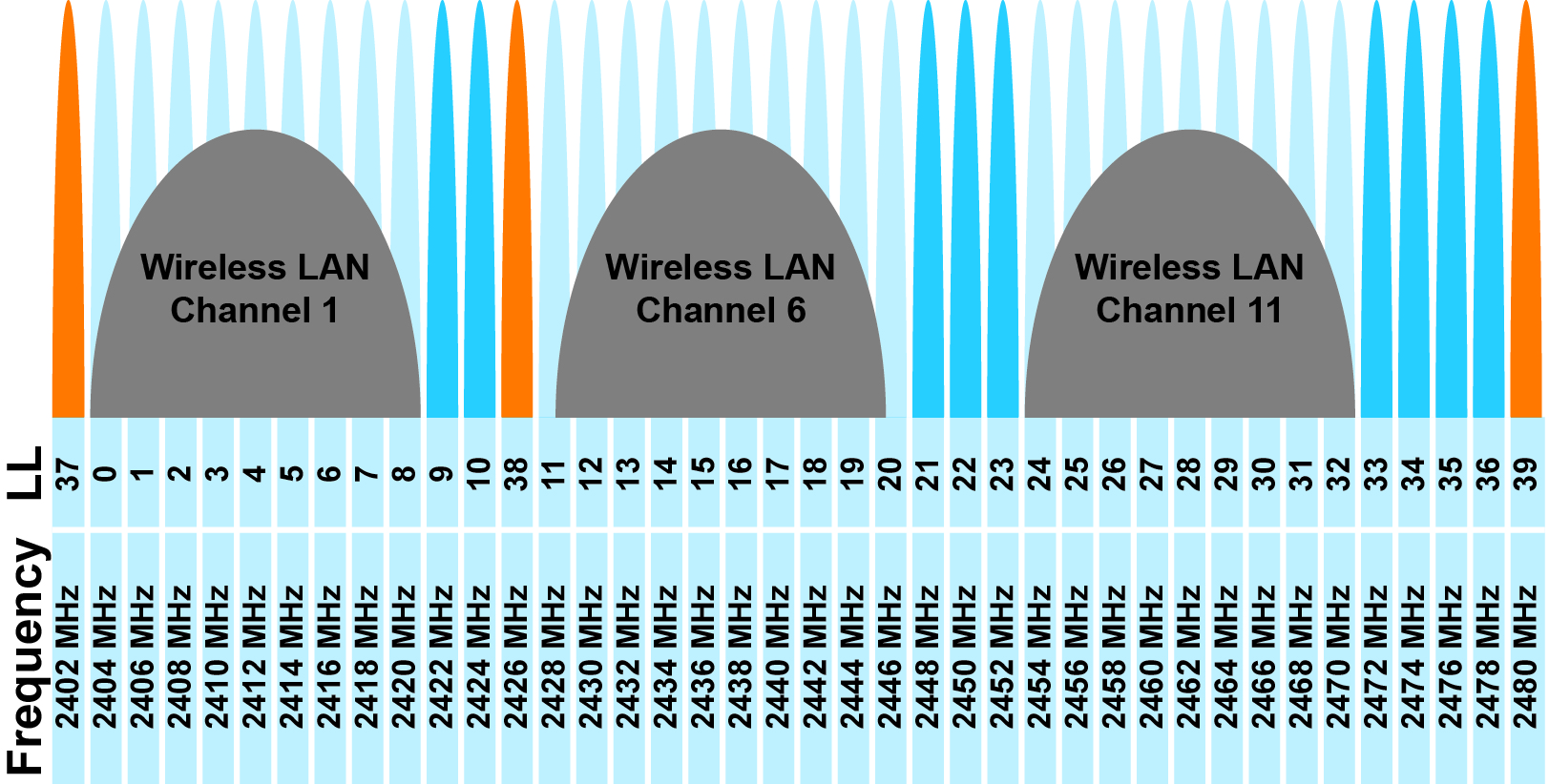

The config that you are installing is for RC only.
The system on the bird has a similar config but it is for 8ch only, so automatically it can't hop on all the ch of band AND it is the bird that start handshacking. If you plan to use 32ch extension you need to use custom settings with a fixed channel.
Going a bit technical TX/RX chips has 36ch, from 2405.376Mhz to 2477.056Mhz. Now DJI has a system that is 2 Mhz bandwidth channel spacing, and numbers are simply discretionary by the DJI.
The channel freq is : Freq (Mhz) = 2405.376 + 2048 * ( n-1) where (1 <= n <= 36).
This freq need to be in the ISM spectrum (FCC/EU will trash the system otherwise).
The DJI channels aren't the same as Wifi channels 1-14.
This render the idea also not stricly DJI Lightbridge channelization. As you can see Wifi and Blutooth are all jam packed in the range...
