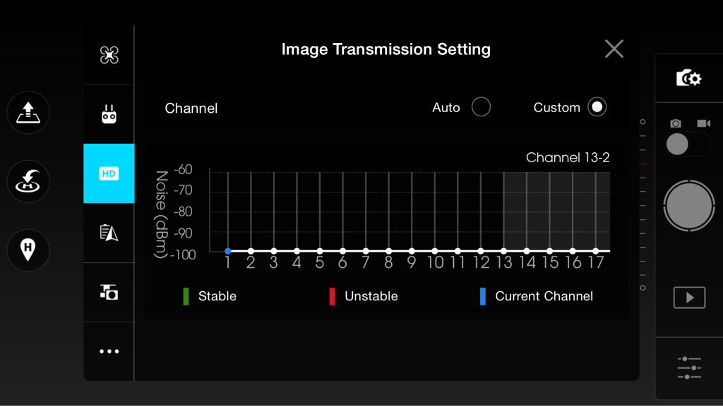

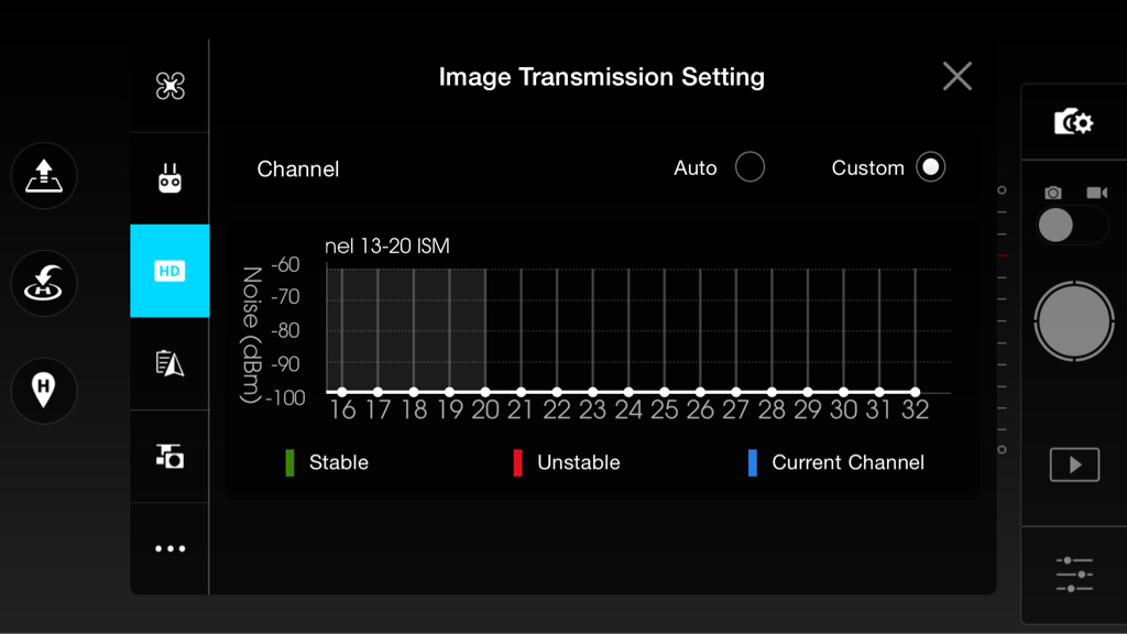

Thanks for the info. Got it to work on the DJI Go app on my iPhone 6 + all 32 channels are there but I couldn't get it to work on my shield tablet.
I'll keep on trying. I'm sure I'm not doing something right.View attachment 26742View attachment 26743
Is your Phantom powered up too? In that screen shot, it doesn't look like your copter is on.
No it's not powered on, so I guess I'm assuming it works because all the channels are showing ;) but will have to test later
