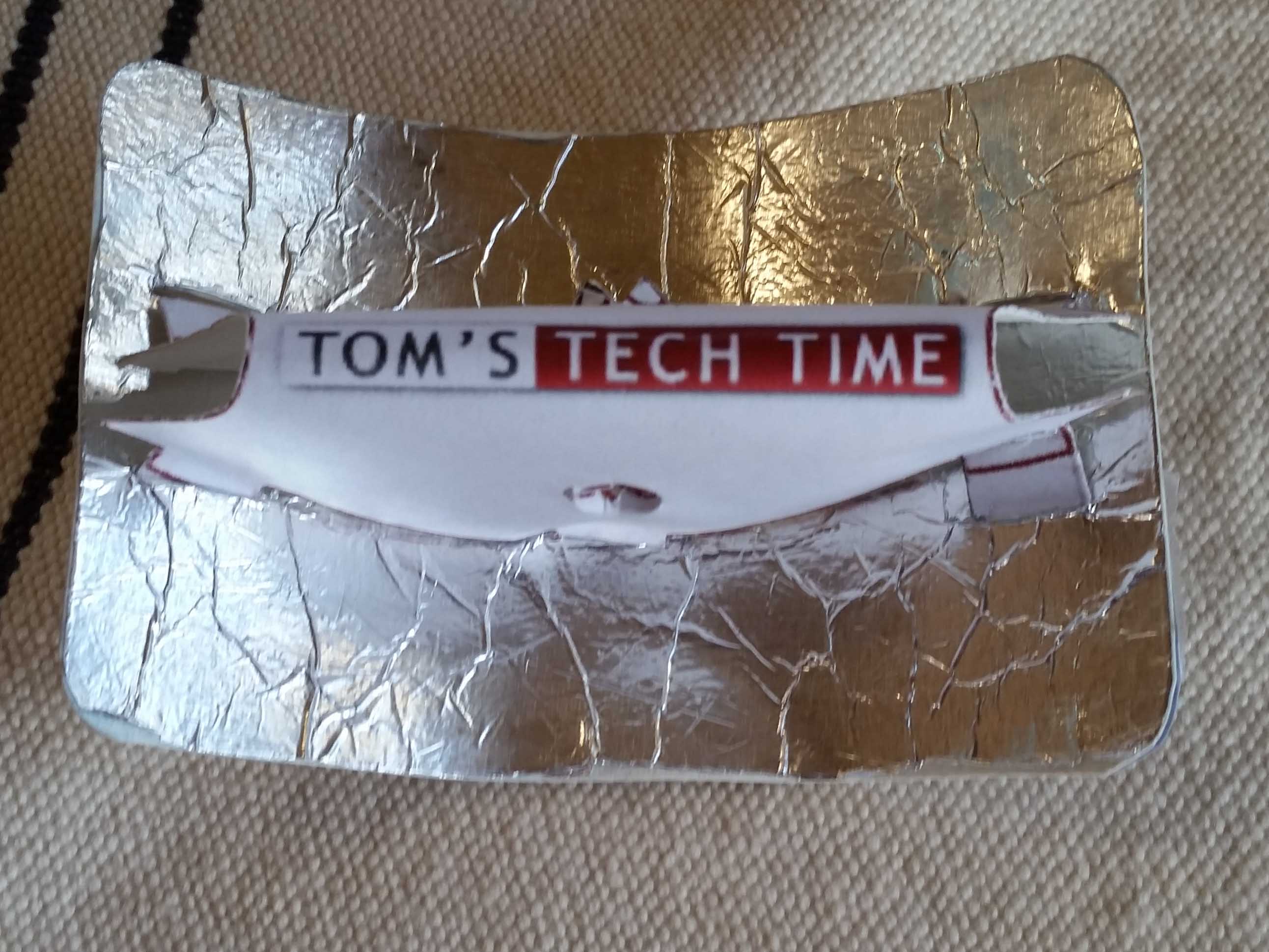

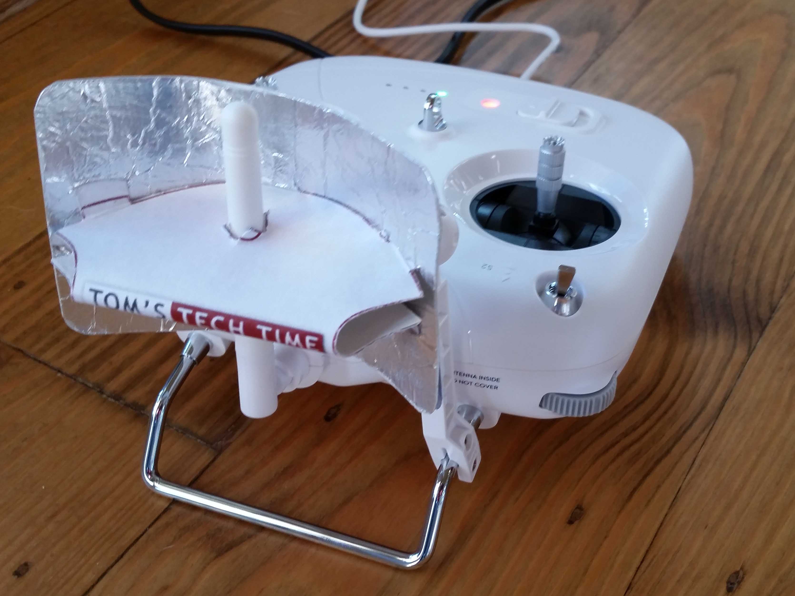

I know if you are a P3A or P3P person this is no big whoop, but I just flew my P3S to 1.45 miles (>7700 feet) before a weak signal warning caused me to chicken out. It was a mostly over-water flight with a 10 cent paper and aluminum foil windsurfer antenna.

I just built the cheap windsurfer out of paper and aluminum foil according to: antenna - Tom's Tech Time

Here are some pics of the antenna:
I just kept the antenna vertical and perpendicular to the aircraft location or parallel to the landing gear.

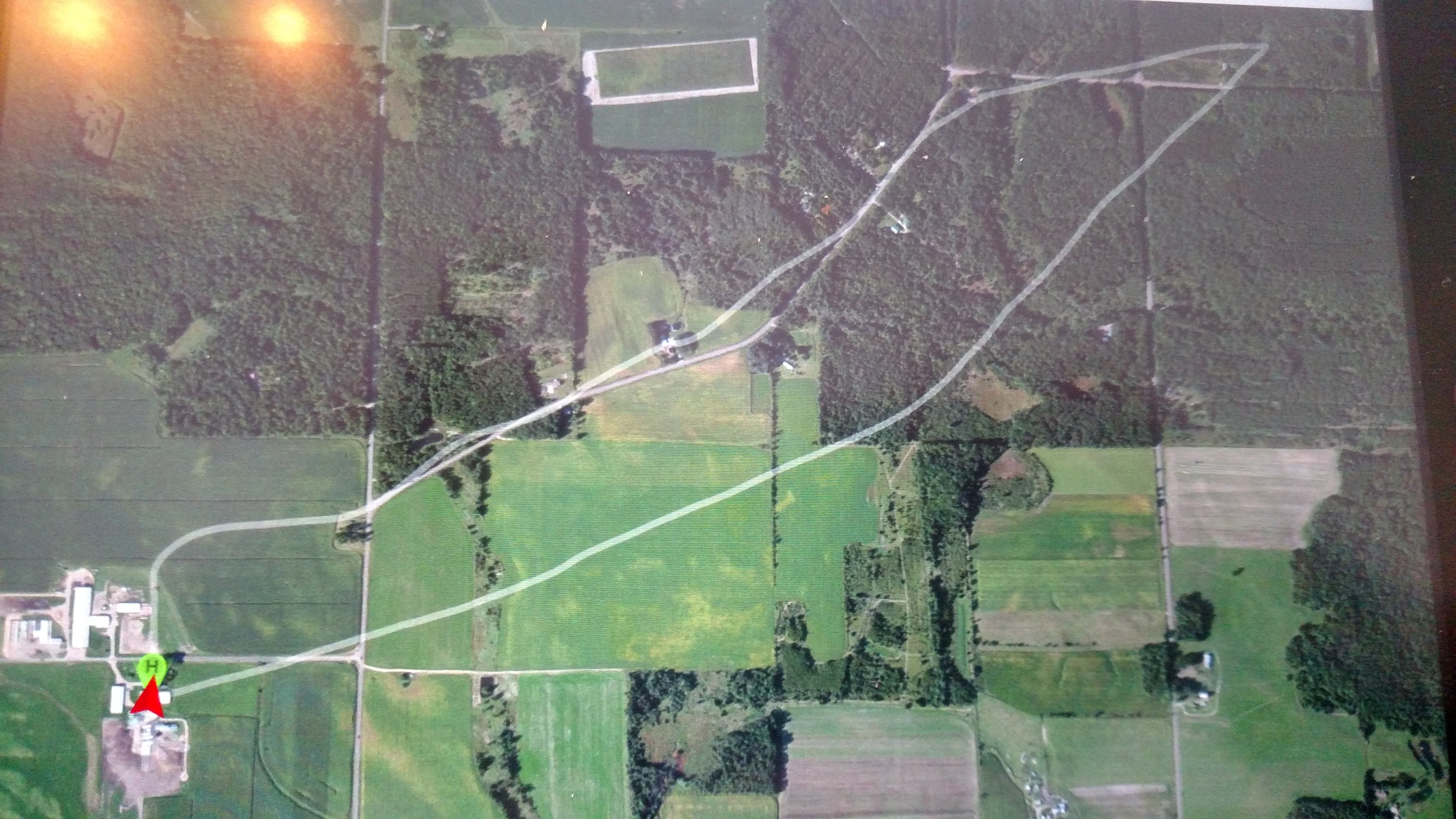

Pic of the flight map off the Ipad...and measured on google earth. Not exact, but close enough. This was just earlier this afternoon. I actually was shooting video, I was showing it to some friends. I all ready wiped the card, otherwise i could upload a video if you are doubting me. Ironically, as i was screwing around showing some people how it worked, i pointed the drone at us, and you can clearly see my controller is stock in the video. I can still view the video in the DJI GO app, but it says i must connect the drone to download. the drone is in my office, while I am back home. I wiped the card anyway, so doubt it would download.
Like i said, i can still view the video on Ipad....anyway to get it off of that? If anyone really cares or is doubting what i am saying. As I said before, i actually ran out of battery, not transmitter signal. It was getting weak, but hadn't lost it yet. I had flown around the farm for several minutes before going on this flight (obscured under the red arrow and home icon)...I was trying to get over the top of my Grandpa's old house, and i think i would have made it had i not run out of battery.

I went and flew the same route without the Windsurfer. I started to get noticable video and signal artifacts around 3000', and signal loss and RTH in the 6200' range. I didn't back off with this when I started getting the signal errors early like I did before, so I think the WS might put me out as far as 8000+.
