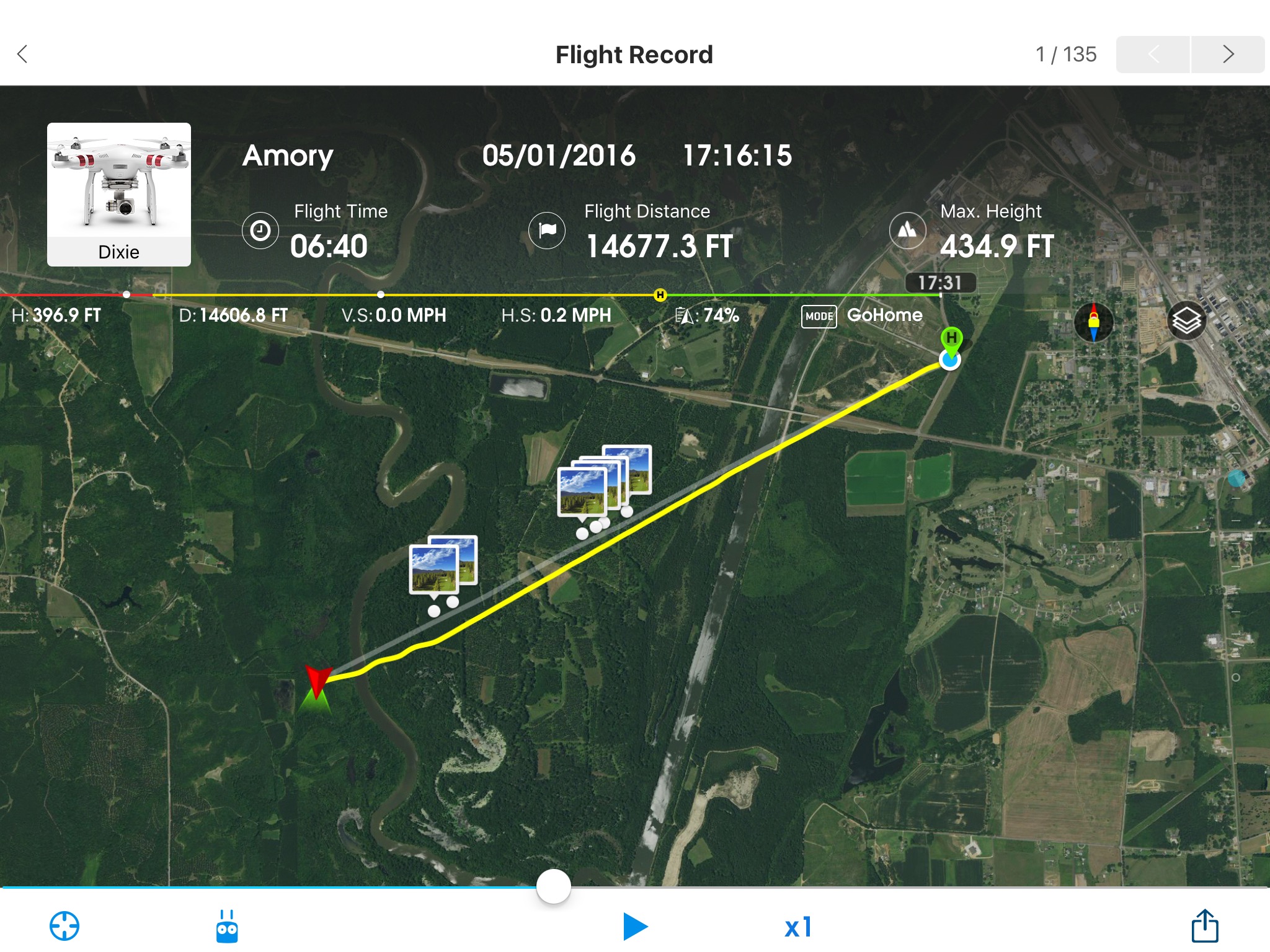

That is amazing man! Glad I haven't modded mine yet...if I can't see it it's too far IMO. Kinda scary. Thanks for sharing/testing comparison for us. I always seem to lose video feed first and then have no idea what is happening on long flights.
I was as anxious with that bird out there as i was when I first soloed in a Cessna. I know I wasn't at any risk, but I just don't have faith yet.
Get where you trust your RTH and you will be fine :)

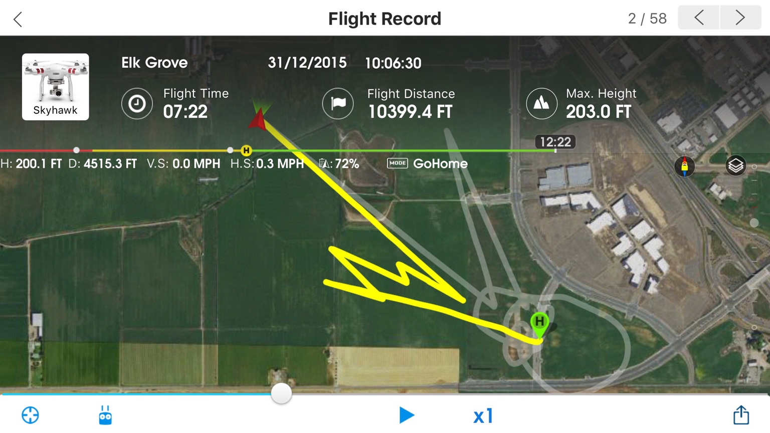

I have tried in a more open area as you can see but the best I got was 4515 feet. The cables don't make much difference for me. I tried both thin cables that came with the kit and the thick ones recommended by @dirkclod. I think I'll contact @DBS to see if there are solutions to this problem. It's just a bit better than stock antenna but not 2-3x like other members here. So do it at your own risk.

I have tried other open places already. But this has been the best place so far for me. I was basically flying away from interference areas. Right after the flight posted above, I managed to push it to 4683 feet. So I'll just keep trying and hopefully @DBS can help resolve it.
