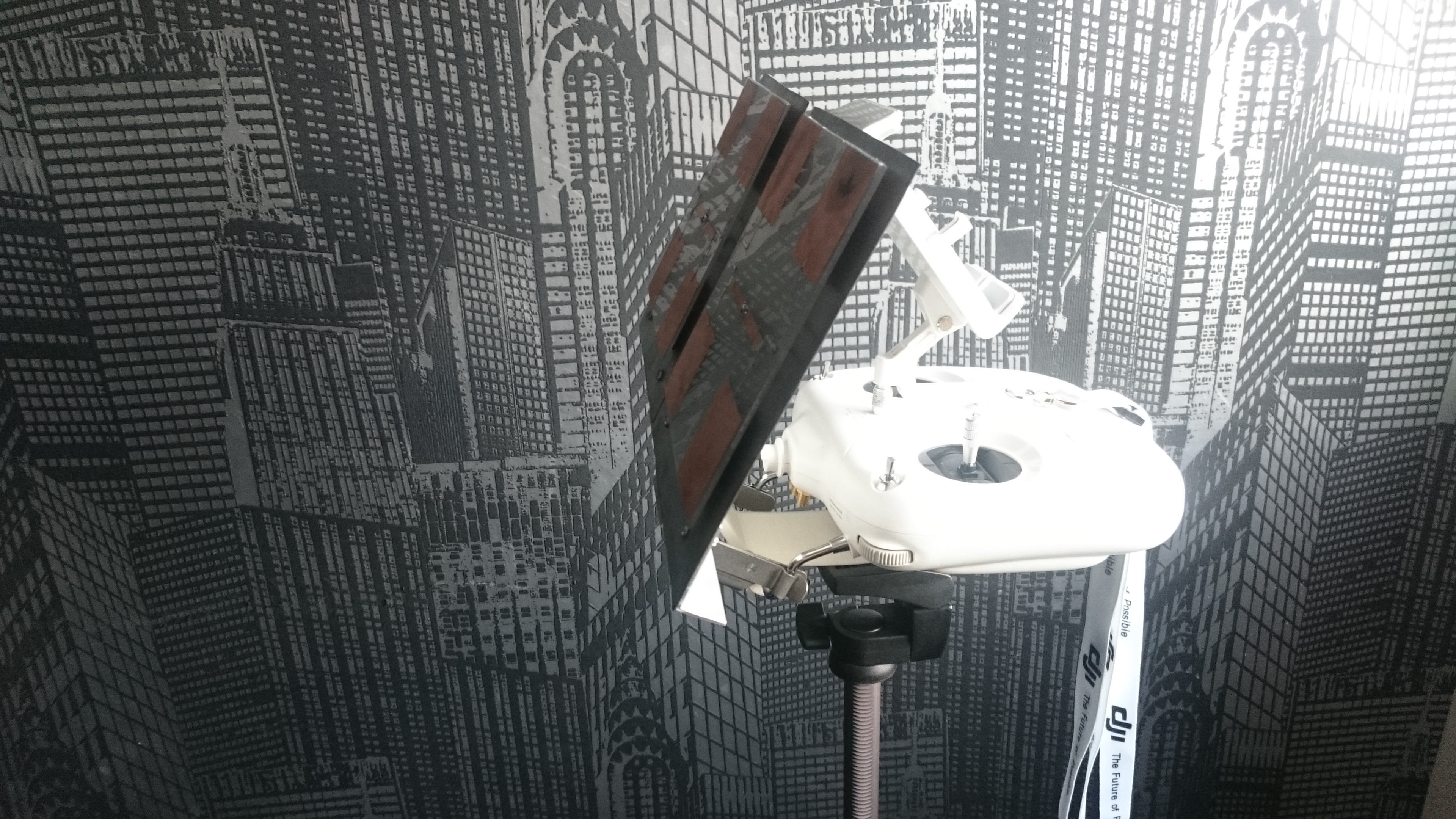

Here it is on the tripod with rc

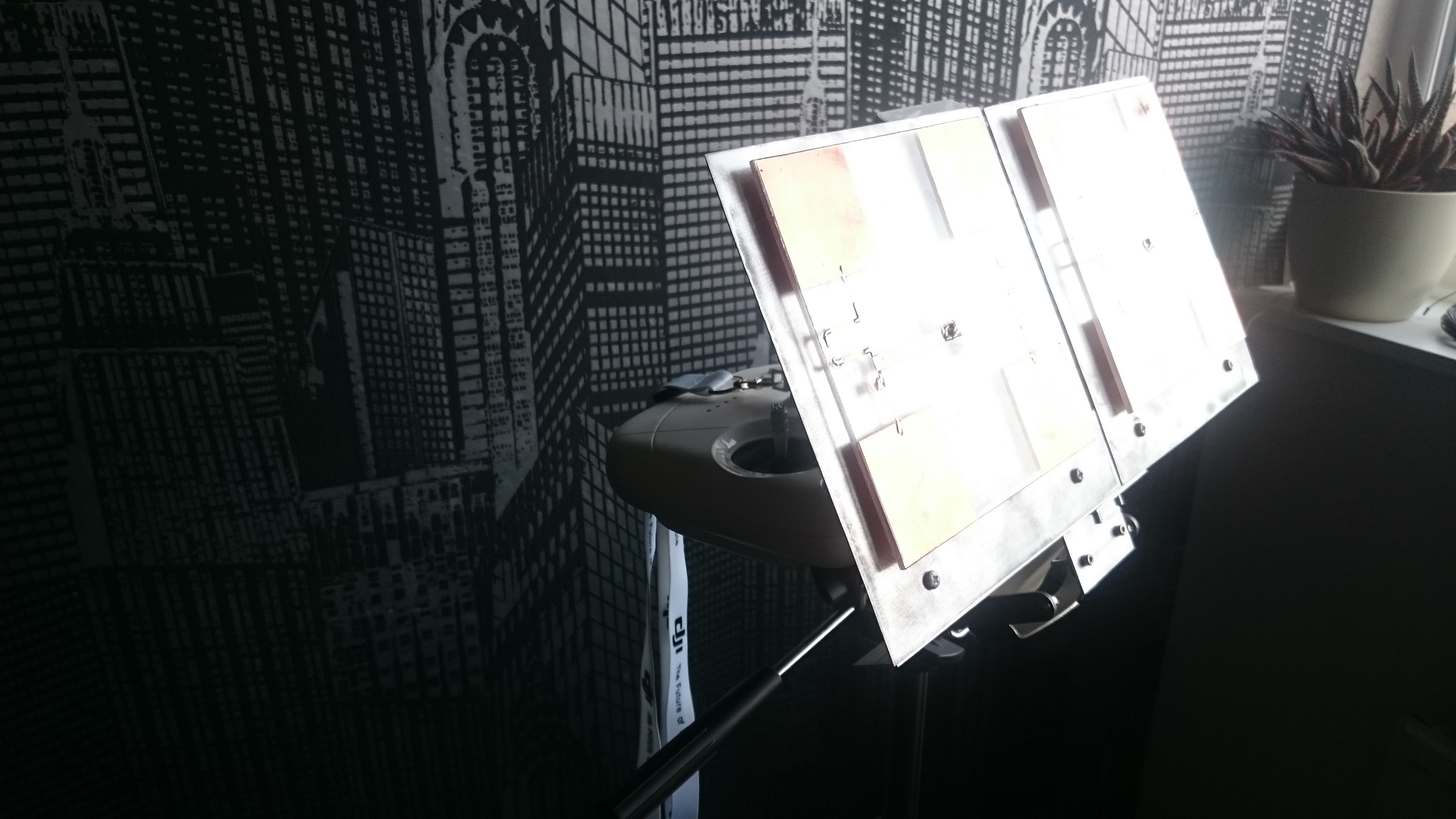

And catching some rays
One problem I need to order some cables mine are not long enough so we'll have to wait for results.

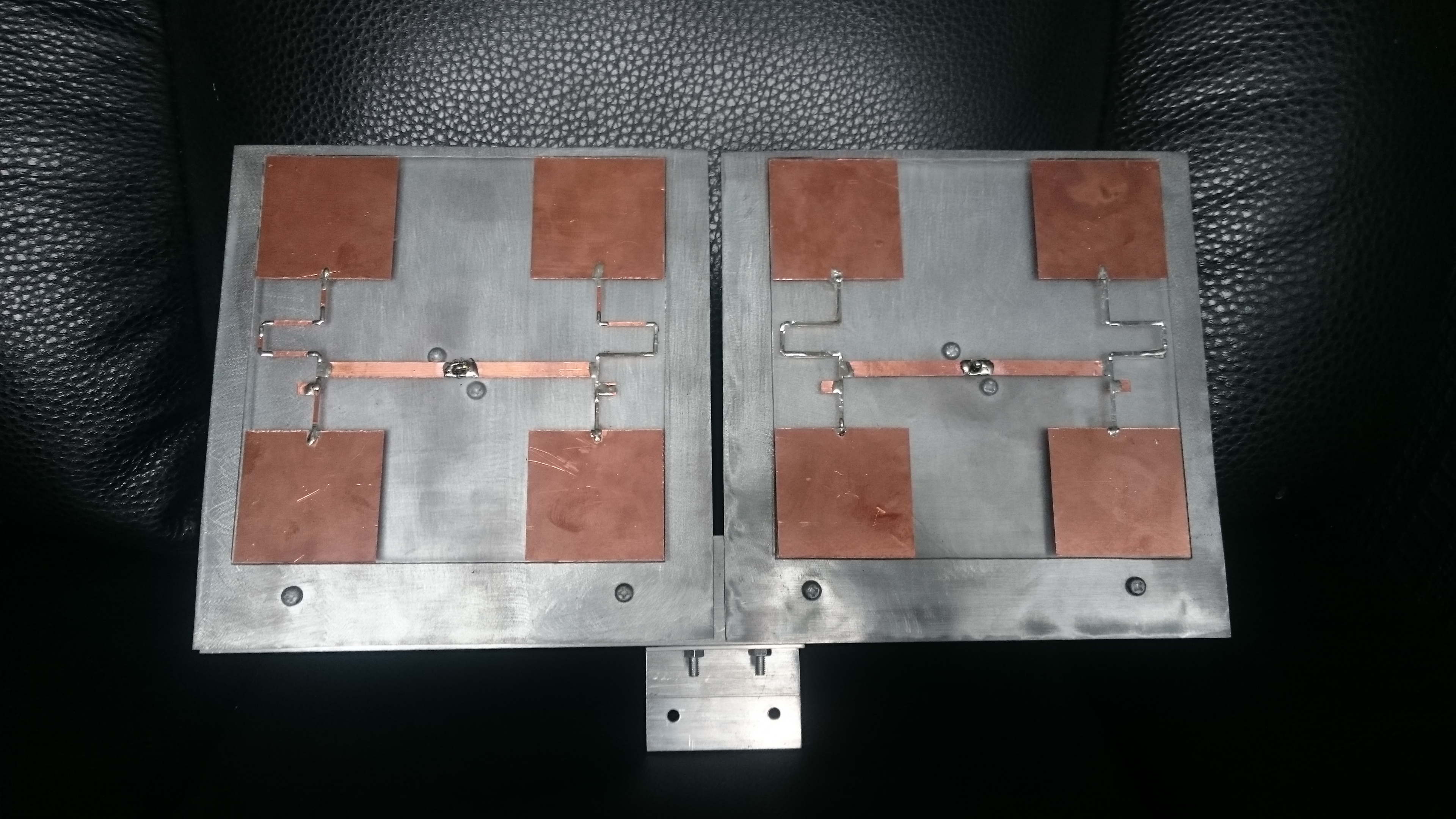

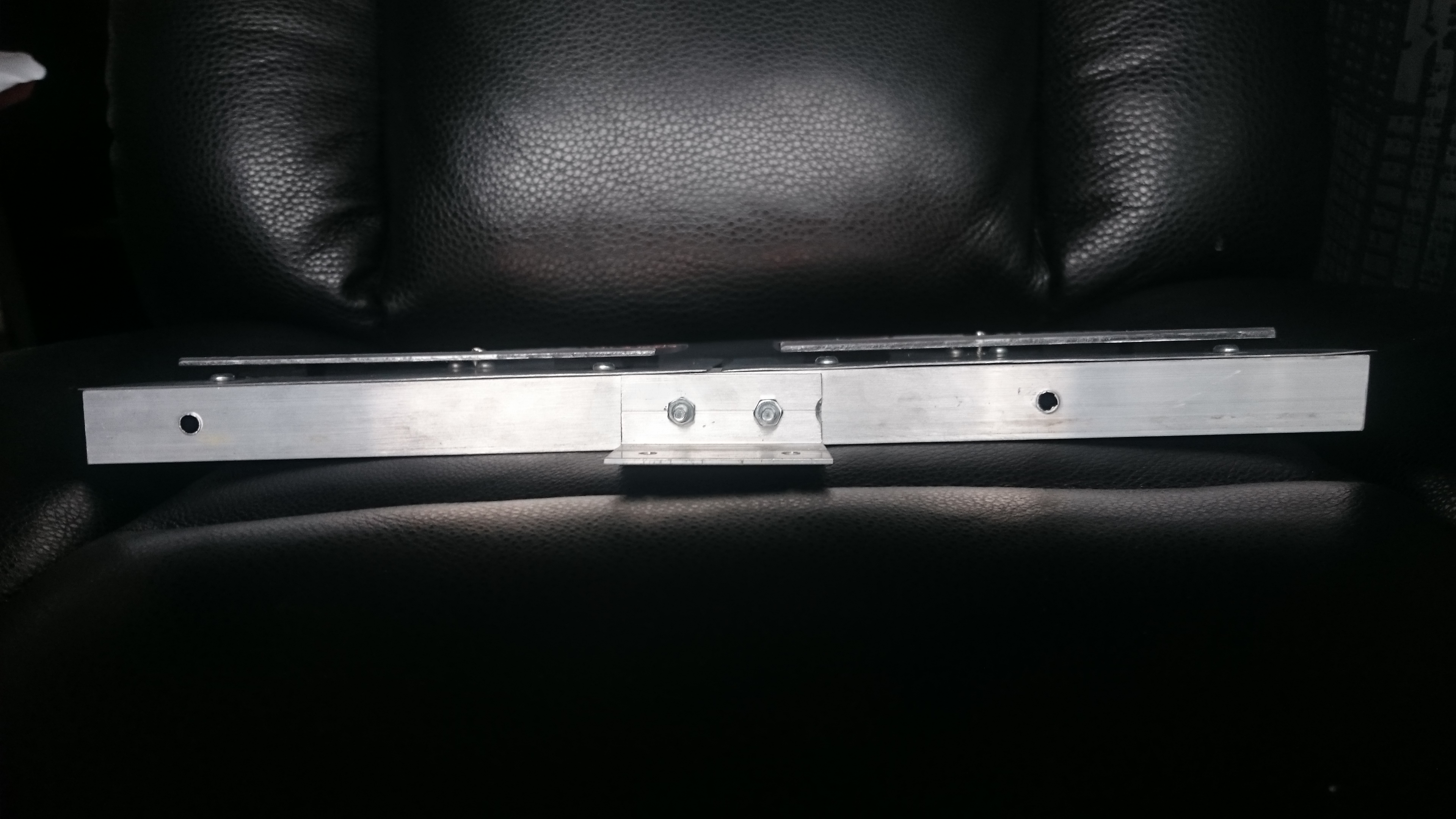

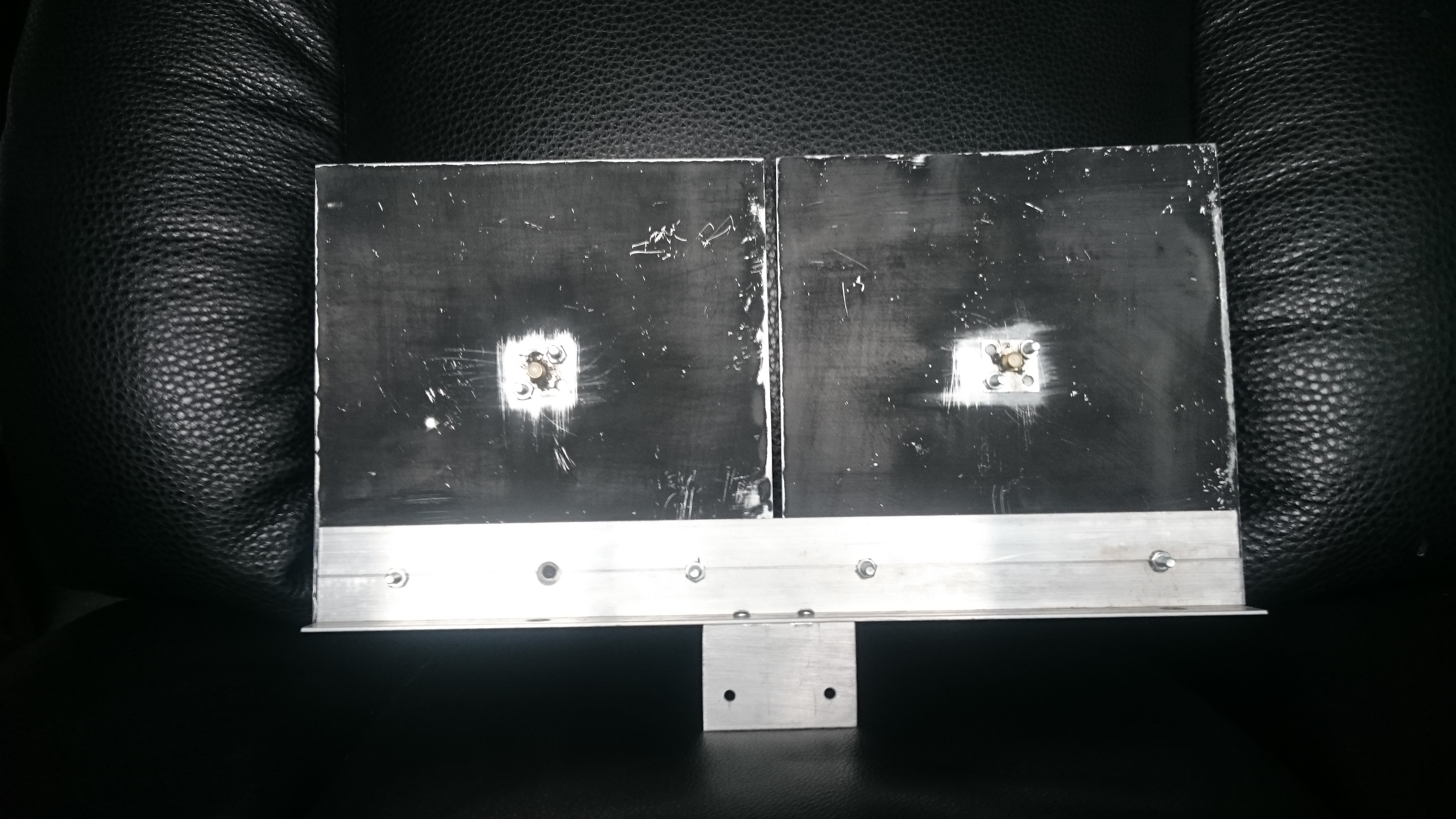

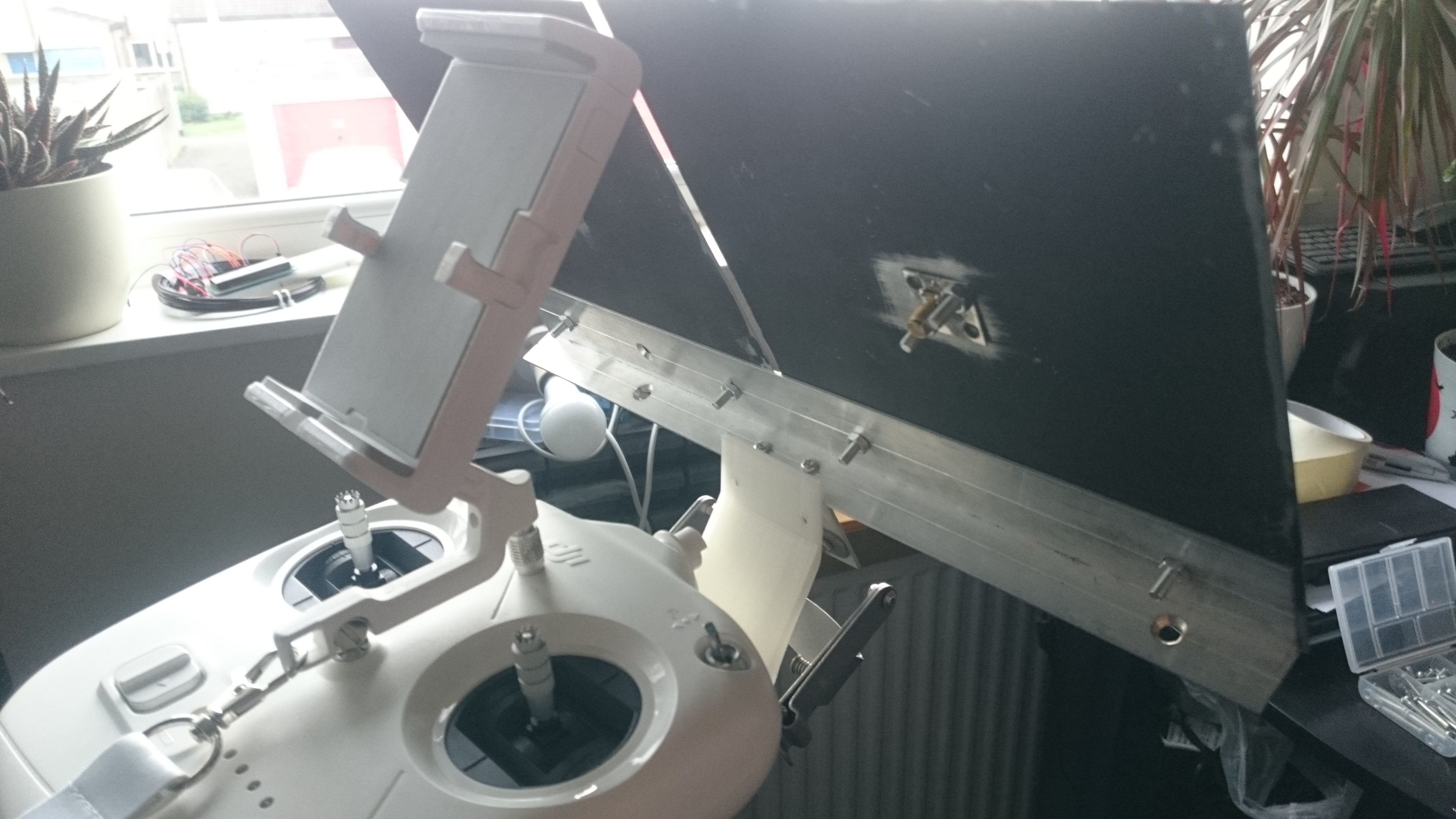

OK so here's the prototype, don't laugh now this one mean *** piece of kit ;)
View attachment 54705 View attachment 54707 View attachment 54708
So this was made with all stuff I had at home already the only thing I had to buy was the sma connectors which I got 5 for about £4.
Warning!! there was an old freest box harmed in the making, but I managed to salvage a 500gb hard drive so it's all good:cool:
And I thought I had allot of stuff around my place. And you can store your video on the 500g HD.;)
