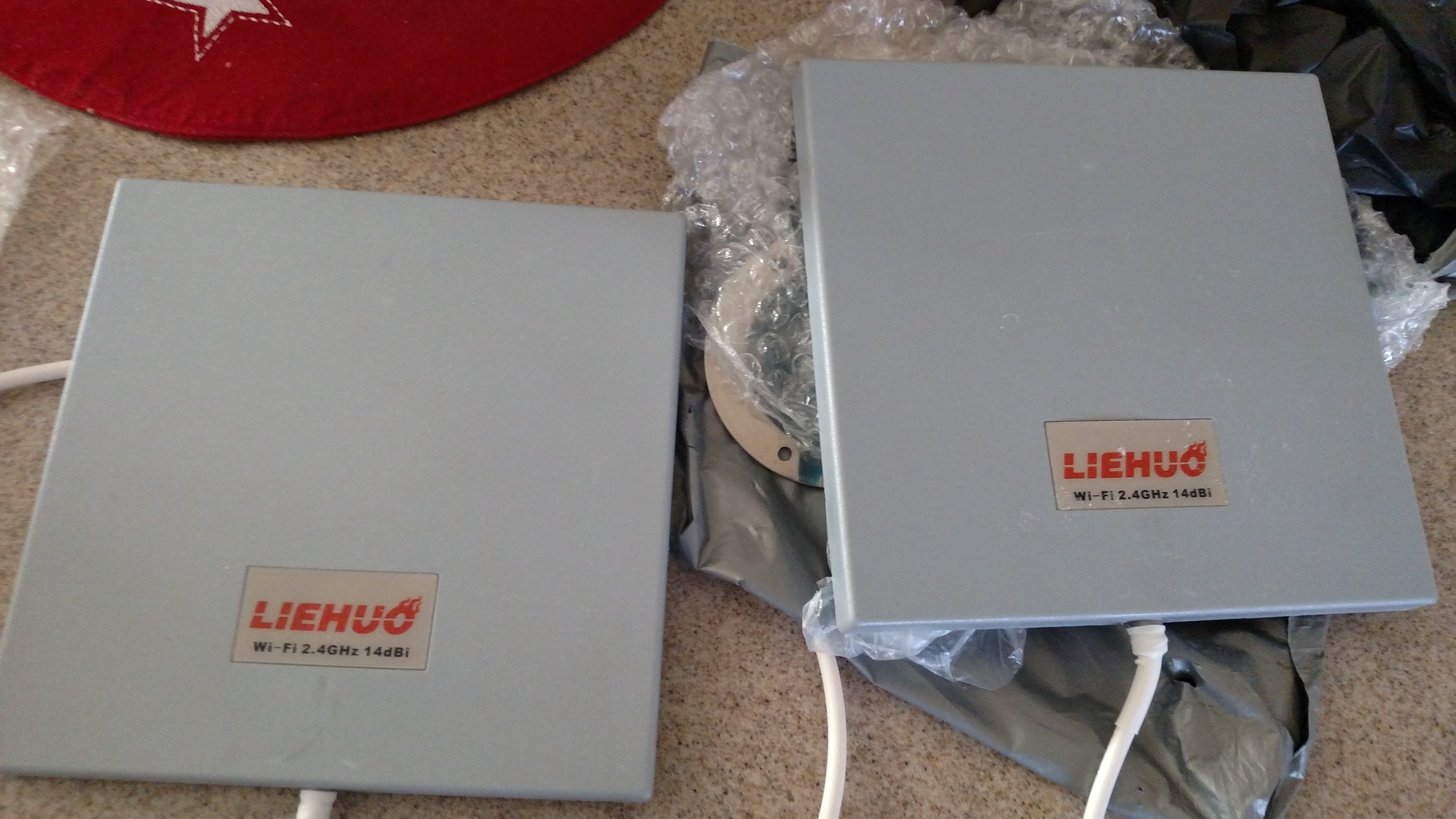

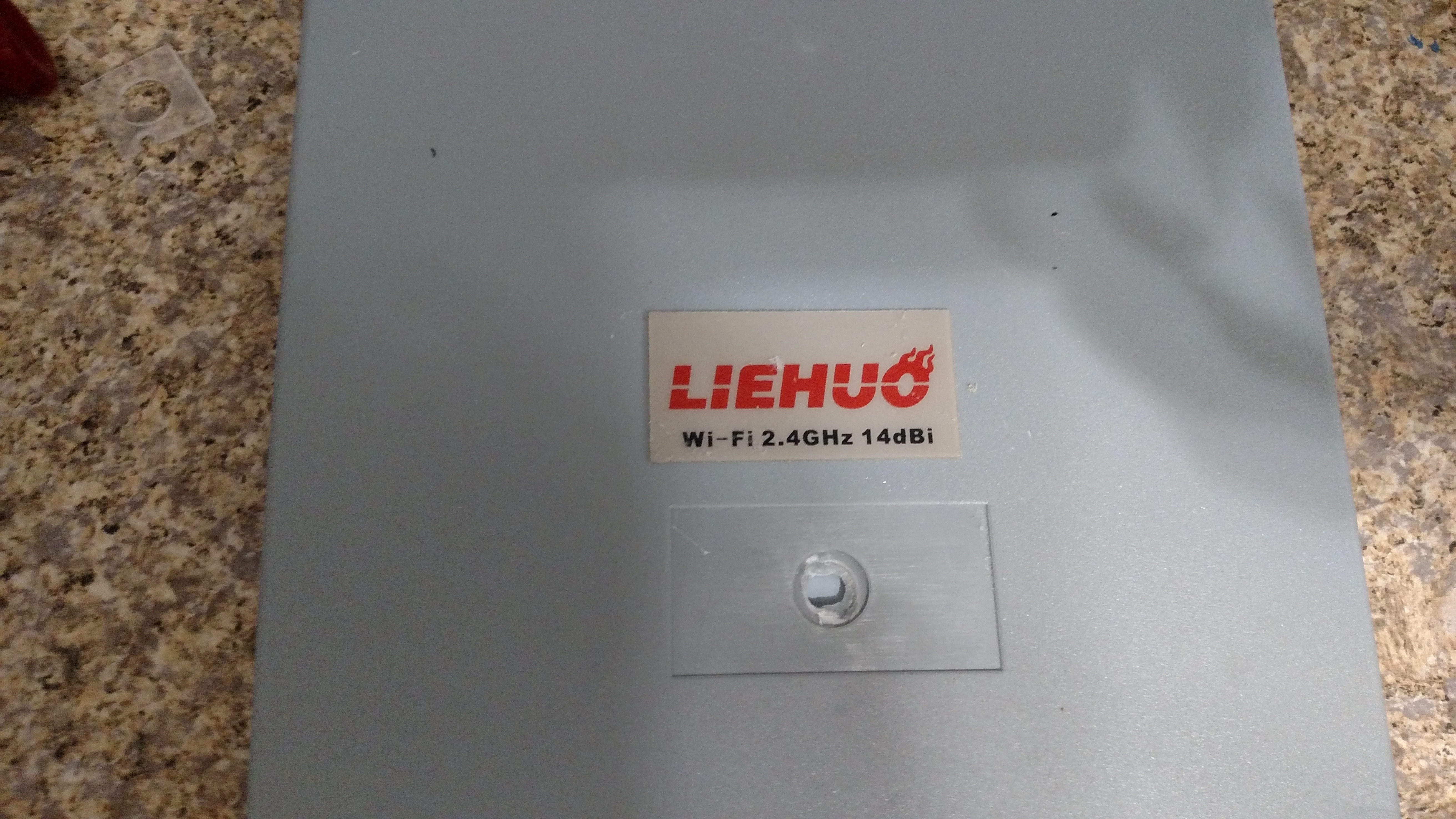

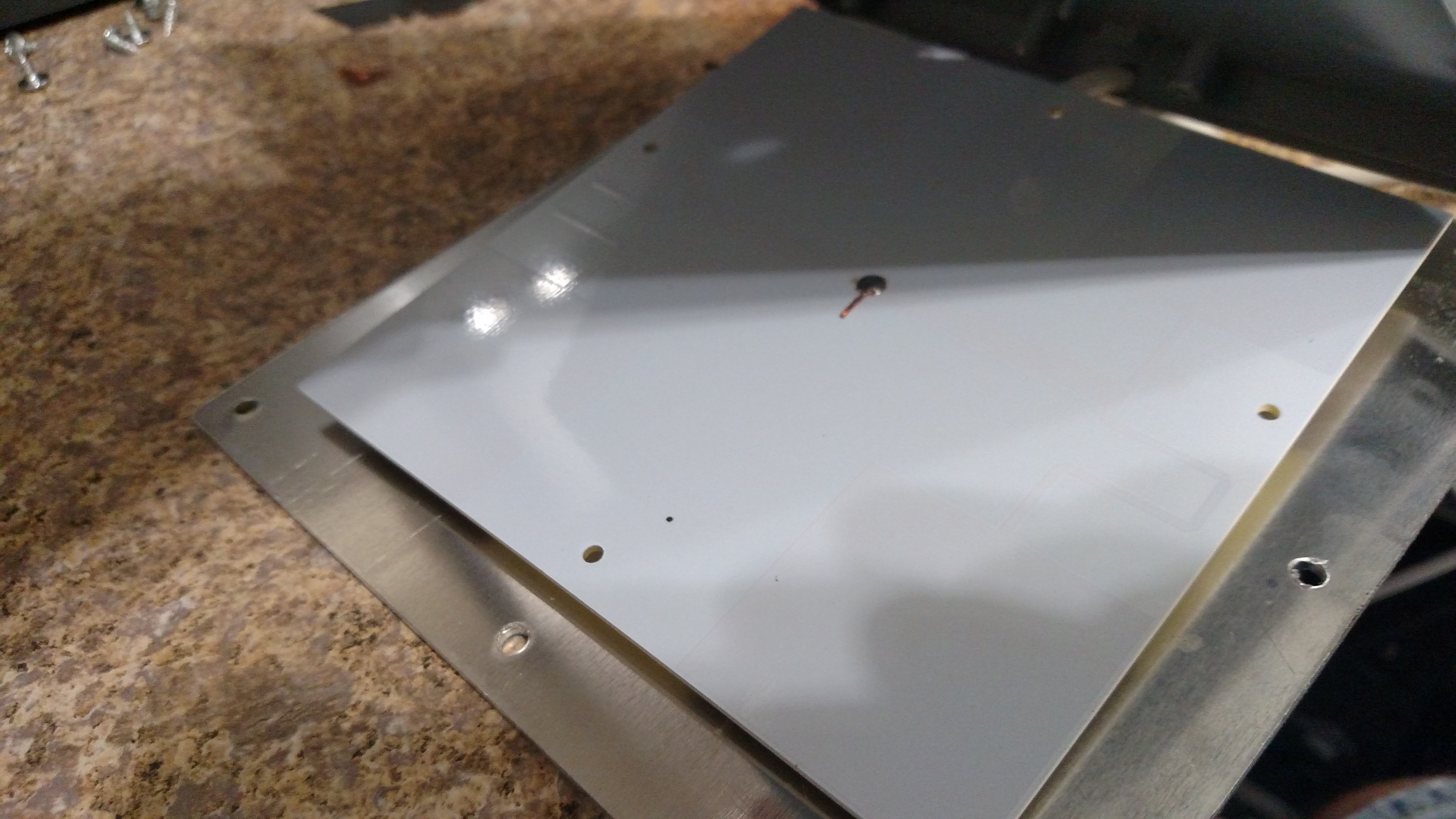

Ok all I got my Chinese knock off ( or are they). You be the judge. The boxing was not the greatest.
So after looking at Db's I'll get some more foam tape and I'll be set. I'll have to measure the foam. It looks as if it is sandwiched between the back panel and front panel. It probably wont be till Monday before I can get it out and see how it does. I'll be first trying it out on my P2v+. I'll rename them Desert Storm oh Sht*t somebody is already using that.

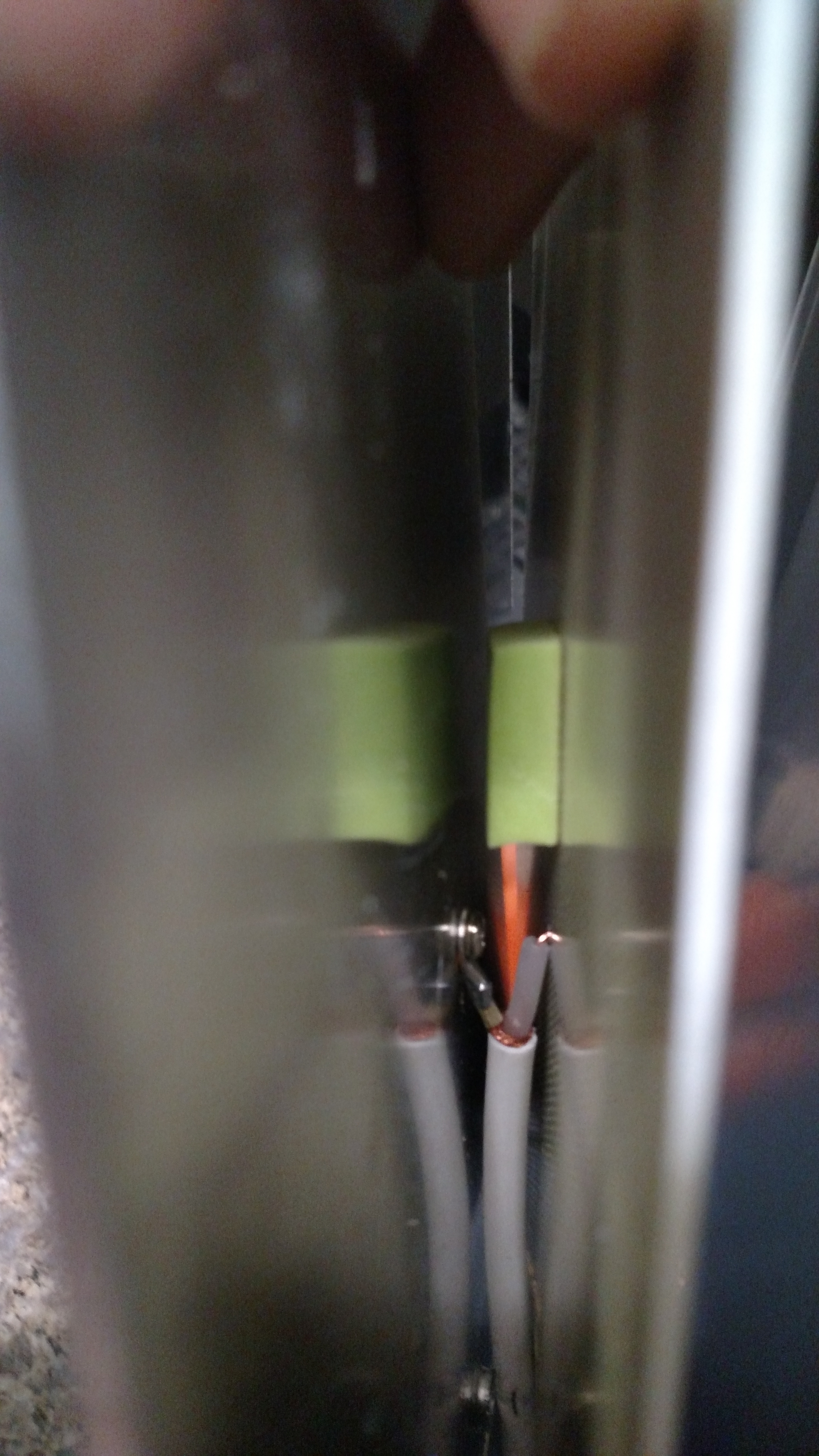

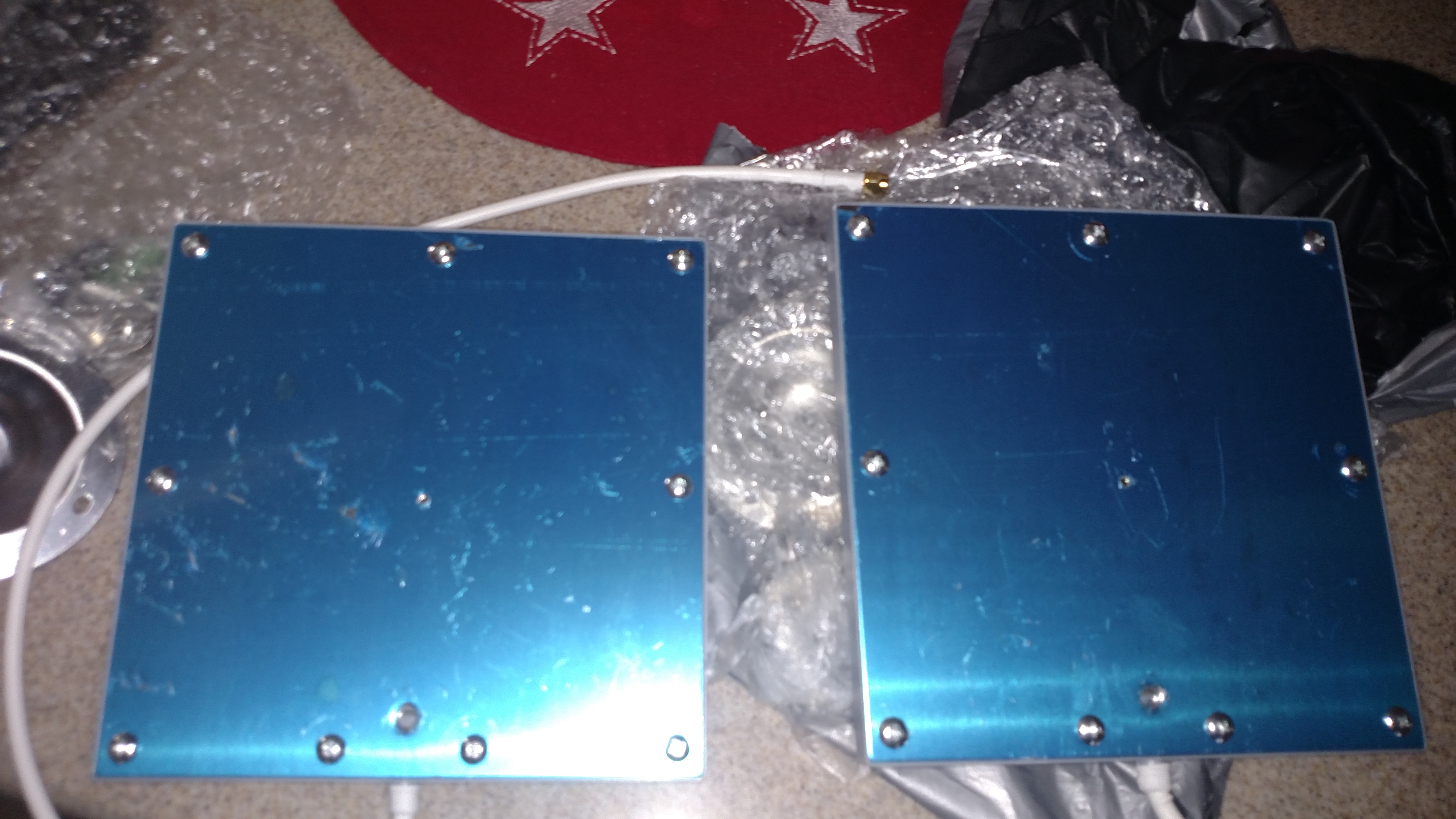

Ok after talking to a few other members that know more then I. This is what you need to check and fix with the Chinese antennas.
1. replace the foam for the spacing between the pcb board & back plate. You will see 4 off sets that the pcb board rests on. These 4 poles keep the pcb in line with the back plate all so will give it correct spacing with the foam. The foam that comes with it is 1" x 1" x 1/4" It may work. I did like what Db's shown in his Terminator pictures,two long strips running top to bottom. I'm told the sweet spot for 2.4 ghz is around 3/16" . I measured the stand off poles to the back plate and got 1/4" subtract 1/16 for the thickens of the pcb and you get 3/16".
2. replace the ground screw. I found both of mine to be loose. to try and tighten it down did not do anything. So you have a few options, get a longer bolt and put a nut on the back then tighten it down. or replace the whole connection. Just remember the back plate is made of stainless steel can't solder to it. ( or a lease I could not).
3. this somewhat going with number 2 because you can't get to the set screw with out unsoldering the pcb board,I found that one of my pcb board solder was bad. If you do replace the set screw you will have to re-solder, If you don't just hit the solder on the pcb board.
I hope this helps anyone that may buy one and if you find something else please leave a message.
Enjoy
Phxbird57

Thanks man. All that sounds good. I think the spacing should be 15mm. Not sure though.

The spacing changes the size of the patches and vice versa there is a formula which if you search online you will find. Whether you can understand it is another but there are calculators that help with that.
I would say 3mm to 6mm sounds about right.
I'm guessing nobody has the measurements of the space for the liehuo antenna or terminator as I'm very nearly done with my diy but would like to check as it doesn't seem exact by the formula with the size patches.
Pics coming very soon :):):cool:
I did measure the Chinese ones and they have it setup at 3/16 in.
