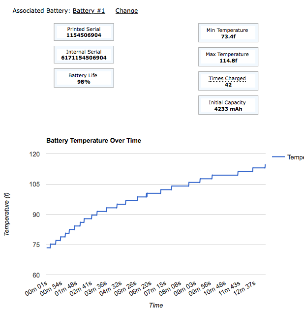

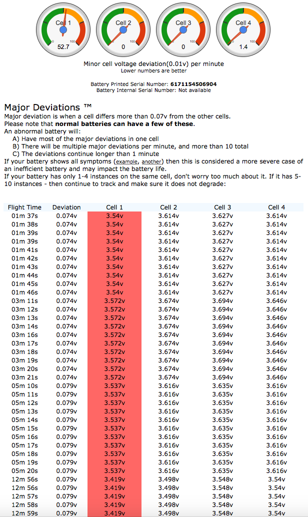

Okay, flew again today with Battery #1 at 88% charge.
More voltage deviations in cell #1 over several intermittent minutes but lower deviations (0.074v to 0.079v).
The good part was the flight continued for 13 minutes.
No AutoLanding.
Why 88% at launch? Didn’t have time for a full charge?
Yuur wasting your time to the extent your intent might.be to get a true indication if the battery health.
Let it go through a full charge cycle and see where things go then.
Reactions: Oso and kyrvas
You're right; a full charge would be good for battery health evaluation.
I fully charged it, then went through GO and Litchi checking settings then flew at 88% because of impending weather; it was 34ºF | 1ºC when I flew.
Today is blue skies so I'll give it another try at 100% battery.
Thanks for the input.

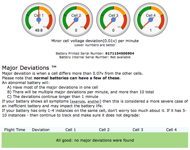

Yes, indeed, I did just that and the result was a fully balanced battery in each cell. Here are yesterday's results before and after flight:
View attachment 109511View attachment 109512

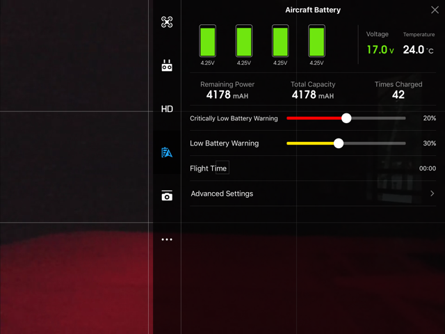

Why you might need to set your critical battery warning above the lowest available threshold is a mystery in itself however it is a big clue as to why the phantom wants to autiland earlier than expected.
