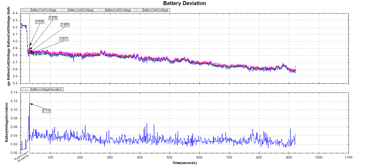

Has anybody seen cell voltages go up during flight? I have two batteries that show one LED turned off when testing the health of the battery. Out of curiosity, I analyzed the cell voltages after a flight and found that cell 4 went from 3.878V to 3.936V and created a cell deviation of 0.115V. I did see times where cells increased in voltage, but the deviation was consistent with previous samples. This alarmed me because Phantom Help Log Viewer output displayed it in red.

Small fluctuations are normal. They can exceed a max deviancy at times. When those are lengthy intervals or remain at those levels, then you may have an issue. Place a link here to your uploaded file on the log viewer and it can be plotted for better visual.
This deviation occurred at 30.2 seconds in to the flight, lasted less than 1 second and never re-appeared. Had this been constant, you may have an issue. In this instance I don't think you have an issue at all. Here are the plots.
