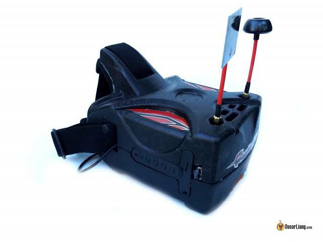

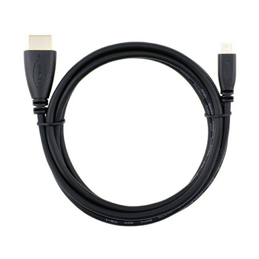

Hi good day pilots! [emoji1944] I'm really on a tight budget here and would like to know if this low cost setup would be even probable? Hope you guys could give inputs and assistance. Thank you so much!
* I want FPV goggles video output besides my phone for my Phantom 4 standard.
* I don't have the HDMI output module for the remote
* I'm a low cost drone enthusiast [emoji28], and have low budget for now. [emoji22]
* I want to use DJI go app only not Litchi.
My idea is this:
> Buy micro USB ---> HDMI cable. (I'm not sure if the micro USB has video out capability [emoji848])
> Plug that to micro USB port in transmitter
> Use Eachine goggles 2 (has HDMI video input).
Can this setup work for low cost FPV goggles view? Hehe.
Here are the cable & goggles I am eyeing to purchase:
thank you guys! Hope you could help me. [emoji120]

thank you guys! Hope you could help me. [emoji120]View attachment 115673View attachment 115674
