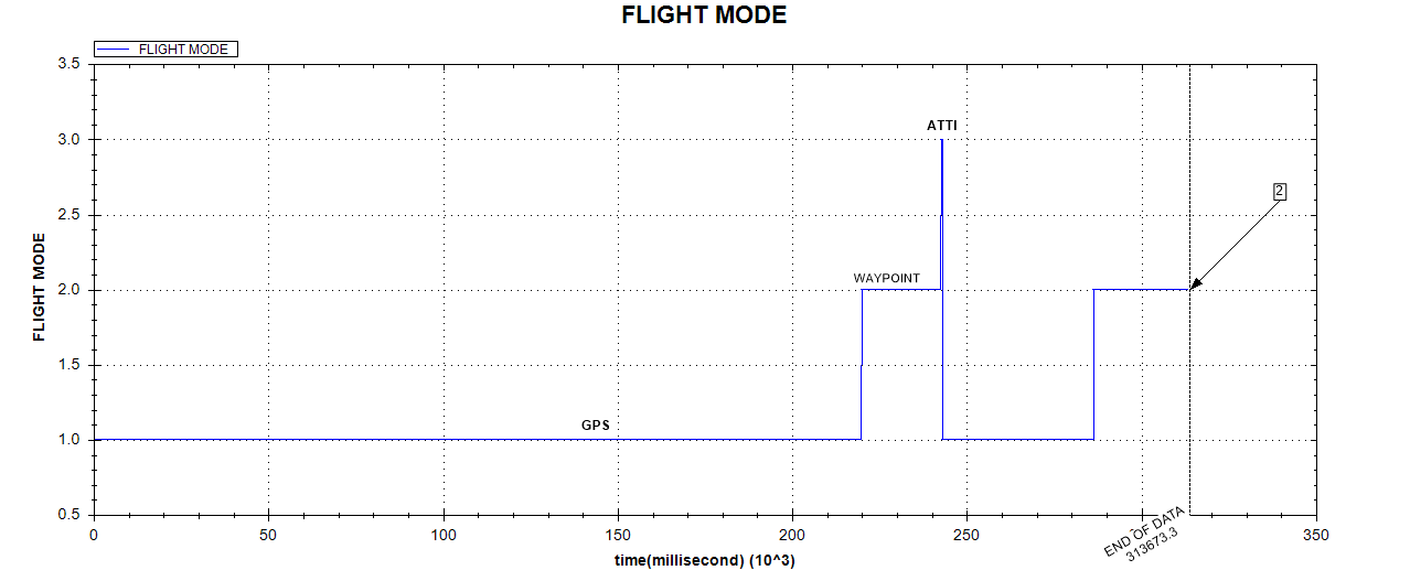

Just thought I'd throw this out there. Here are the mode switches. The last one only 10 seconds before signal loss.
So based on this, does it appear the craft was back on the waypoint mission and would have completed the mission? A question that I have is, with no other input at the end of a mission (if not RTH) will the craft just hover until battery dies?

Flicking into atti mode cancels the waypoint mission (if you have signal) and the Phantom will wait for you to give it some control input, either by using the joysticks or initiating RTH.
If you have lost signal, the controller has no effect and the mission continues.
It will Auto Land at battery critically low point in order to try and preserve the aircraft and avoid a power-OFF landing (not a landing at all).
If you look at the last graph at the bottom, it was indeed back on the Waypoint mission. But as was said before, there is nothing in this data that indicates any kind of mishap other than loss of signal. Assuming the mission proceeded, as it should have, it could be anyplace along the flightpath, unless the altitude was too low ( and that is suspect) and it clipped the trees, which can be quite tall in that area. I have no idea why the OP had the flight speed at maximum throughout the mission profile ( 30mph +)
